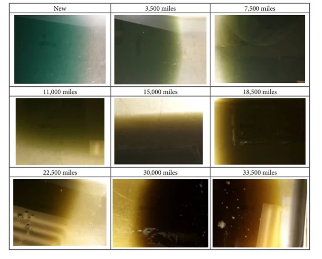

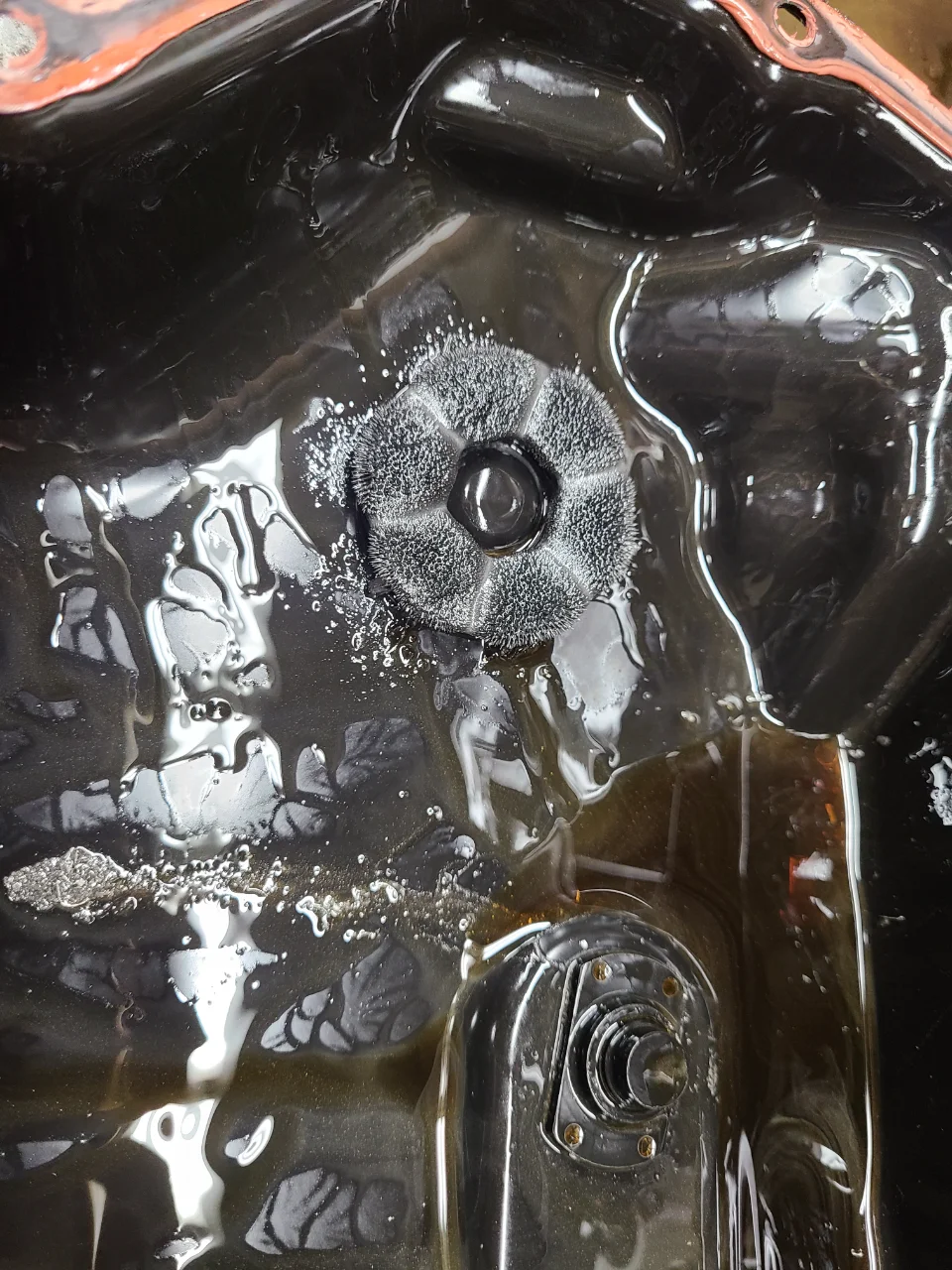

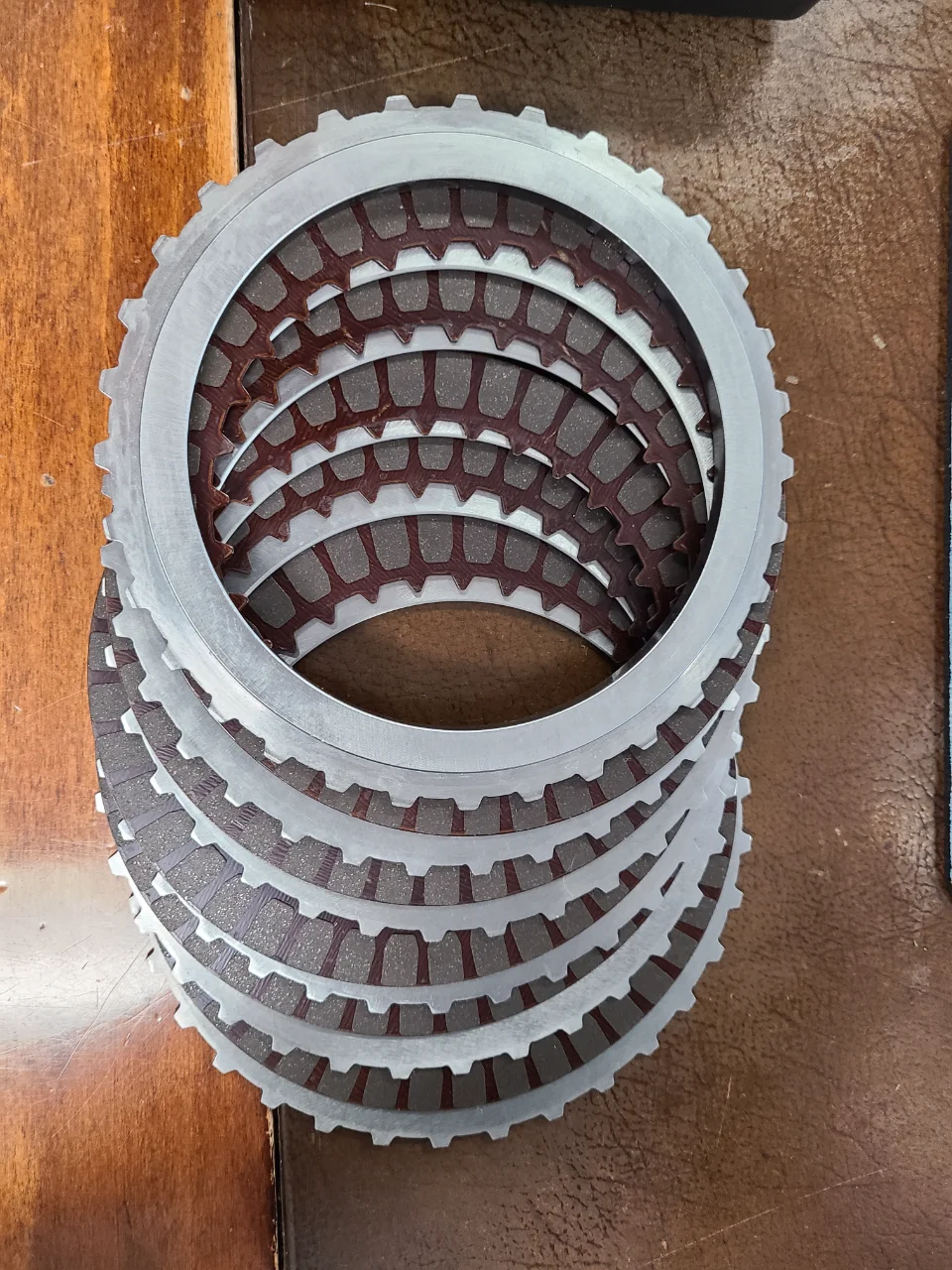

The "sludge" in the bottom of the pan is normal. Most of the clutch material in the units is a dark grey/black material that has a high metal content in the disks. Its a mixture of resins, aluminum oxides, and ferrous material. The sludge is just normal clutch shed that units have and is not a concerning issue. When you want to be concerned about wear in a Skyactiv is the first picture linked. 2nd pic is some of the friction material, all the lighter flecks are some of the metal content in the friction. FZ will always look dark after its run for some time, 3rd is a pic of how the color changes based on mileage.
