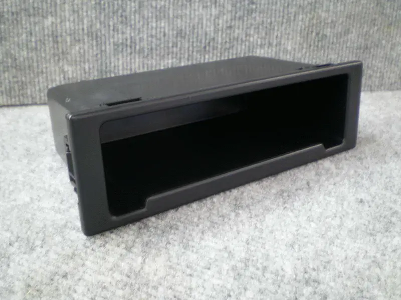

for a less expensive dash pocket alternative to the covered MSP pocket, check out mazda P/N B02A-66-9M0A which is the mazda pocket without a cover. (I have this one in my car) or, there is mazda P/N B03A-66-9M0 which is just a blank plate. add either of these to the MSP support bar, and you get a nice factory looking installation.

njaremka - do you have any pics of the two part numbers you provided? The pocket is $11.15 on onlinemazdaparts.com, but with shipping, it'll take it closer to $20. I wanna see if it's worth the money to get that over the Scosche pocket that Crutchfield offers. So is it still possible to install the factory radio back in if you were to install one that does not fit and requires unbolting/cutting? If so, I'm not really worried about getting one that doesn't fit :)

the kit that crutchfield sells will look aftermarket. if you go with the MSP support bar and one of the pockets, it will look MUCH better. unfortunately, i dont have any good pictures of my installation with me - unless i run out to the car right now....
and the blanking plate looks the same, but is flat all the way accross. (i can't find any pictures of it)

Thanks for the pics. I think I'll pass on the blank plate since I'll want to use the pocket to store my wallet and cell phone or other little odds and ends. Looks like the Mazda pocket is taller than the Scosche one, too. Is there anything special that's needed to install the pocket?
I guess now the only question is if I go back to stock, will the OEM radio fit if I get a "non-fitting" aftermarket one?
the only thing needed is the msp / mp3 radio support bar - P/N TA06-66-9B1
