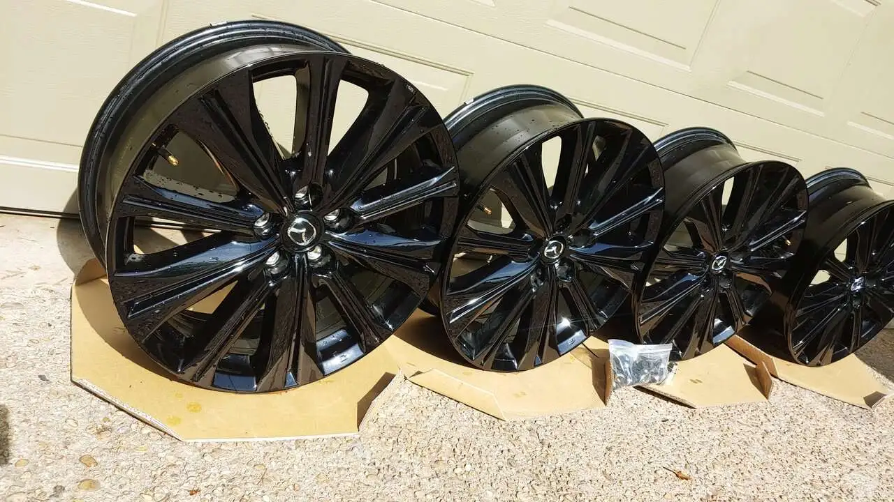

I listed a set of 19" CX 5 wheels with less than 2500 miles on them. Look in the FS section.
