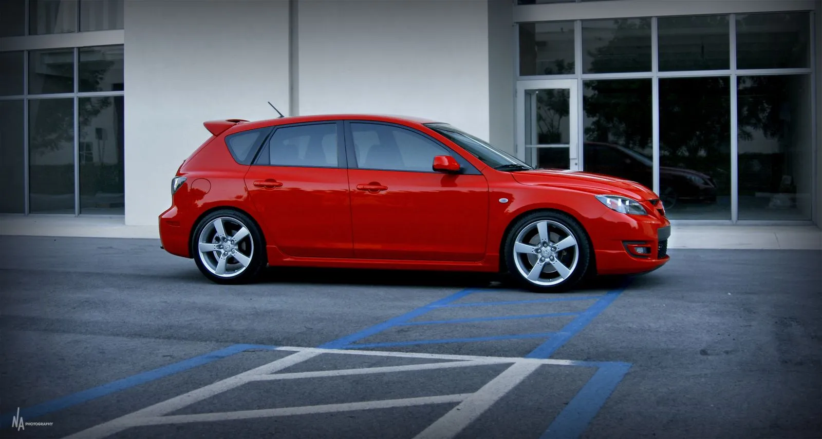

no. Im running the wider OEM Rx8 potenzas (225/45/18) and am dropped 2" and I never rub.
Should fit and look fine. I've read that if you put different TPMS sensors in, you have to pay a visit to the dealer and they have to enter the new numbers from the sensors into the computer. I have my doubts, but no contradicting information. I would think all you'll need is the fifteen minutes of waiting during the process, but I have no first-hand knowledge.
225s are the best fit for these wheels...less rim exposed for those days when you get a little too close to that curb. If you have the cash to throw at it, get the whole package and upgrade your tires while you're at it.
