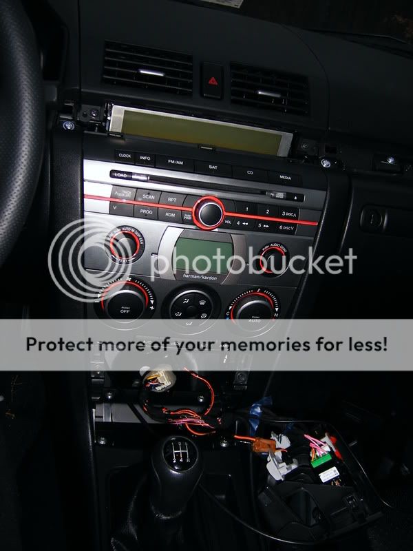

You can always check out the harman kardon drive and play. It's a separate screen and controller so no steering wheel controls, but you can place the screen and controller wherever is convenient for you and it can still be right at your fingertips. Also the screen/controls are the same as the ipod's screen so it's super intuitive. Last of all you can run the audio through the ACI (console input) for good sound. Several members have gotten super involved, disassembled the screen and mounted it in the lower part of the HU where it says "multi function audio system" so it's very slick.
Well, the only extra screen i'm really interested in having on my car is either a Dashhawk or an OEM Navi setup.
That'd be a really convenient place to install anything (multi function area) because it's just empty right?
Agreed, I'm not a big fan of extra stuff in the car, however how can you say this doesn't look good?
Especially if you replace the LEDs so that the normally white screen is red.
http://i184.photobucket.com/albums/x88/ApatheticFrimbo/drive and play/IMG_0079.jpg (I had it as an inserted image but it kept making it insanely huge..... oh and the pink is the camera, he says it's more red than the stock display in person)
And yes the area behind that is empty.
