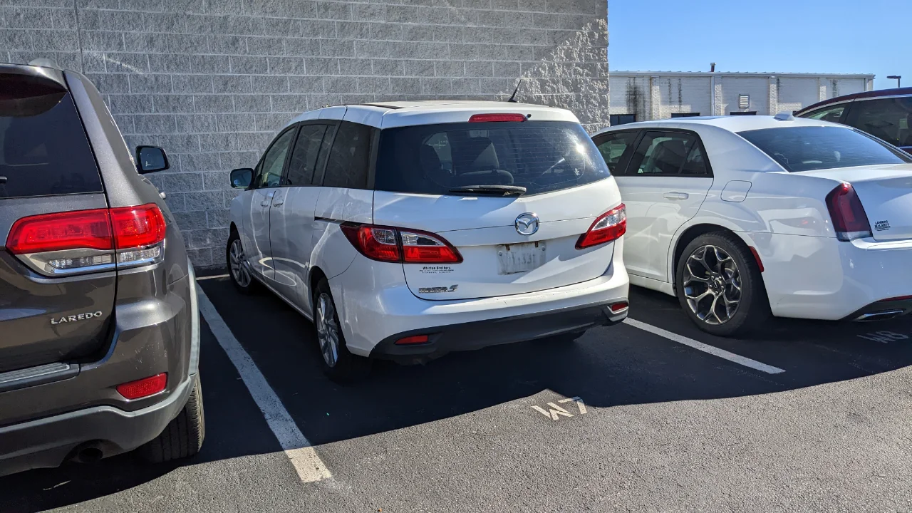

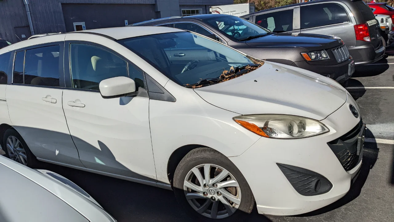

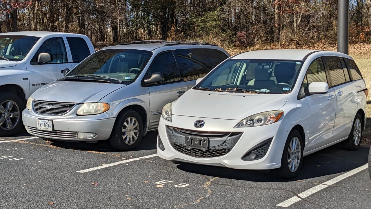

This build series takes off with the purchase of a well used 2012 Mazda5 in Oct. 2022 - 130k Miles on the clock, Owned by an older couple who brought it in for some Transmission Shifting Concerns. At the time, I was the technician who was servicing the vehicle and I had found the vehicle to be in fairly great condition. All it needed was a CV Axle and a TCM, which as we all know here in the forum is a VERY common problem. At the time, the TCMs were becoming very scarce and hard to get as they were going in and out of backorder. We were able to order one from a dealer in Texas for the customer, in case they wanted to perform the repairs.
Fast forward a couple of days and I was told that the customer was just going to trade their 5 in on a newer car and they were going to send the car to wholesale. Normally, the GM of the dealer doesn't allow employees to purchase vehicles due to the fact that we could easily fix and flip the car. In my case, I was actually in need of a vehicle and they made the exception for me. I was able to purchase the vehicle through the dealer at a fairly reasonable price of $2200 after Taxes, Fees, Registration...etc. Now, I'm a fairly big fan of quirky vehicles, but I never thought that in my 28 years of life that I would be a single man driving a minivan.
I purchased the TCM from the parts department that we had ordered for the vehicle, installed it, and have been daily driving it ever since. It's only had 2 issues since my ownership, not including the CV Axle. The Water Outlet failing and the Intake Actuator Vacuum Solenoids Failing. It's been a great workhorse, daily driver, and overall fun little car to drive.

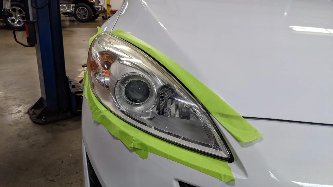

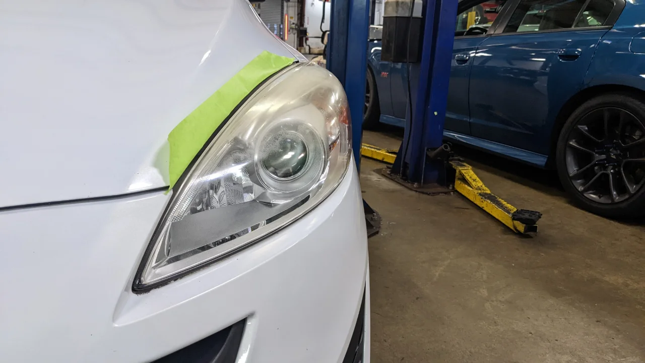

The first month of ownership, I decided to tackle the oxidized headlights, and take care of some small scratches on the hood, and perform a thorough detail to clean out the previous owner's FUNK from their 10 Years of ownership, as I'm the second owner.
Nothing too crazy here, I wasn't even really thinking about doing anything drastic to this little van at the time, as I already have MULTIPLE projects that I'm undertaking at once, which as we all know isn't great for the wallet. 😅
The Headlight Restoration wasn't anything too fancy, as I just wanted to get the van looking clean. So I just did a quick cut and buff, and performed the same for the hood, as it had the most damage. The rest of the body panels had some slight dings, but no major scratches, but definitely some spots that were touched up.
It had 130k Miles on it, definitely didn't expect perfection, especially since I live down a dirt and gravel road and I'm going to inevitably scratch it up.

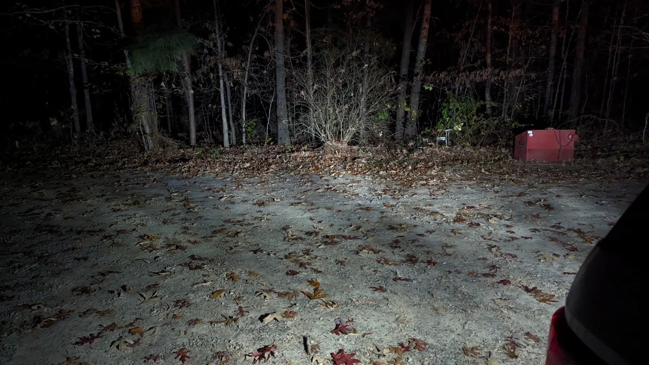

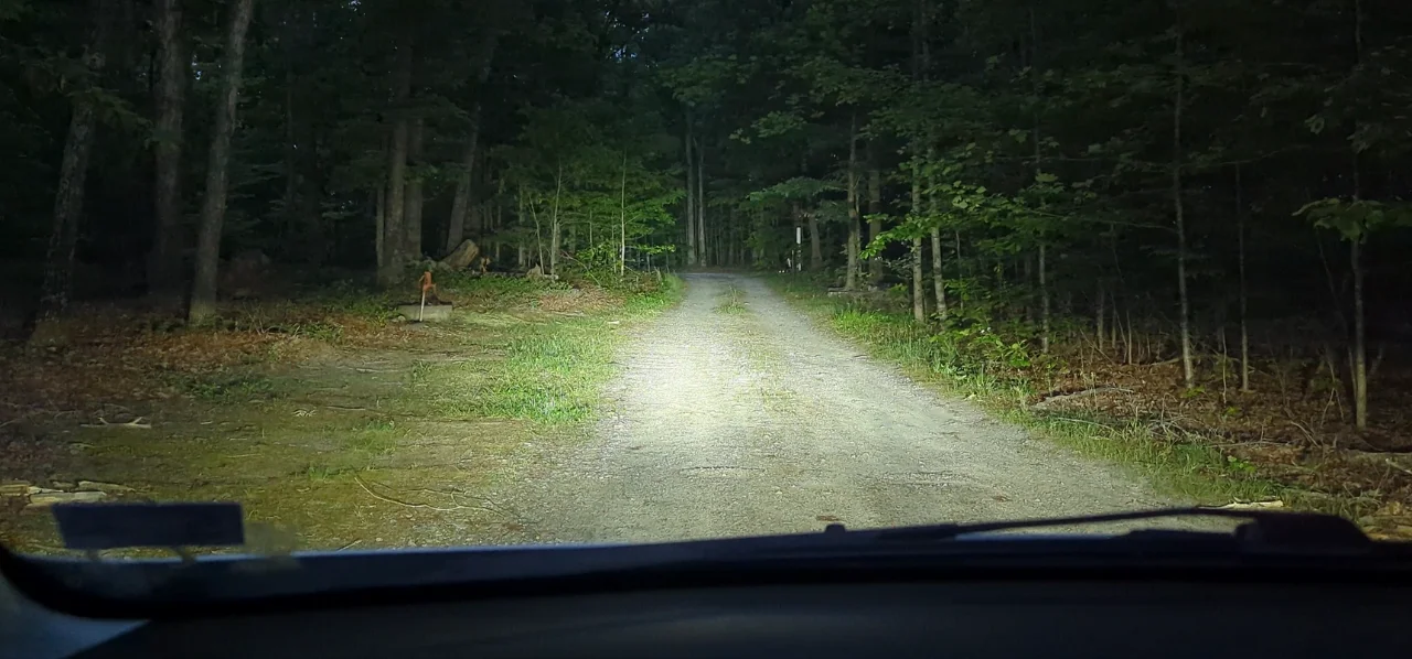

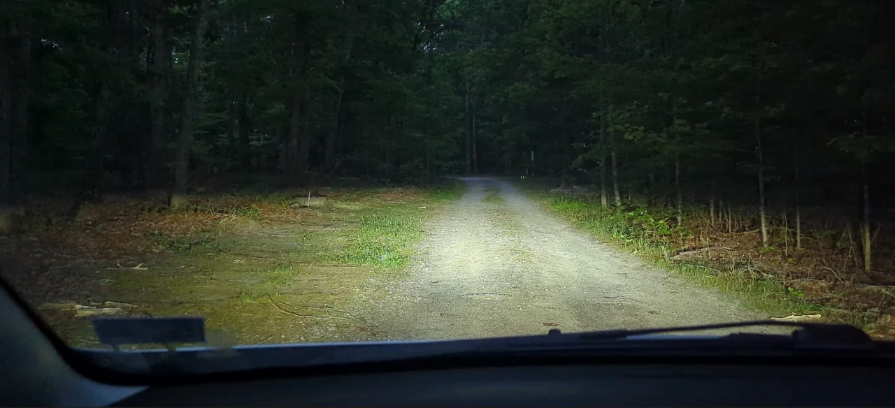

Low Beam/High Beam: Amazon Specials - Fahren Termitor 2023 model Kit H11/9005
Currently $60 on sale on Amazon. I particularly liked these after watching a review of them on YouTube and I especially liked them since the module was built inside the bulb as opposed to having a module that stuck out with a long tail. They provided a very nice, bright white color, even though they're advertised as 6500k.
They have a very nice beam pattern and amount of light to them, at the time I paid $100 for them. If these are to blow out, I will upgrade to Morimoto Bulbs.

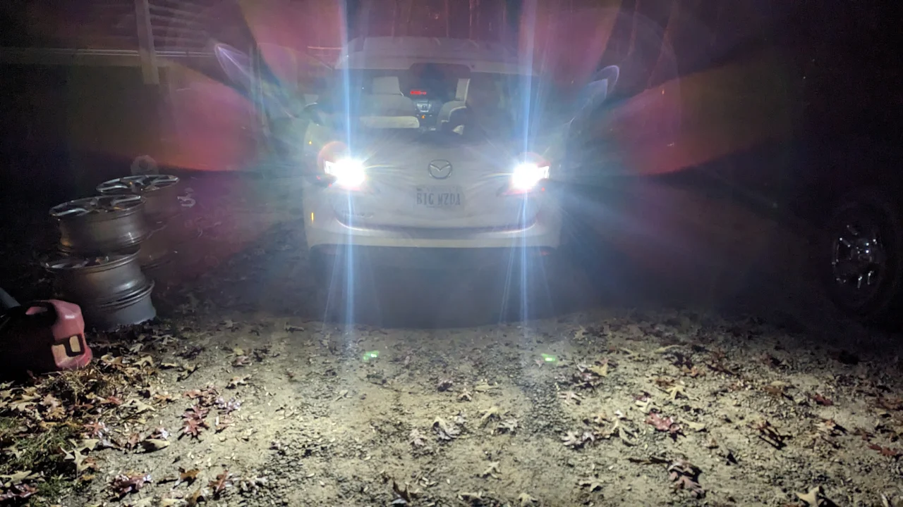

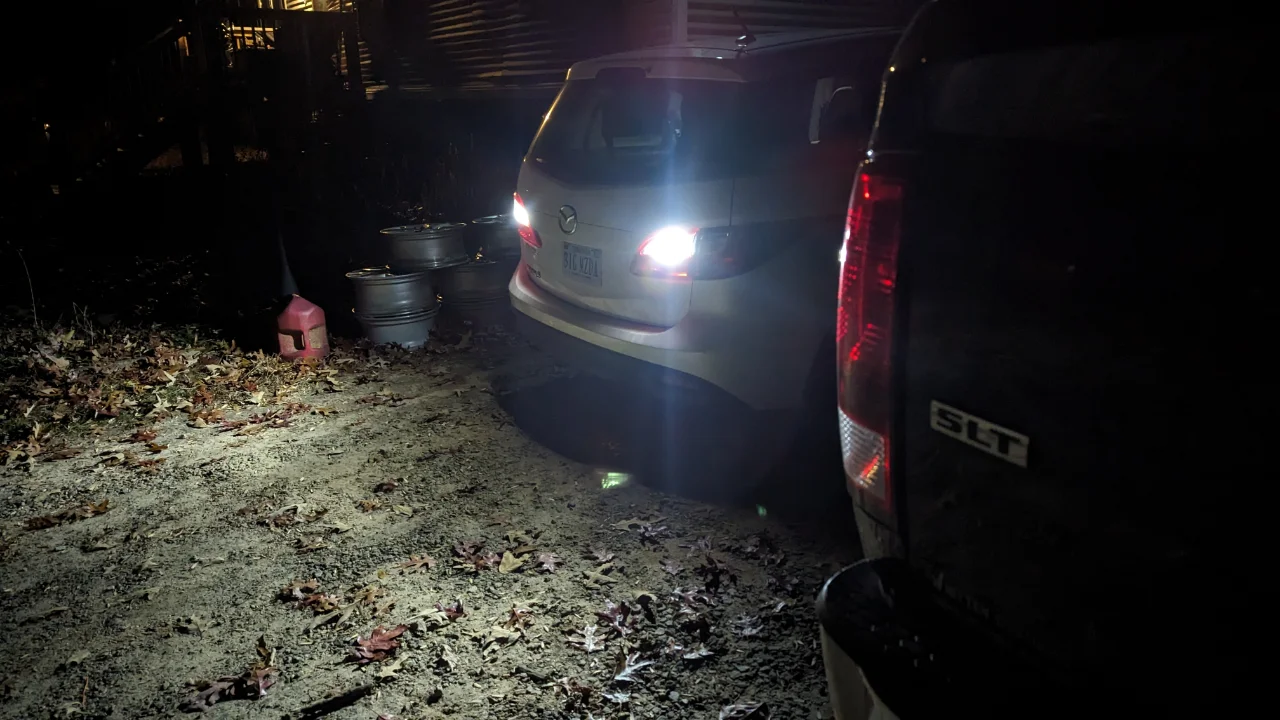

Reverse: Auxbeam B2 Series 7440 Bulbs
This is where things kinda get ignorant. I hated the factory Reverse Lamps, so I took advantage of some Black Friday Deals and went and gave AuxBeam a try for some of their products. I went and gave their B2 Series 7440 Bulbs a try and GOOD GOD, you basically have a portable sun as your reverse lamps.
Now, I will say, the mounting of these bulbs isn't the normal "Twist and Lock" type, as it's a more universal fit and uses a Silicone Seal/Gasket that you just push into the housing. Mine were a tight fit and I could rotate the light to adjust the beam pattern to my liking.
These things are SOLID and are basically a low beam bulb that you're shooting backwards, it's kinda ignorant, but at least I can see now.

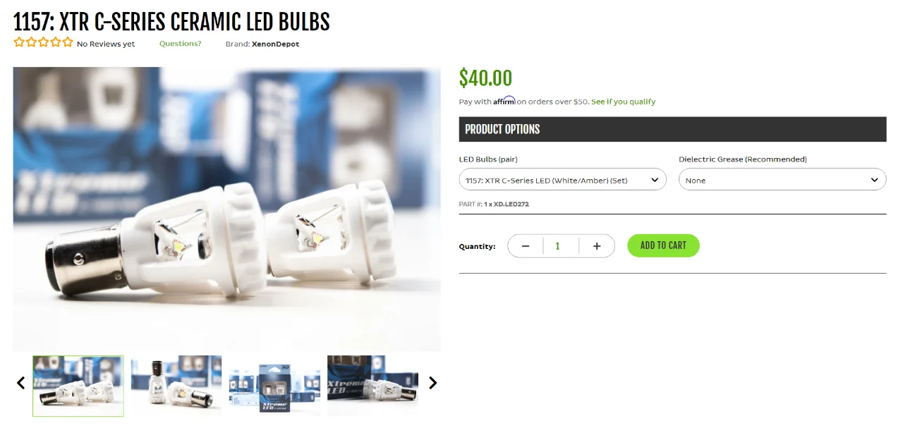

Turn Singals: XenonDepot XTR-C 1157 Switchback Bulbs
Again, taking advantage of Black Friday, TheRetrofitSource was having a "Free Bulb Giveaway" if you paid $5 for shipping. I took the gamble on some Switchback Amber/White Led Turn Signals from XenonDepot in their "XTR C" Series Bulbs. These bulbs advertised a long life and had a ceramic body for head dissipation and reliability. They were $5, so why not take the gamble? They're normally $40.
I'm fairly impressed with them, they've lasted a year so far, although the switchback from white to amber has appeared to get longer as the year goes by, you can see the switchback function in the video I provided. The light output is decent and I have no complaints there.

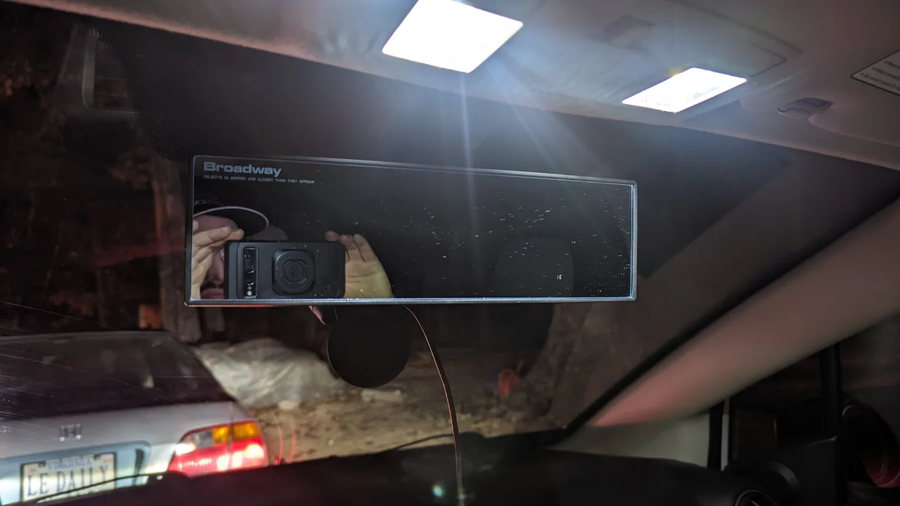

Broadway Mirror:
Broadway is somewhat of a big name, they're known for their Wide Angle, Low Glare mirrors. They have a very nice blue tint to them that lessens the brightness of other drivers LED headlamps and still allows you to clearly see. I had installed Spoon Sports mirror in my 99 EK Civic, and I couldn't go back to a regular mirror after that experience.
You typically see them in a lot of Import cars. My 5 was no exception, as these mirrors are universal and have a spring clamp that just attaches itself to the factory mirror.
This isn't an expensive modification at all, but including this mirror was possibly one of my favorites, as it allows me to see the blind spots a little bit easier in the 5.
They can be purchased on Amazon and I went with the 270mm Variant. In the pictures provided, you can see an example of how the mirror's wide angle can show you your unseen blind spots.

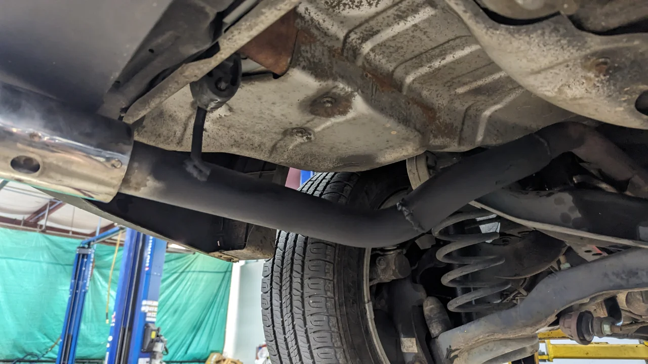

Lastly, for the First year of ownership, I decided to slightly modify my exhaust. Nothing too drastic, as this is still my current daily driver and I have other projects that I can be obnoxious with.
However, I just wanted a *touch* of noise, just so I could basically hear when the car was running.

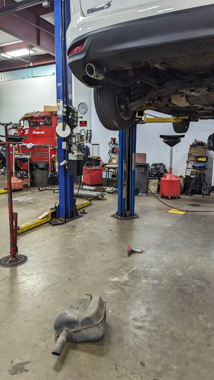

Back when I was at the dealer, I sometimes handled body shop repairs, as our attached body shop did not have any technicians that were trained to use a 2-post lift, as they were only panel beaters, parts installers, and a couple painters. It's a job that really didn't require a lift.
That being said, I was given an exhaust system off of a 2022 Mazda3 that had been rear ended pretty badly and I was tasked with replacing the exhaust system from the Cat-Back, as most cars nowadays are 1-piece exhausts systems.
Since the job wasn't a warranty repair, I was allowed to keep the old exhaust for scrap parts. I'm a hobbyist welder, so I took the liberty of chopping off all of the straights, the 90s and 45s to add to my collection of spare pipe that I used for custom odd jobs for friends that want to do some hoonery with a welder.
Anyways, I thought the resonated exhaust tips from this new generation of Mazda3 looked pretty neat. So, I decided to lop the suitcase off the back, cut up some spare pipe, and stuck the Mazda3 tip on the 5.
Now, the welds definitely aren't pretty, I pretty much just threw this together in 30 minutes, so I didn't expect it to turn out perfect my any means. Later down the road, I plan on adapting a Speed3 Rear Muffler with the Dual outlet for a better look in the rear. It's got some great low end noise to it and doesn't sound ricey. Very minimal drone when driving, only really on acceleration, then it calms down to almost nothing.
