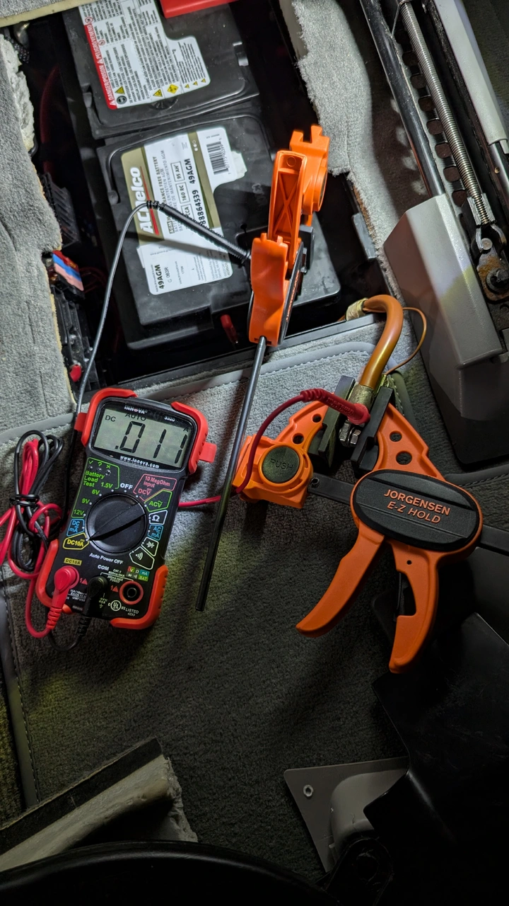

We have since purchased a 4amp charger and a multi meter. I checked for a parasitic draw, and the multi meter (on 10a DC voltage setting) would go from about 2.0a immediately after connecting, and after about 10mins down to 0.06a, then later showing 0.00, which seemed kind of odd. I would have expected some minor draw to remain, but not sure if probe got dislodged maybe? Testing a couple other times had shown 0.05-0.06a indefinitely after quite a while. And another meter we tried was showing 0.01 after a while... so kind of inconsistent readings. What should I be expecting to see here?
Anyway, I charged the battery to "full" which the battery got up to around 12.75V. After reconnecting everything and letting it sit for an hour or two, voltage was wavering around the 12.48-12.51V range. Will be curious to see what it sits at tomorrow morning, but my fear is it may continue to drop, and I can't tell if I have a parasitic drain or simply just need a new battery. Also concerned about replacing the battery if there is an ongoing parasitic draw.... and unfortunately i'm wondering whether something was damaged during the engine repair thats causing the battery drain problem in the first place.

Those readings seem fine, I would expect a few mA or tens of mA (0.0xA), so I doubt it's parasitic draw. I suspect you just have an old battery that's on its way out.
@RedBaron may be right that the battery is just on its last legs. But it's also important to take an inventory of any accessories you have plugged into the car. Some of them are known to cause battery drain, including remote starters.
But if you want to know for sure, it's not difficult to perform a parasitic battery drain test. If you're interested, let me know. I just went through this on another car...

And as per my original post, i did do a parasitic draw test, with some fairly puzzling results (0.06a, 0.01a, and even 0.0a?) so i'm not sure what to make of the results so far
Ugh sorry, I blame trying to eat and use the forums on the phone at the same time. I'm at the computer now with full attention!
How was the test performed? Did you affix the negative battery terminal to the multimeter and run it in series, or did you try to use a clamp meter? I find the clamps inaccurate for DC current at low levels due to noise.

I used the negative terminal in series. One thing that is truly puzzling, however, is that the heat shield for the battery appears to be missing! I have seen many photos of other people's CX-5 batteries and they all seem to have a protective cover around it.... we dont have that, so thats something that makes me wonder whether the battery was in fact replaced at some point?

Your parasitic draw is well within range. It will start higher at first as all the modules power up and wake up. But perhaps you have a different issue. Putting one lead of you VOM on battery positive and the other on body ground note the charge voltage on the meter. It should be above 13.5 volts but Ive seen some 14.5 to 14.7 Engine must be running. Compare the static battery voltage to the charging voltage. You may just have a poor ground somewhere.
Whats weird is, i did the current/draw test AGAIN this morning, since the battery seemed to hold a bit of a charge overnight at 12.5V. As before, the current dropped to 0.06a after several minutes. I left it for about 10-15 minutes more, came back, and its once again at 0.00a (according to my meter).
That seems weird to me, because by all accounts i've read on this forum and elsewhere i should be seeing anywhere from 0.01a-0.03a as a regular ongoing draw (from the security system, or whatever else may be running).

I will check the charging voltage with this meter next. I tested it with another meter that didnt have good resolution for DC Voltage, and it was indeed in the 13's but didnt' give me 10ths of a volt so I'm not sure where in the 13's. I also remember reading somewhere about testing ground using resistance on the meter, but i can't remember where I read that.... is that something that can give me some useful information?
I just tested the battery disconnected overnight to see if it holds a charge. I charged it up using a charger and when disconnected the battery read 12.87v. This morning, with ground disconnected overnight, the battery read 12.5v. So it did drop a little bit from fresh off the charger, but I was expecting if the battery was bad for it to have dropped into the 11's or low 12's in voltage?
Not overnight, it won't. If you dropped by 0.3v overnight though I think the battery is bad. I expect a good battery to lose 0.01 to 0.03 overnight when not in use.
