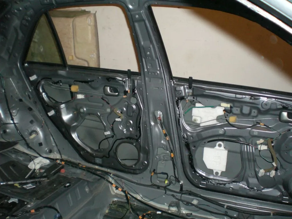

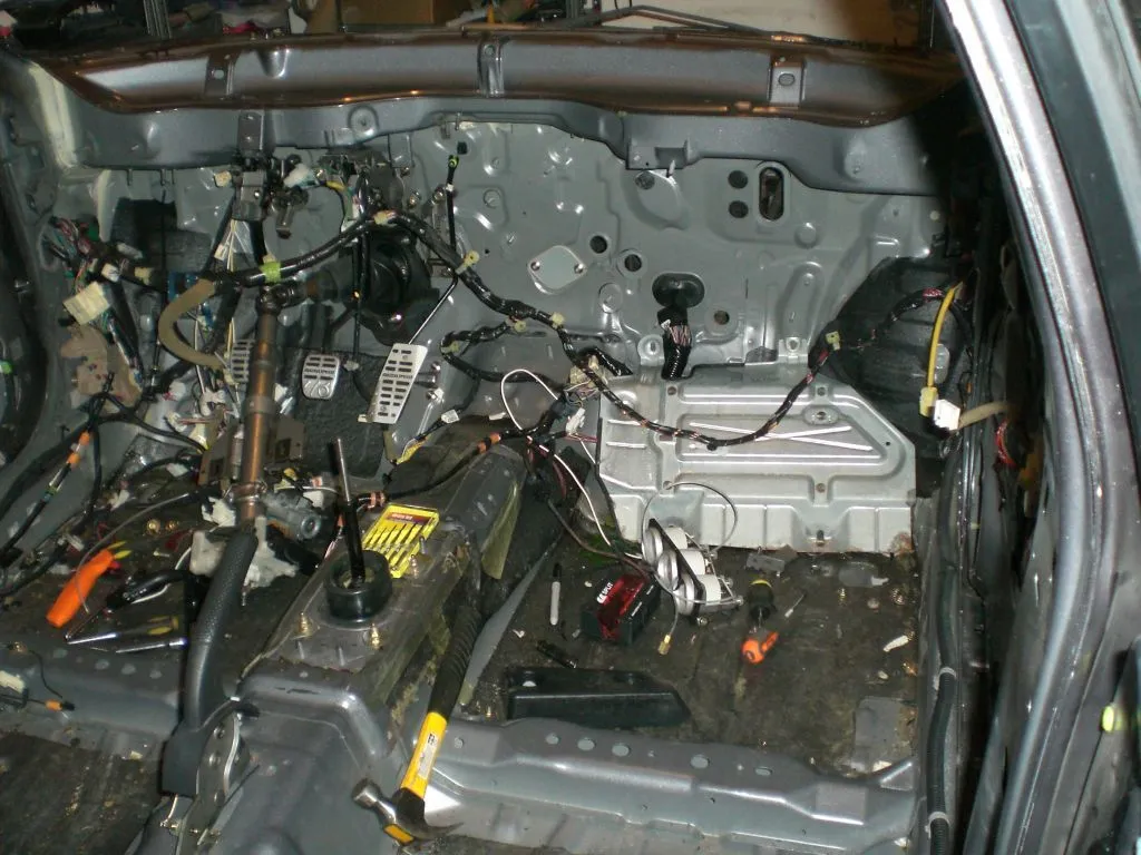

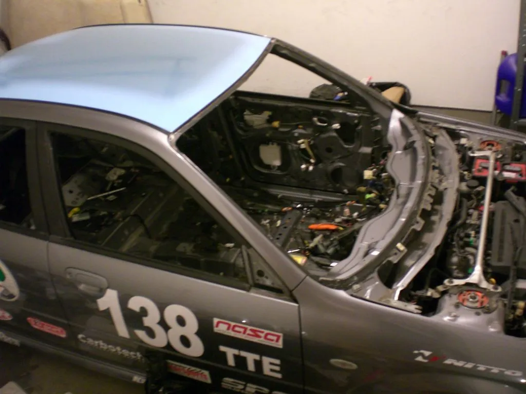

Here are a few pictures of the car, before I start installing the roll cage:
i'd be so worried that i couldn't remember how to put the parts back in.
I labeled the wiring harness and I have to make my own mounts on the roll cage for the dash. Other than that nothing is going back in so its nice and easy.
