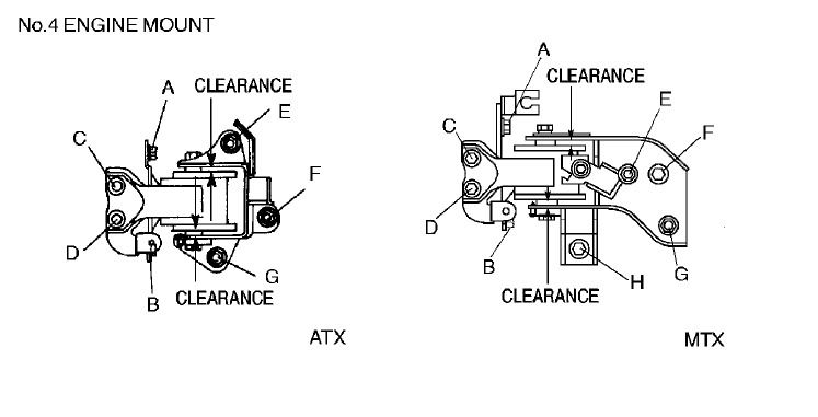

It's been almost two months but to clarify it for people, all three engine mounts meaning front, rear and front right (passenger side) are the same on all 2.0's excluding the transmission mount ( driver side ) due to Auto or Manual. I don't really think length mattered but only the extra brackets for the manual mounts only. Also checking clearance on the mounts matters as well food for thought.

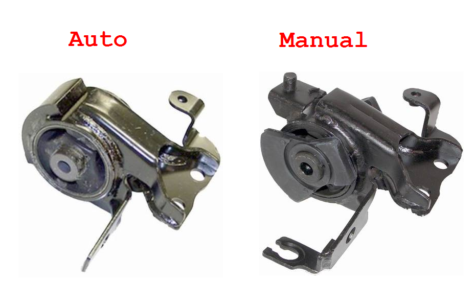

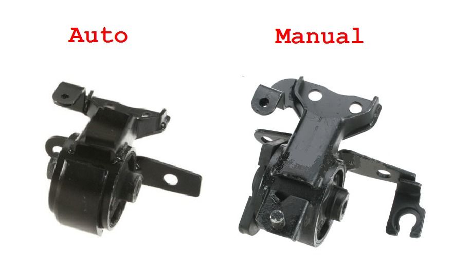

Different Mounting Points in the Transmission:
Here is the difference in the Trans Mount:
