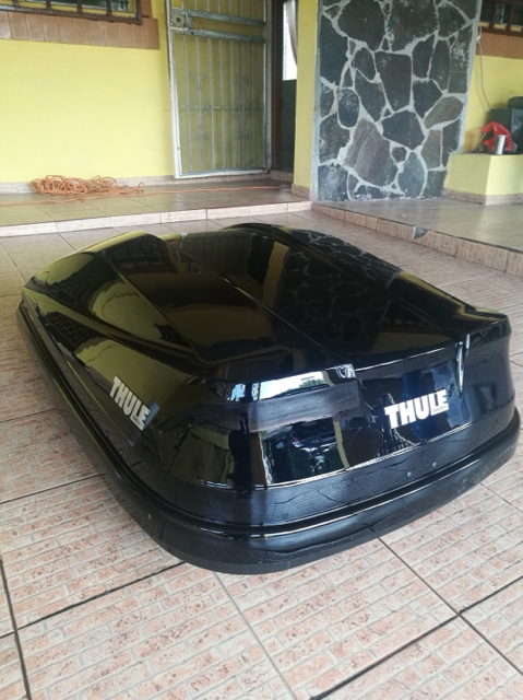

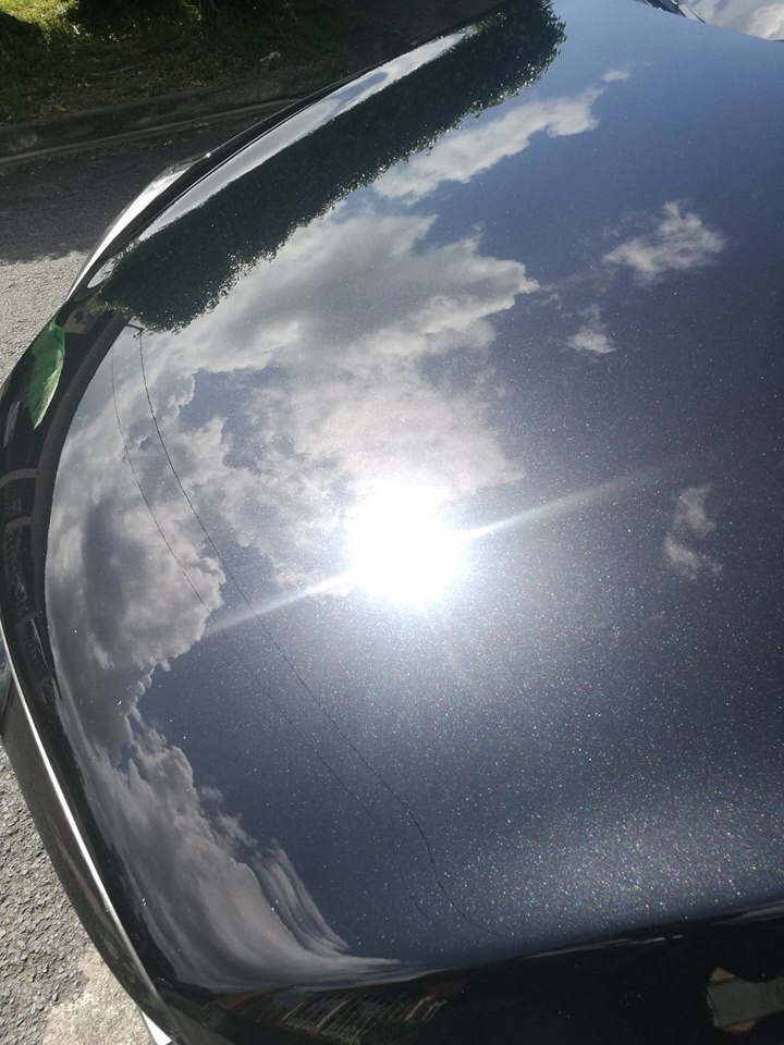

the detailer took about 12 hours detailing task, from decontaminating paint, clearing previous hand polishing marks, and other paint details, that where only noticeable when a hand lamp showed up.
Well, CarPro Ceramic coating definitely enhanced the shine. No more bugs in my car hood, nor the roof box. Meaning, washes are much easier.
