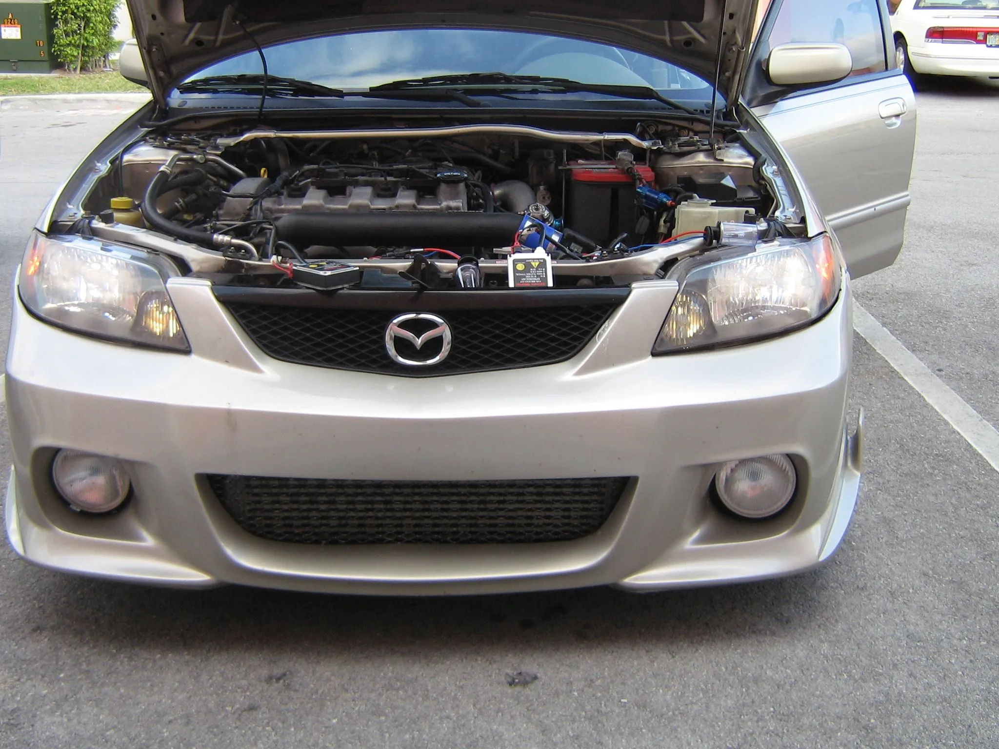

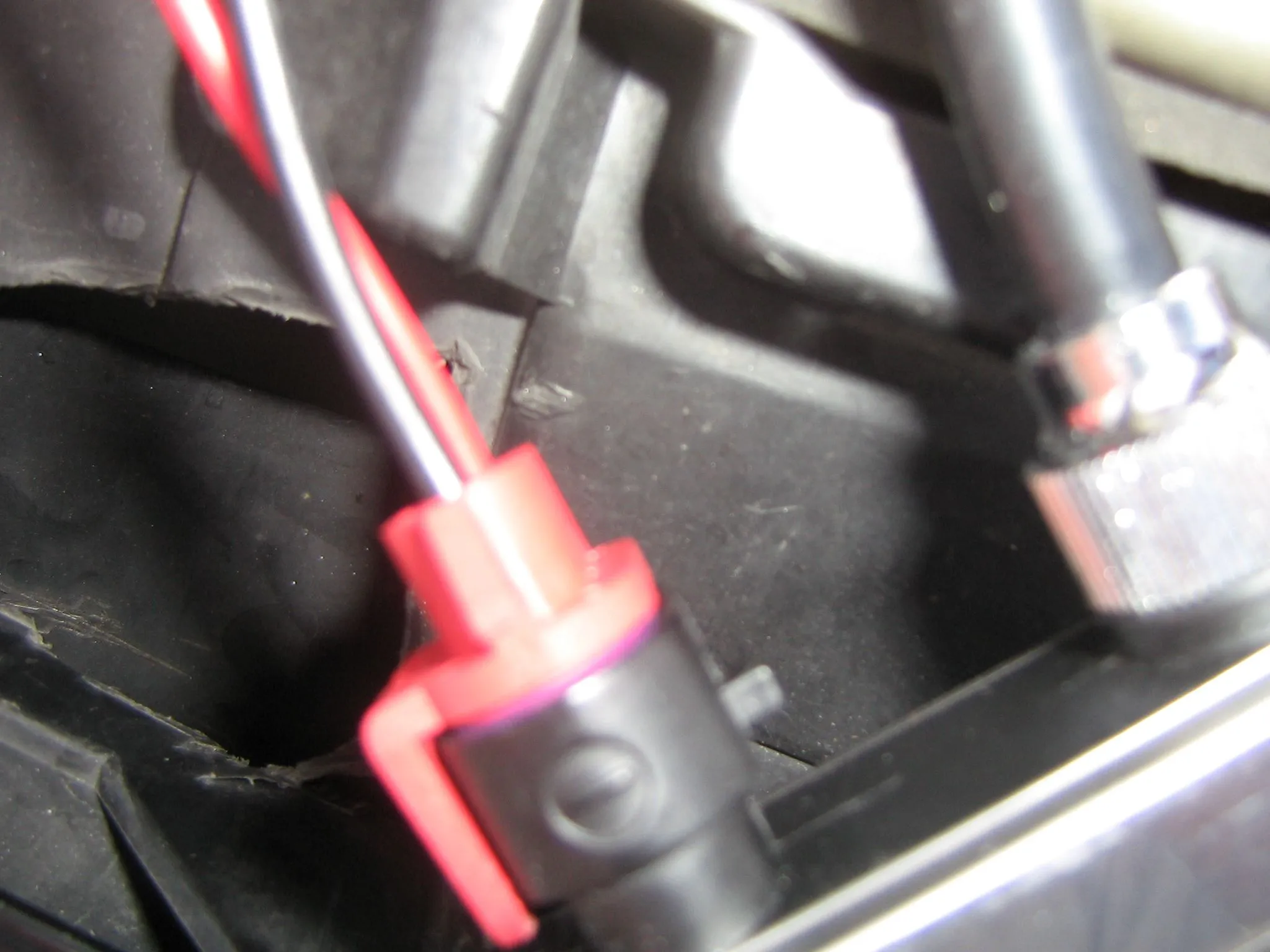

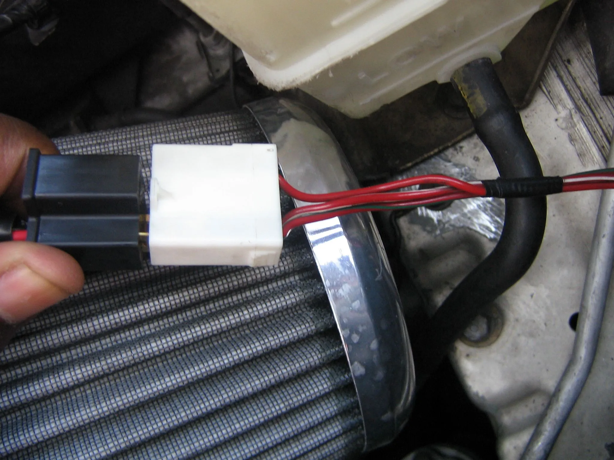

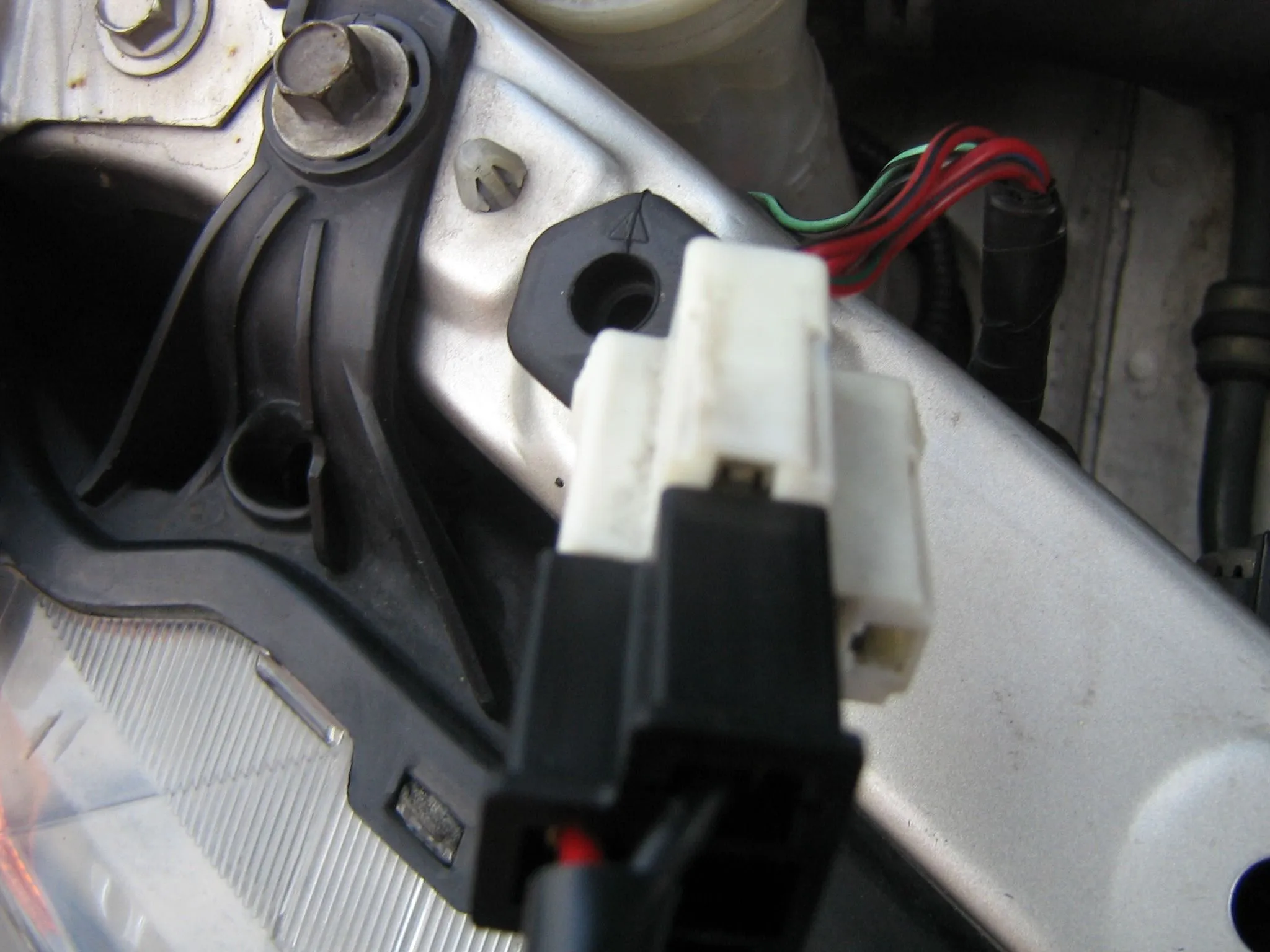

Pictures of problem with HID install

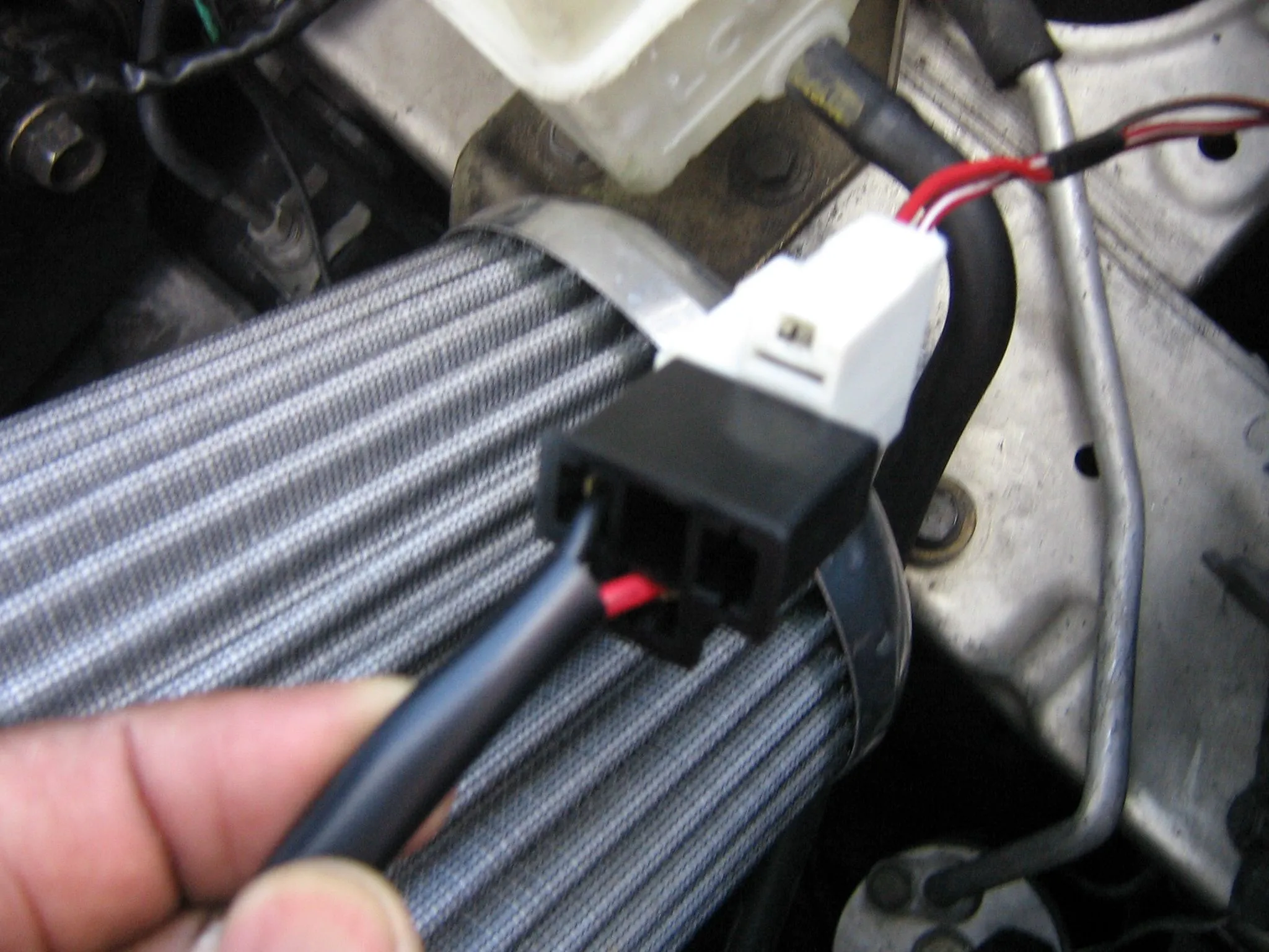

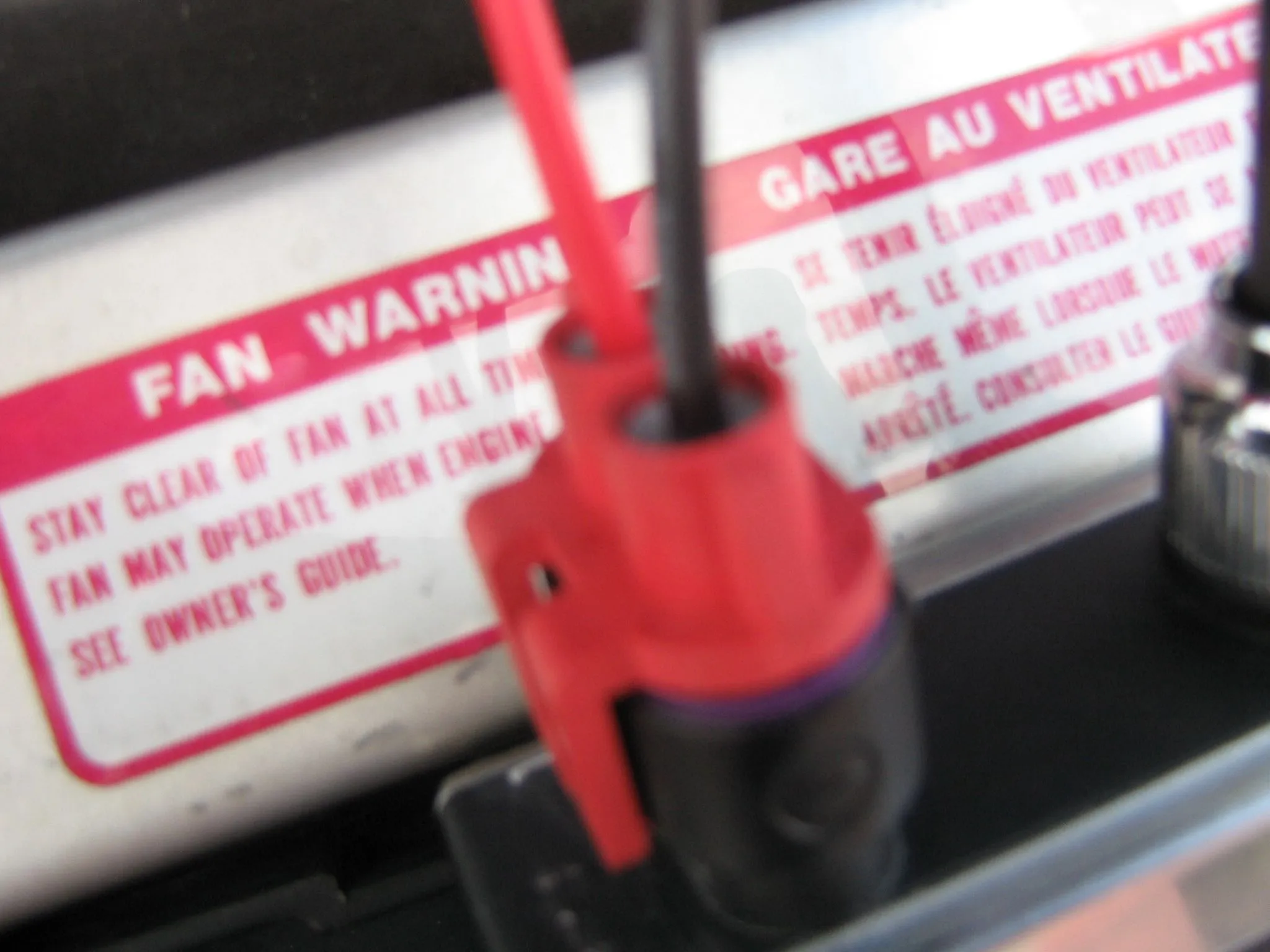

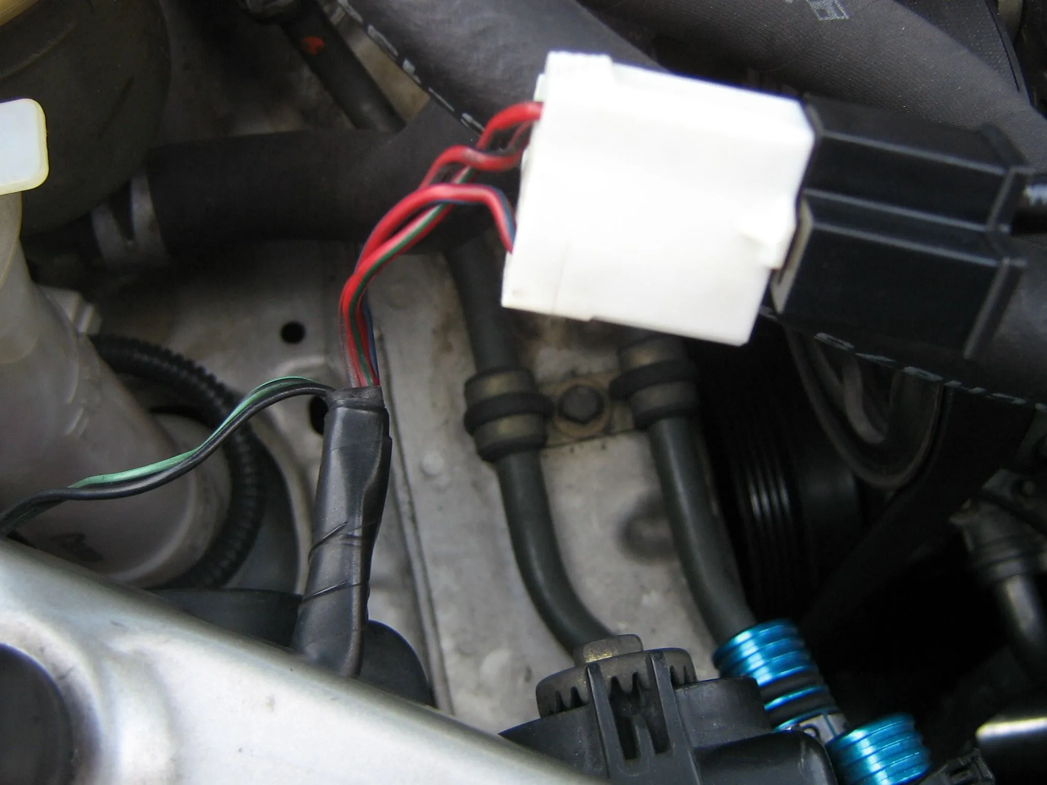

Here are pictures of my car with working headlights and how I have connected the kit. Need help HID still flashing/arching, they won't stay on

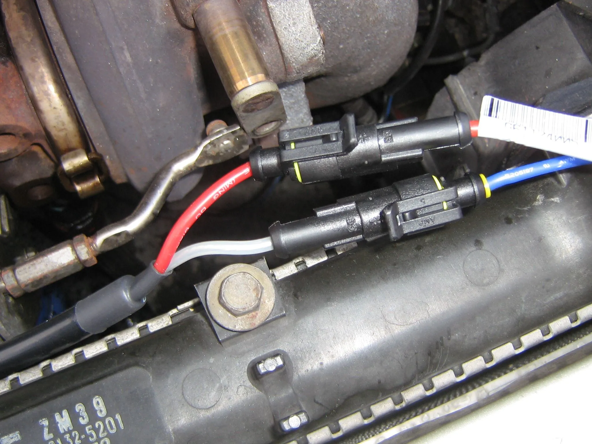

More Pictures
BlakeCTX said:
ill will take pictures tomorrow of how to install them and we will see if we can fix it. It may be just an installation issue.
everything looks fine my friend, please let me know your email cause i sent the pics but the email was returned. To let you know how to fix it.

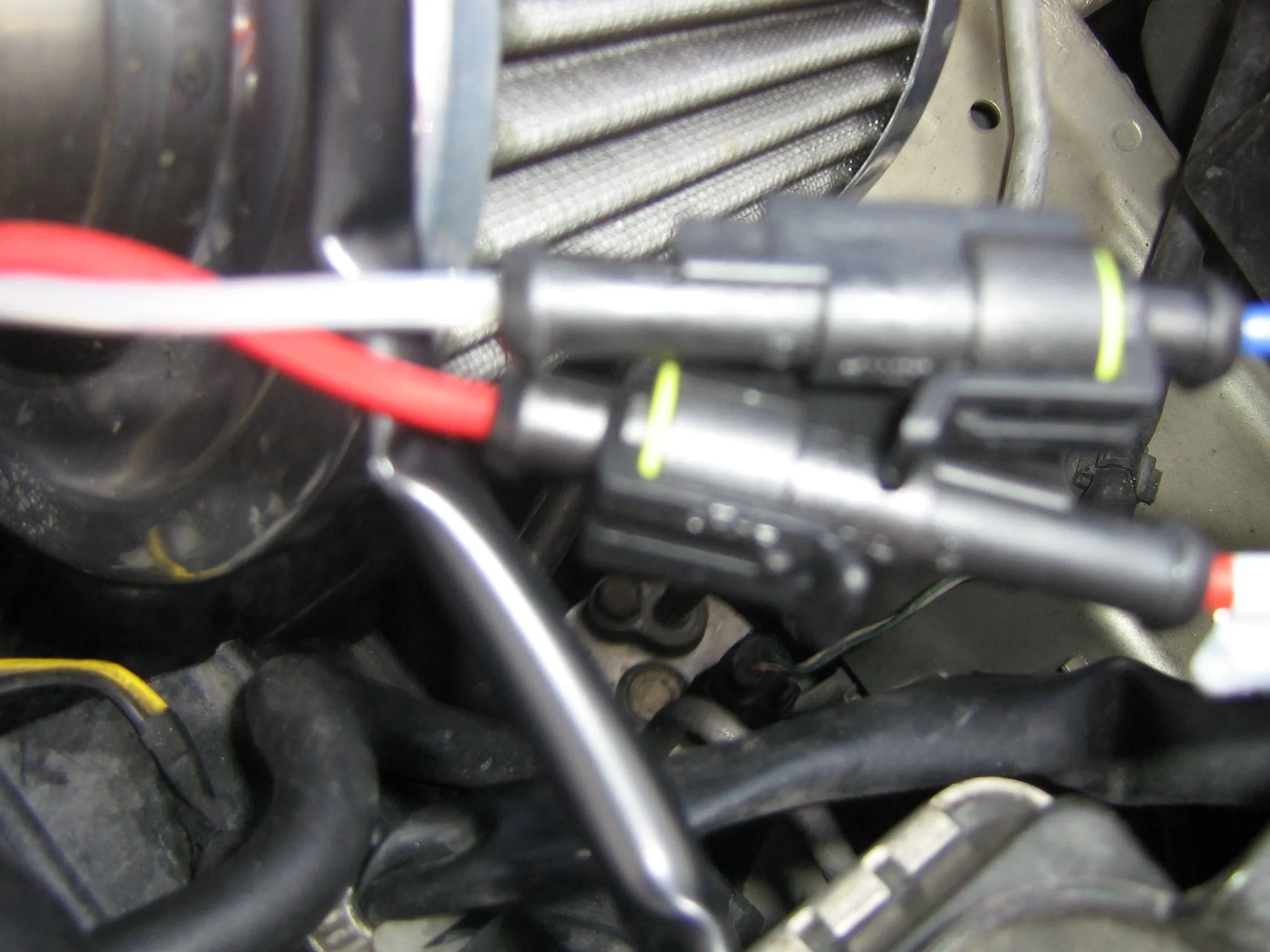

More Pictures
Ok, well I dont have my bulbs yet, and its like 20 degrees outside. Im trying to get pics up, try flipping the plug and see what you get, if it is plugged into the hi-lo side, then it would just make it flash and turn off. I had the same problem but I flipped the setup and BAM perfect worked great.

Sorry, I sent the pictures and went to school yesterday, I am just getting back on the forum now. My email address is owen2me@bellsouth.net (personal), you can send me a pm or owen_christie@fpl.com (work). Please send me the pictures again. I have tried switching the bulbs and ballast but still no go. I was going to reverse the direction black & red wires that plug into the ballast and then go to the headlight connector, but it is set up to go only one way and wont let you reverse it. The same goes for the connectors to the bulb from the ballast, it only connects one way. Still need help!!!!!!!

take the plugs outta the connector and just insert them into the harness.
Sorry, just getting home from work. I am not sure I understand your instructions. Could you clarify what you mean. Sebastian/Xenon Shop sent me a pm to install two capacitors (4700 micro faraday/16 V) but I am not sure how to connect the capacitors to the flat 2 prong connectors from the ballast and I am not thrilled about splicing the wires coming from the headlight connector. Has anyone had to do this to get there HIDs to work?
