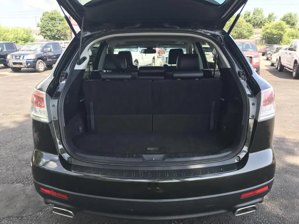

Can anybody with a first gen confirm that this ballmount comes out at 90 degrees? Either an image or a verbal confirmation? The only reference I have is this image I got from Facebook of a similar repair:
This one appears to be at quite an angle, but it also is only tacked into place, so I suspect it isn't the final repair.
I don't have a first gen cx-9, but scoured auto trader for photos that might help you. To me it looks like the ball mount is mounted horizontally (or almost horizontally towards the passenger side).
Youri, thank you for your efforts. I did the same type of thing. Pretty sure I've seen every liftgate image on the net. LOL
I really need a close up of the mount to confirm/deny my thoughts.
