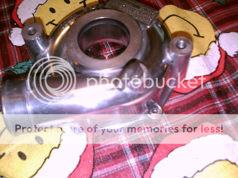

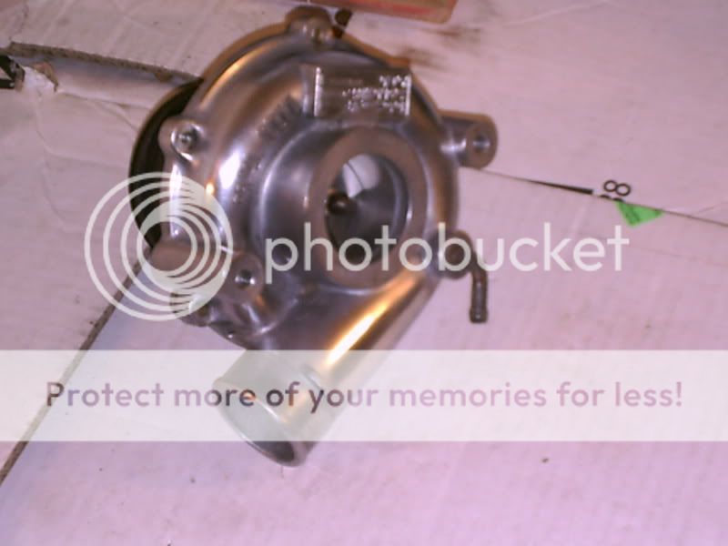

and yes the turbo I bought is a vf11 in a vj20 shell. So its the hybrid like your talking about.. Here are some pictures of that and the BP

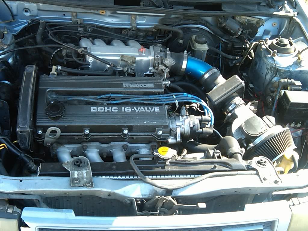

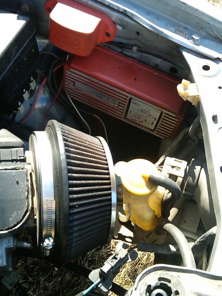

Hey whats up guys,
This is my 1990 1st gen Protege. My dad bought it new off the lot no ac, after I moved to college I was given the car. Used to run 15.7 at firebird raceway in Pheonix. anyway the car has 487k miles on it. yes this is true. The second motor blew at 480k on it. since then I have completly gone through the entire car
List of mods
susp mods
Eibach 2" lowering springs
new brakes ball joints tie rods
polly urethane busings all the way around
engine mods
pacesetter header
ported polished head
msd ignition
knn custom air filter
11:1 toda miata pistons
balanced and blue printed block
centerforce dual friction clutch
180 fwhp at 6800 rpm
This car has been in my life since I was 12 years old I am very proud of it, I call it my modern day rat rod. Future mods may include 550cc injectors stand alone fuel injection and possibly a gtx awd drivetrain. Here are some pics tell me what you think...
