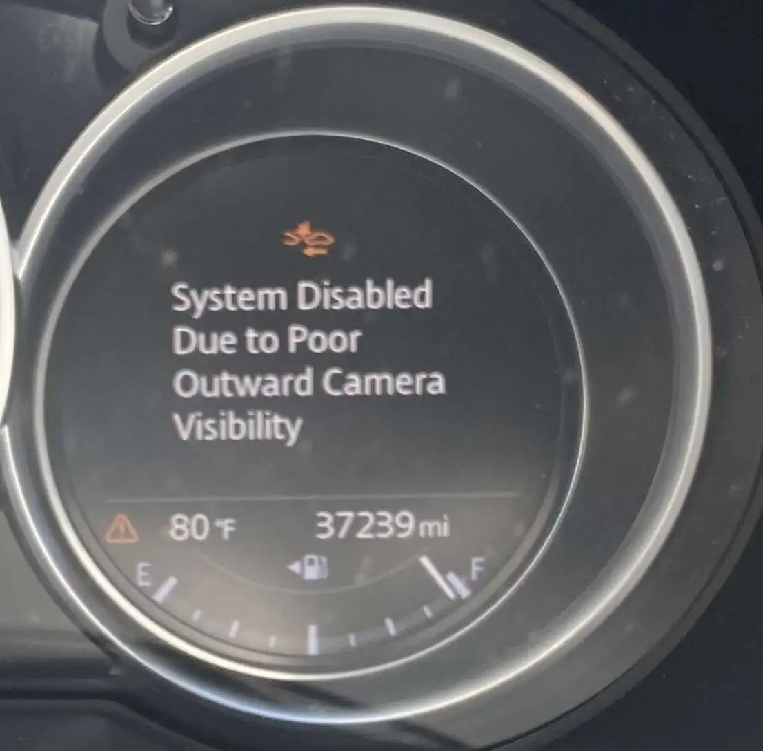

Poor Camera Visibility System Disabled Error (2020 Mazda CX-5)
This is the second time I took my car to the dealer regarding this issue.
They say it’s because dirt might be affecting it or it’s because of the sun.
Is this accurate or am I getting the run around.
Thanks

thats normal when driving towards the sun at specific angle, yes.
Nothing the dealer can do as far as I know.
Once the sun no longer shines into the camera , the system would resume operations.
I get the same quite frequently when driving west/north west around 5pm+\- and when the sun is lower on the horizon or east in the early mornings:)

Thanks, thats kind of crappy though. It’s a design flaw that’s to me not cool.
You pay all this money for a vehicle and we have to accept this design flaw.

I've only had this happen 1 time in the past 3 years. The sun was right in my eyes, and I needed to move the visor so I could just see above the car in front of me. There's no way I would have been using adaptive cruise in that situation. It almost sounds like yours may be out of alignment, if you felt safe enough to be using it. Did you get any warranty with your recent purchase?
It should only affect adaptive cruise control under 15 mile per hour (or at a low speed like that, i forgot what the speed threshold actually is). Above those speed the adaptive cruise control relies on a radar and is not affected by the sun. This is a limitation of the technology used. Cameras and laser sensors can’t cope with direct sunlight. It blinds them the same way it blinds people.
This should only happen on rare occasions and for short period of time however, if it happens often at various time of the day then you may have a mechanical/technical issue to be resolved.

I did have an issue with it once traveling at high speeds
What i mean is that adaptive cruise control should still work at high speed even with that warning. The warning will still pop up at high speed to inform you that the low speed system is disabled but it doesn’t affect everything.
On the screenshot you took of the warning, the icon shown ( the car crashing into another car icon) is the smart city brake support icon. Usually this comes with another warning that says something along the lines of: adaptive cruise control disabled under xx mph.
From the owner manual:
“In the following cases, the MRCC with Stop & Go function system is cancelled when the vehicle is travelling at 30 km/h (19 mph) or less and “Mazda Radar Cruise Control disabled under 30 km/h” is displayed in the multi-information display.
  • The Forward Sensing Camera (FSC) cannot detect target objects (There is problem with the Forward Sensing Camera (FSC) or windscreen is dirty).”
There are a lot of scenario in the manual that identifies situation where the sensors cannot work and its consequences. In all cases the car warns you by stating which system is disabled, so you know not to falsely rely on it when that happens. Check the Forward Sensing Camera (FSC) (Some Models) in the i-activesense section.
I understand your disappointment that these so called automatic system don’t work 100% of the time, but i would be surprised if you found a car model that didn’t have these kind of limitations for these capabilities. You can always return the car and shop for something else.
What i mean is that adaptive cruise control should still work. The warning will still pop up at high speed to inform you that the low speed system is disabled but it doesn’t affect everything.

In my 2020, over 21 months and 9,000+ miles, I've not had this message appear nor the one's described in the owners manual. As others have noted, the affects of sunlight should be relatively rare, a peculiar set of circumstances. A few important additional points about these systems:
1) Cameras behind glass will have inherent limitations. While you may be thinking about how your smart phone camera adjusts to all kinds of light conditions, try shooting a pic through a window with glare, dirt, water, road salt or ice. Given what these systems are asked to do, they should be erring on the side of caution so you don't kill yourself. If such cameras are not behind glass, the problem would be worse with water, dirt, salt, etc. directly on the lens. Consider how backup cameras get cloudy with any of that stuff on the lens. Then there's the matter of fog. No camera of any kind is going to get a clear shot through pea soup.
2) Read your manual starting at page 4-207 and read the laundry list of warnings and cautions. Something besides light and windshield crud may be affecting the performance of your camera. Any other car would have similar warnings.
3) This is not a design flaw. It is a technological limitation of cameras not unique to your vehicle or Mazdas or this price point. Consider the following "Autopilot" warning from the Tesla S 2022 manual, a vehicle that would set you back $100,000+, which has three forward facing cameras and numerous other cameras and sensors:
"Ensure all cameras and sensors are clean before each drive. See Cleaning Cameras and Sensors for more information. Dirty cameras and sensors, as well as environmental conditions such as rain and faded lane markings, can affect Autopilot performance."
There is no such thing as "autopilot", self-driving, or autonomous functions no matter what Elon Musk or anybody else tries to sell you. Think about Tesla drivers whose vehicles are being splashed with slush and road salt who think their vehicle can drive itself.
In fact, certain functions in your Mazda may work better under specific conditions since Tesla discontinued the use of radar some months back. I don't know if Musk has backtracked on that since.
The 2020 manual states on page 4-152 that auto cruise will not operate at speeds above 90 mph, if that happened to be your situation.
What I mean is that adaptive cruise control should still work at high speed even with that warning.
That doesn't sound right.
Check the warnings in the Front Sensing Camera section (starting at page 4-207 in the 2020 manual). There are all kinds of conditions where MRCC with Stop and Go is disabled if the camera is not able to function properly. It does not appear to differentiate between the MRCC function vs the Stop and Go function. It looks like all or nothing. I sure hope so. Here's one example among several:
"If the Forward Sensing Camera (FSC) cannot operate normally due to backlight or fog, the system functions related to the Forward Sensing Camera (FSC) are temporarily stopped and the following warning lights turn on. However, this does not indicate a malfunction.
 High Beam Control System (HBC) warning light (amber)
 Lane-keep Assist System (LAS) & Lane Departure Warning System (LDWS) warning indication
 Mazda Radar Cruise Control with Stop & Go function (MRCC with Stop & Go function) warning indication
 Smart Brake Support/Smart City Brake Support (SBS/SCBS) warning indication/ warning light (amber
Imagine what would happen if what you said was true. You're cruising along at highway speed and come up upon a traffic stoppage. The car starts to slow down. As it hits 19 mph, the point where you expect the vehicle to stop itself, it doesn't and an alarm goes off. In that WTF moment you slam the guy in front. In the absence of a specific warning in advance that the Stop & Go specifically is not working before you get to that point, it would be quite dangerous. I don't see anything that says such a differentiation exists. It's all or nothing.
