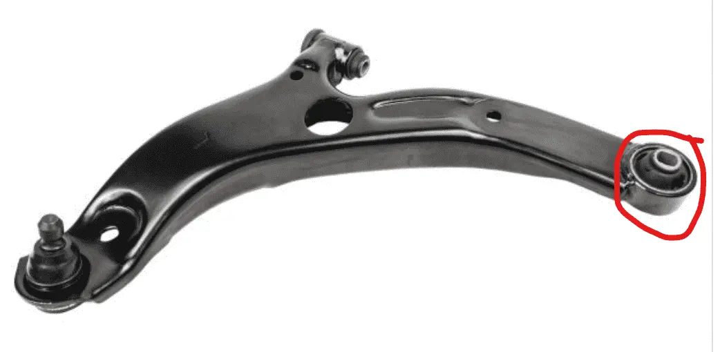

Theoretically, is it "kosher" to run a front lower control arm with one polyurethane bushing and the rest being standard rubber? I would assume that durability and stiffness would be increased by changing to a PU bushing, but can anyone confirm? My other concern would be wearing out the other bushings from the stiffness of the PU one, similar to engine mounts.
For a bit of context, I replaced my LCAs with ACDelco units around 20k miles ago and the main bushing attaching to the body (pictured) is already completely torn and is making a terrible clunking noise I believe. The other bushings seem fine. I drive my car a bit hard so I understand that extra maintenance will be required. What I am concerned about it how I can properly prevent this from happening again in the future.
PU bushing kit:
I would also consider switching to full PU in all bushings, but I have read that it can cause a stiff and squeaky ride, which I want to avoid as much as is reasonably possible. If anyone has any general feedback on PU suspension bushings, your feedback is appreciated, thanks!

Hmmm, do you think they are significantly higher quality than an equivalent OEM replacement (like ACDelco) or an actual OEM part? I'd totally go for them if I wasn't concerned about wearing them out quickly again. The imbalance of wear between the three bushings in my current LCAs is what's causing me to consider the PU bushing replacement.

It hasn't been that long and my front bushings are already torn, same as last time. I do admittedly drive my car hard, but these things just fall apart so quickly.
I kept my old LCAs from the last time I did this and I've purchased a set of Whiteline poly bushings, per my first post In this thread.
We'll see how this goes.
