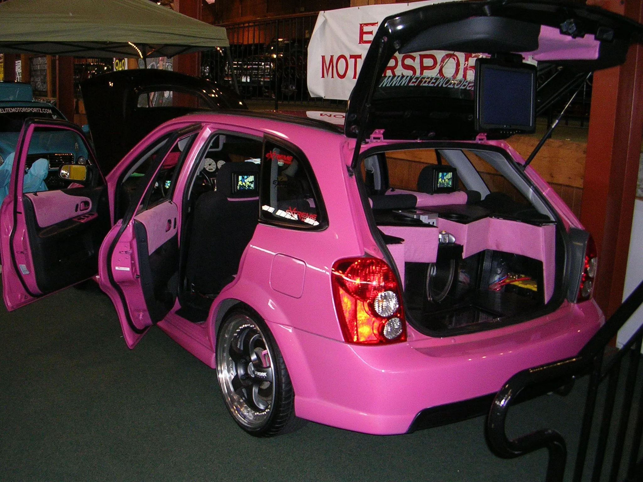

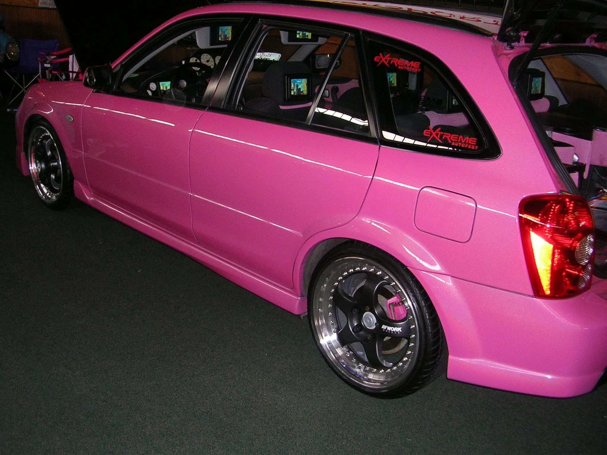

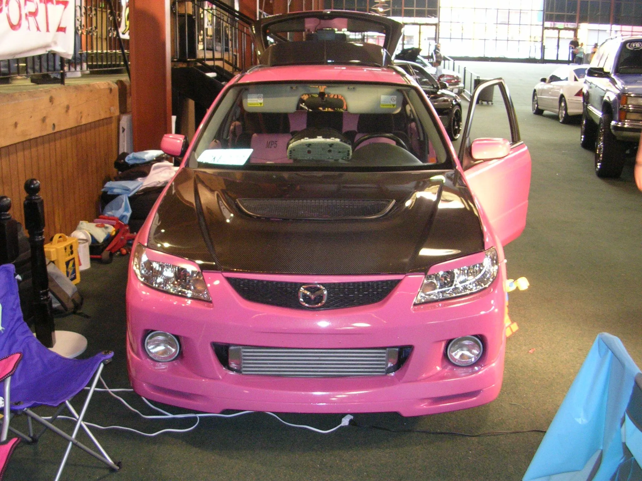

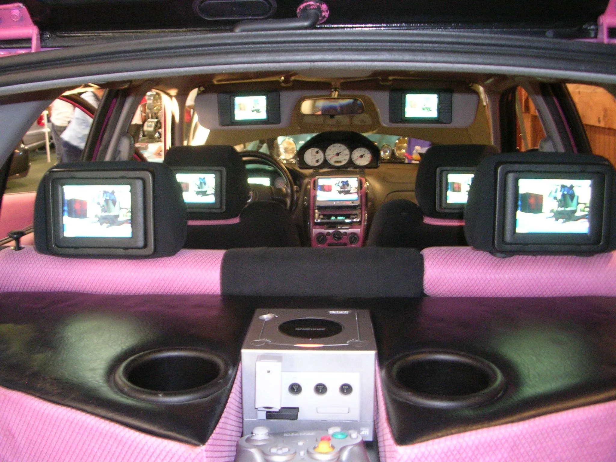

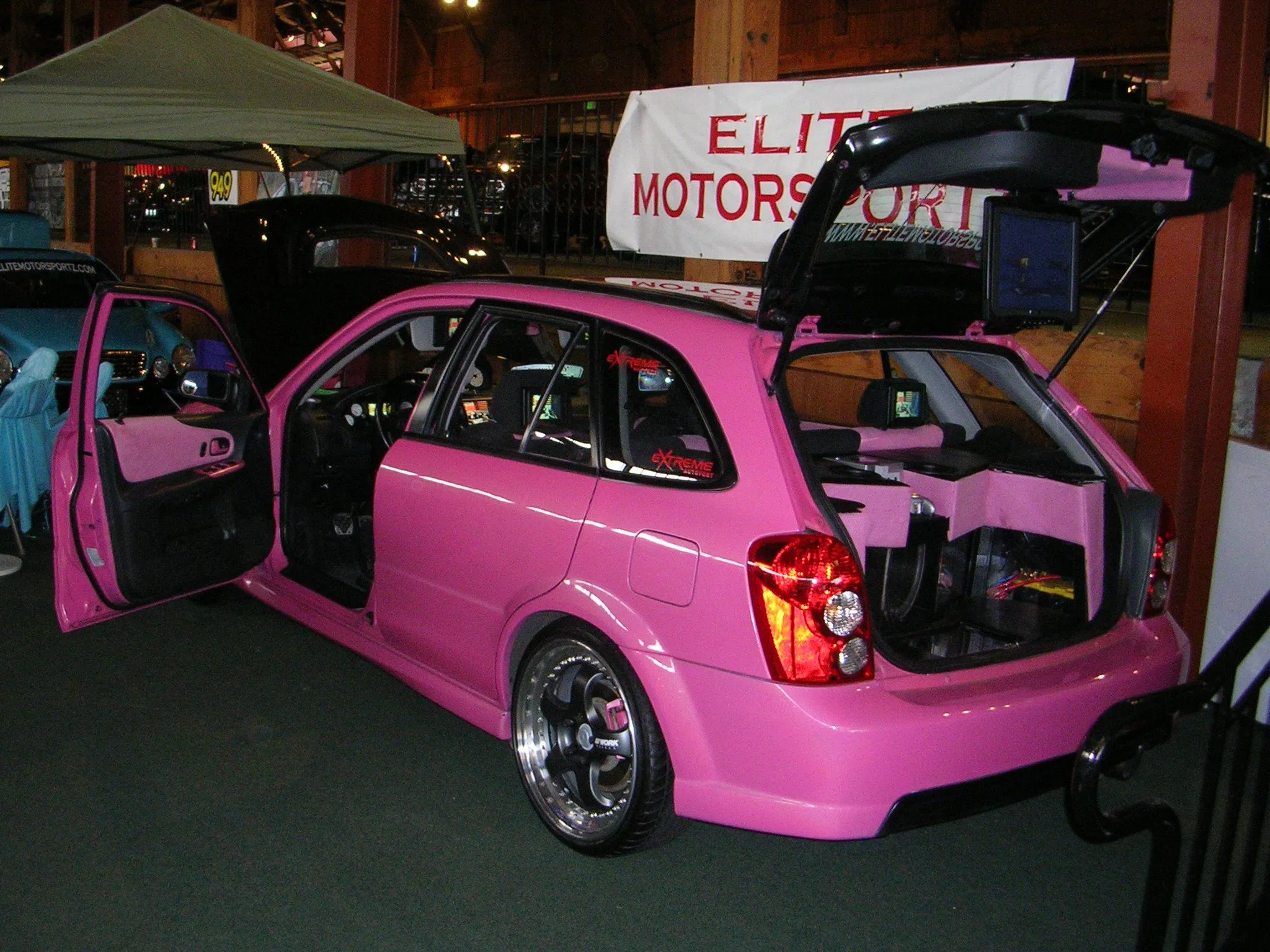

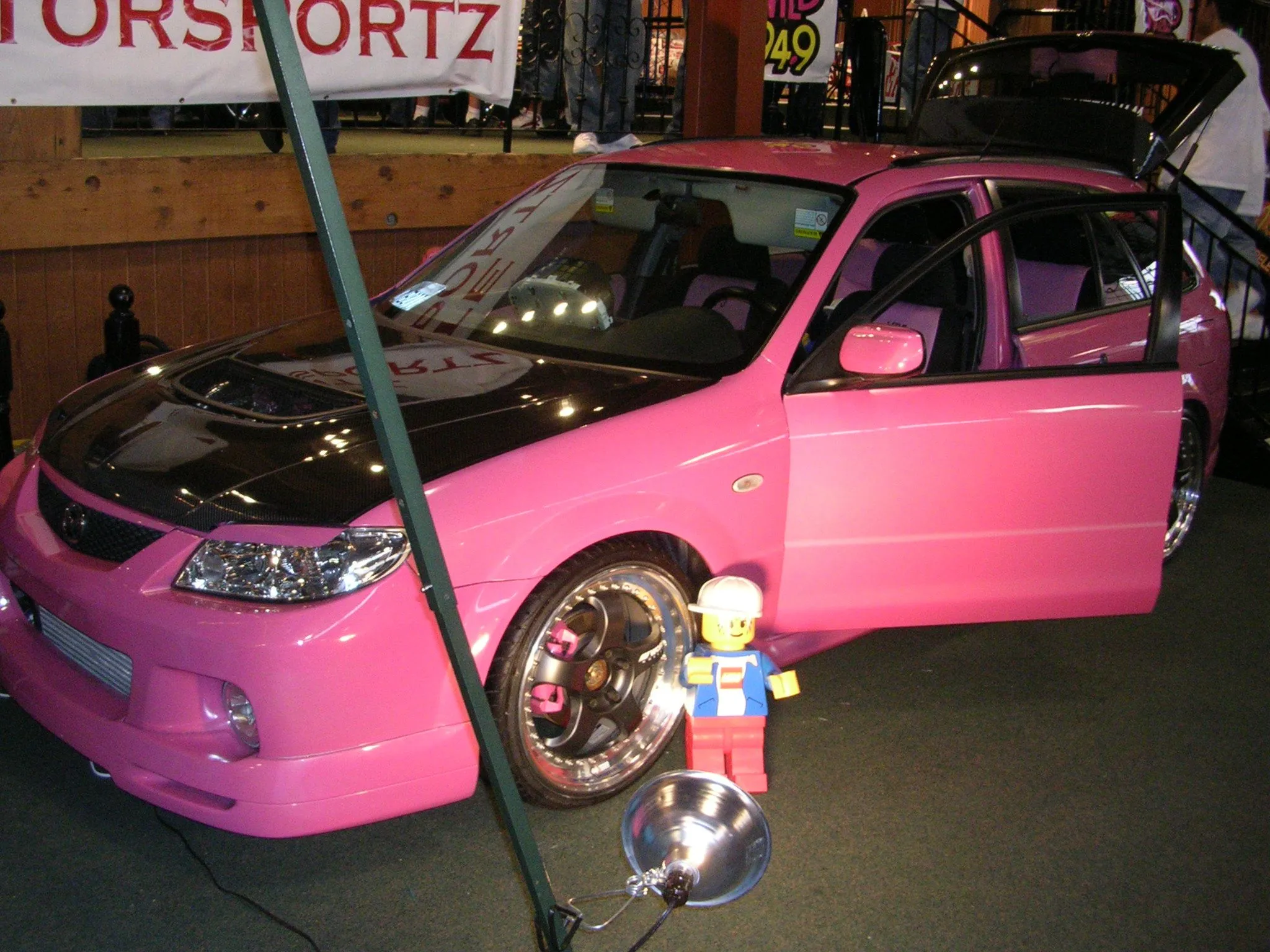

Pinky At Show..
Some pics of my DAILY DRIVER.. Enjoy..

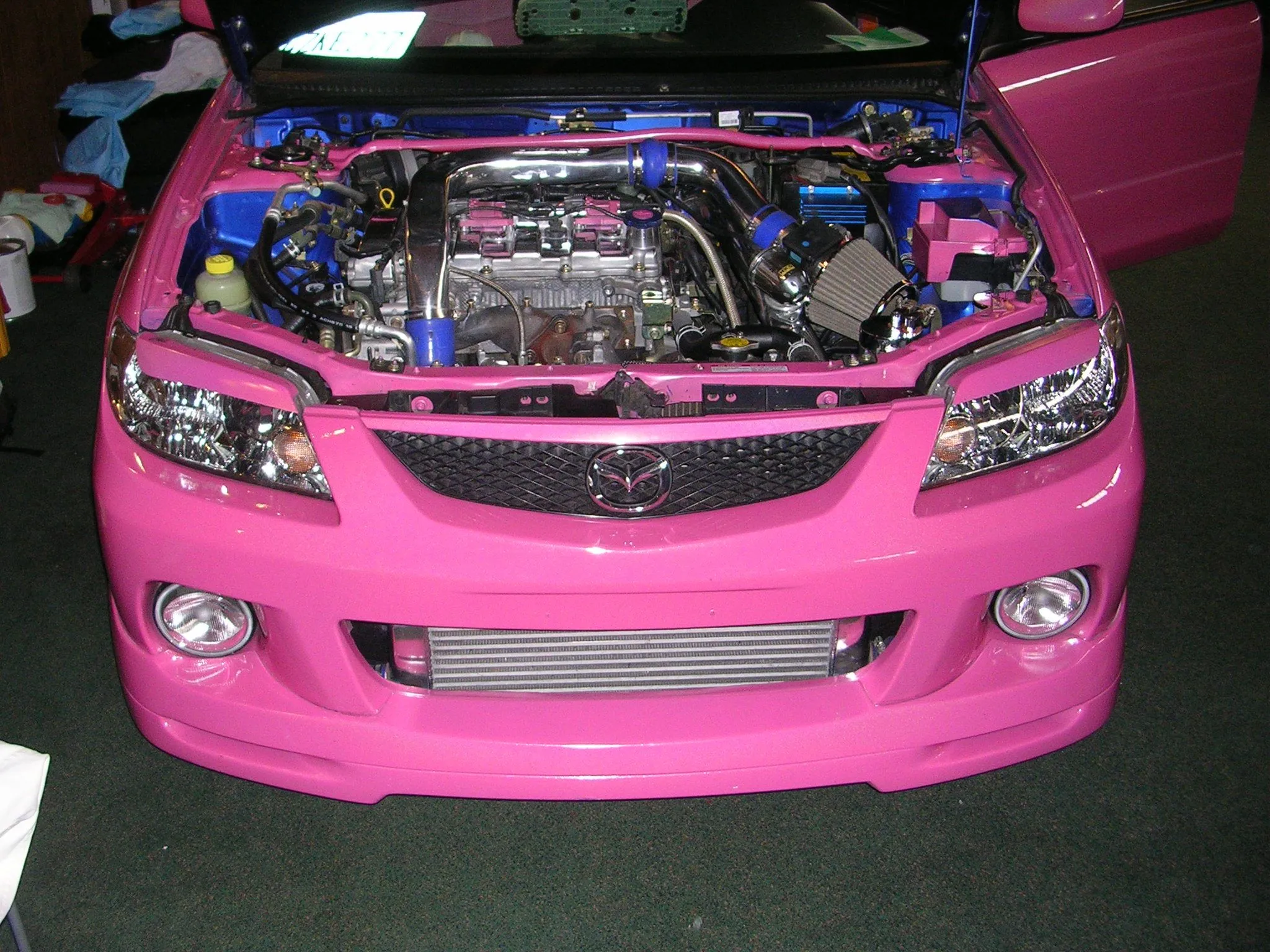

im glad to see you got some better wheels. the blue ones looked a bit strange.
btw, you need to paint your headlights black.
Yeah.. Just worried that it may get foggy. I seen some that did get messed up and DAM that SUCKS!! Thanks for the thought.
its pretty hard to mess them up. ive done 3 sets and they all turned out very well.
dominoy2k1 said:
one otherthing, the paint job under the hood sucks. other than that looks good.
YEA IT DOES!!! =) Ill look into doing it when i pull the motor out when i have to smog.. Haha.. thanks.. IT DOES LOOK BAD!!!=)

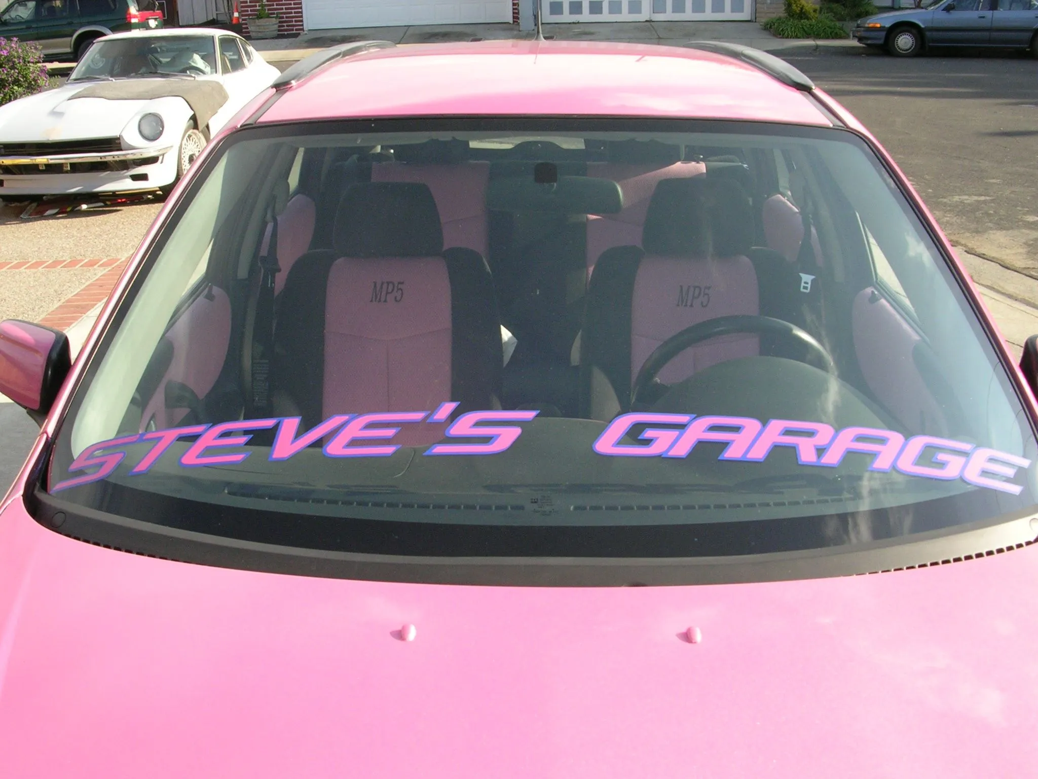

All the work was done by a my bud and I. Everything was done Steve's Garage!! haha.. That's me!! But we rented a booth to paint the car.

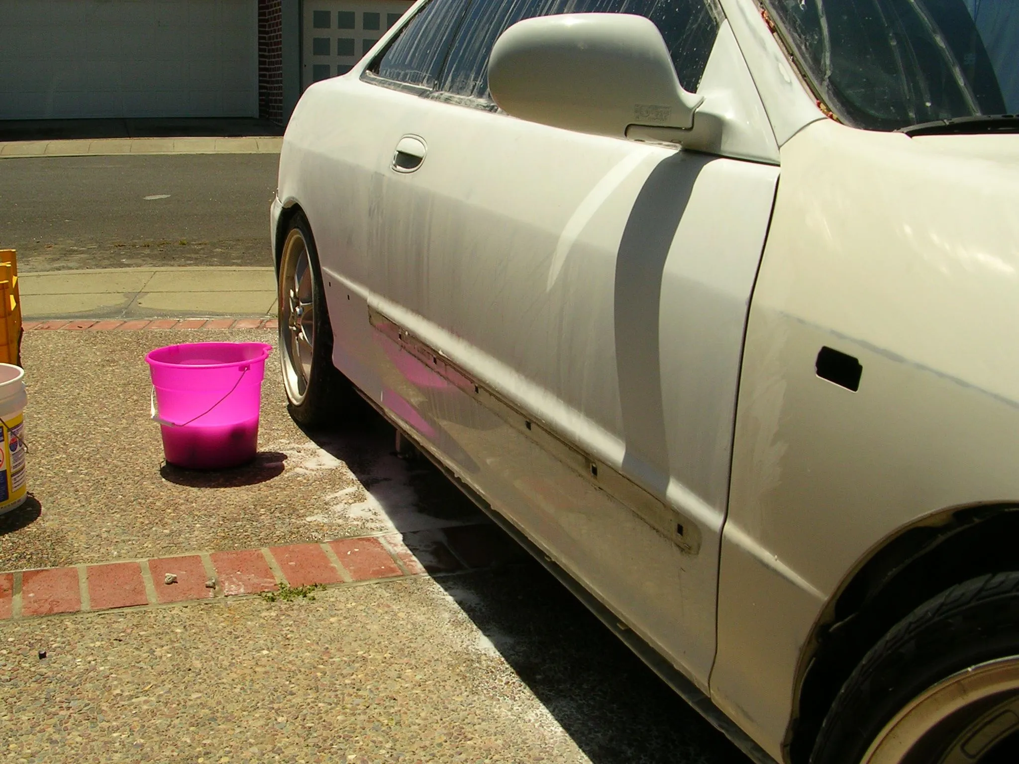

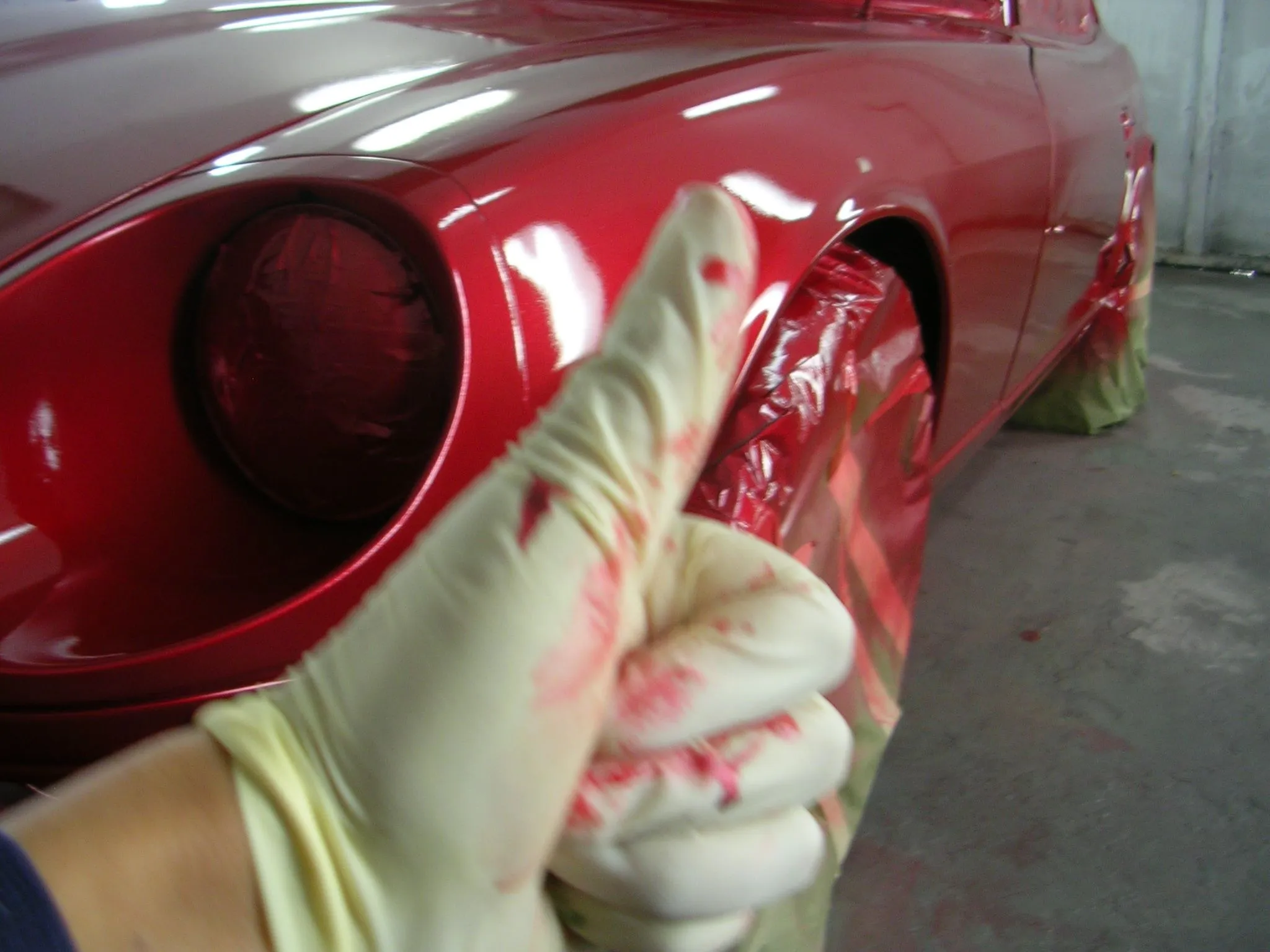

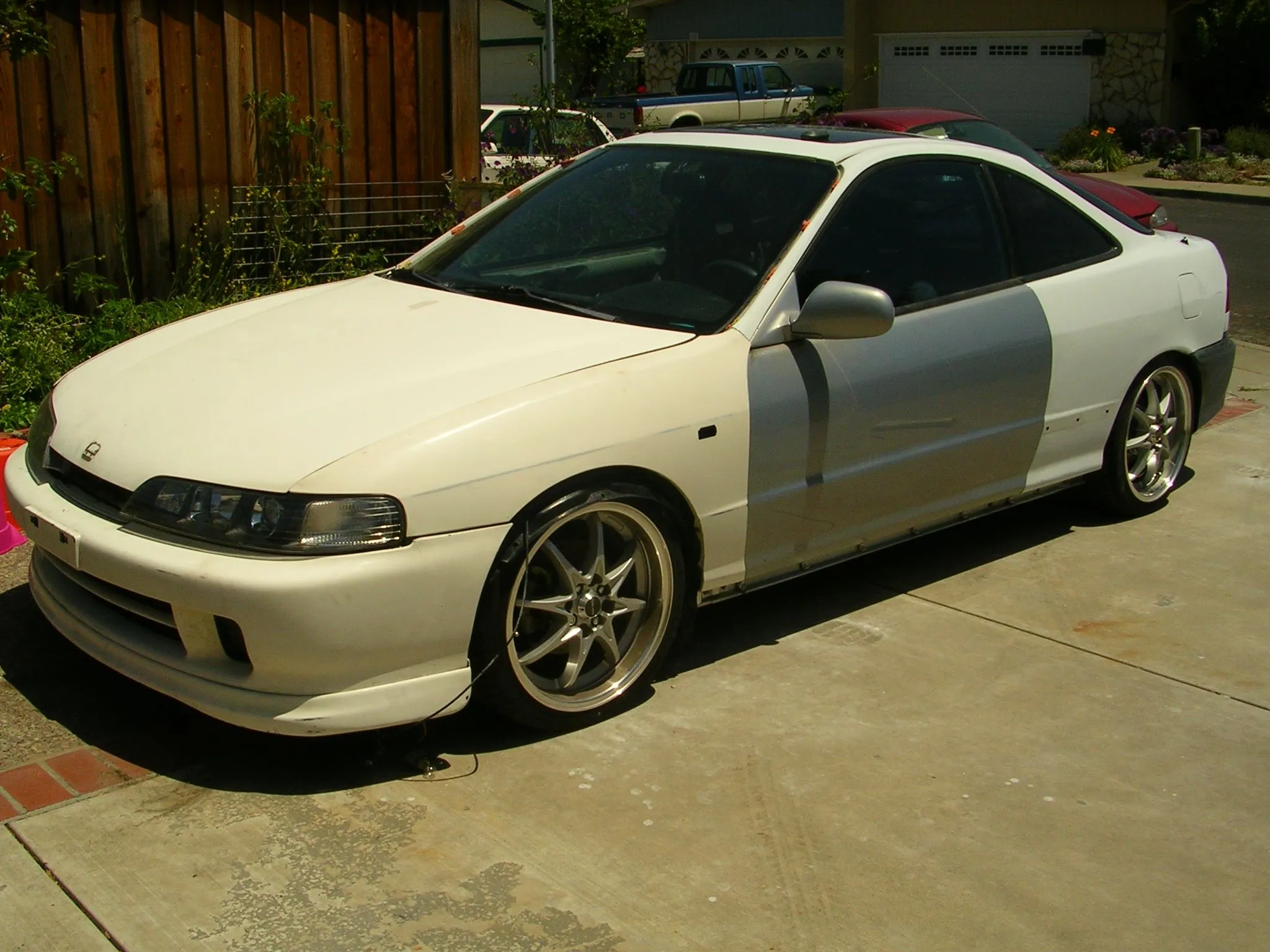

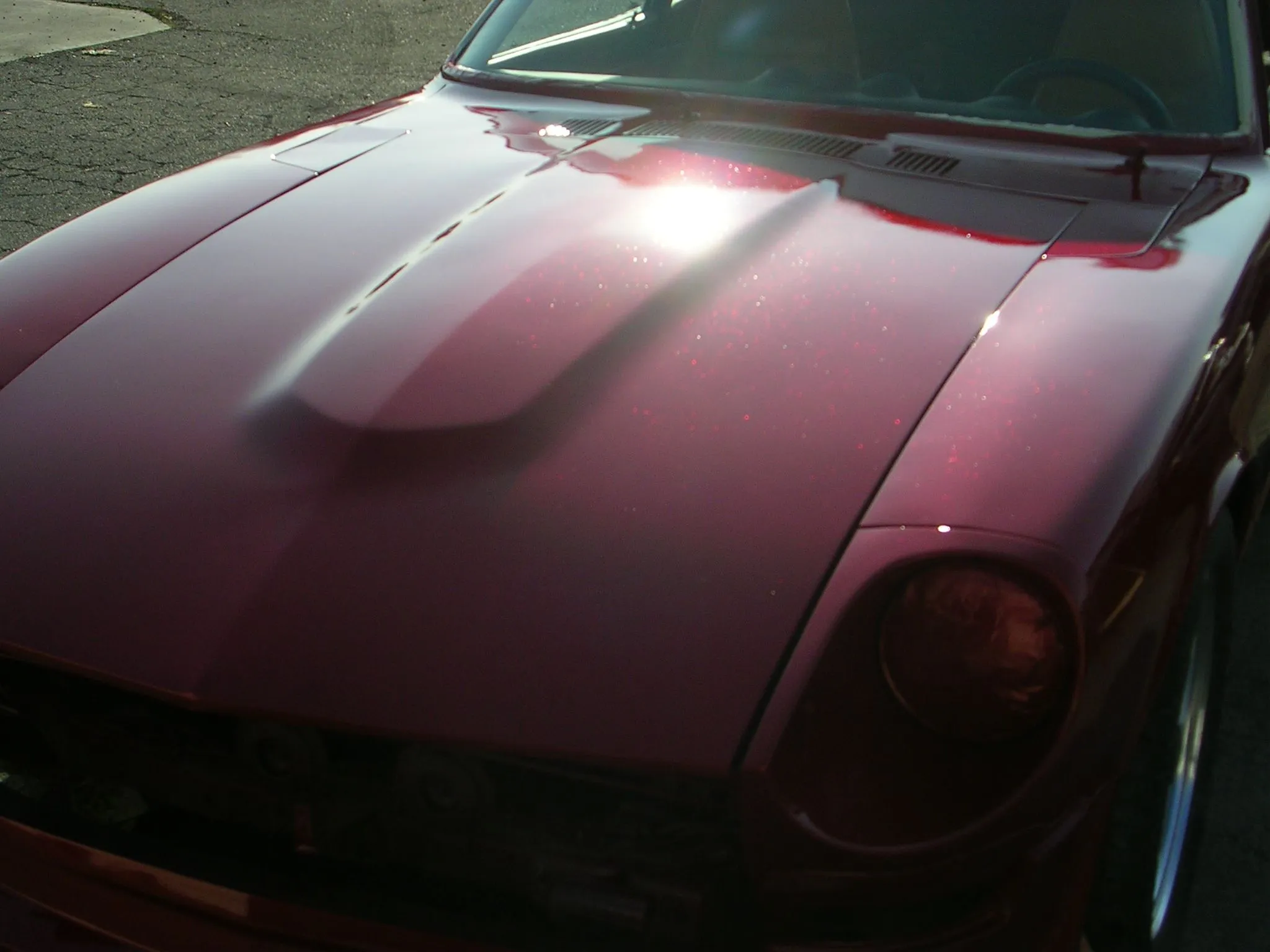

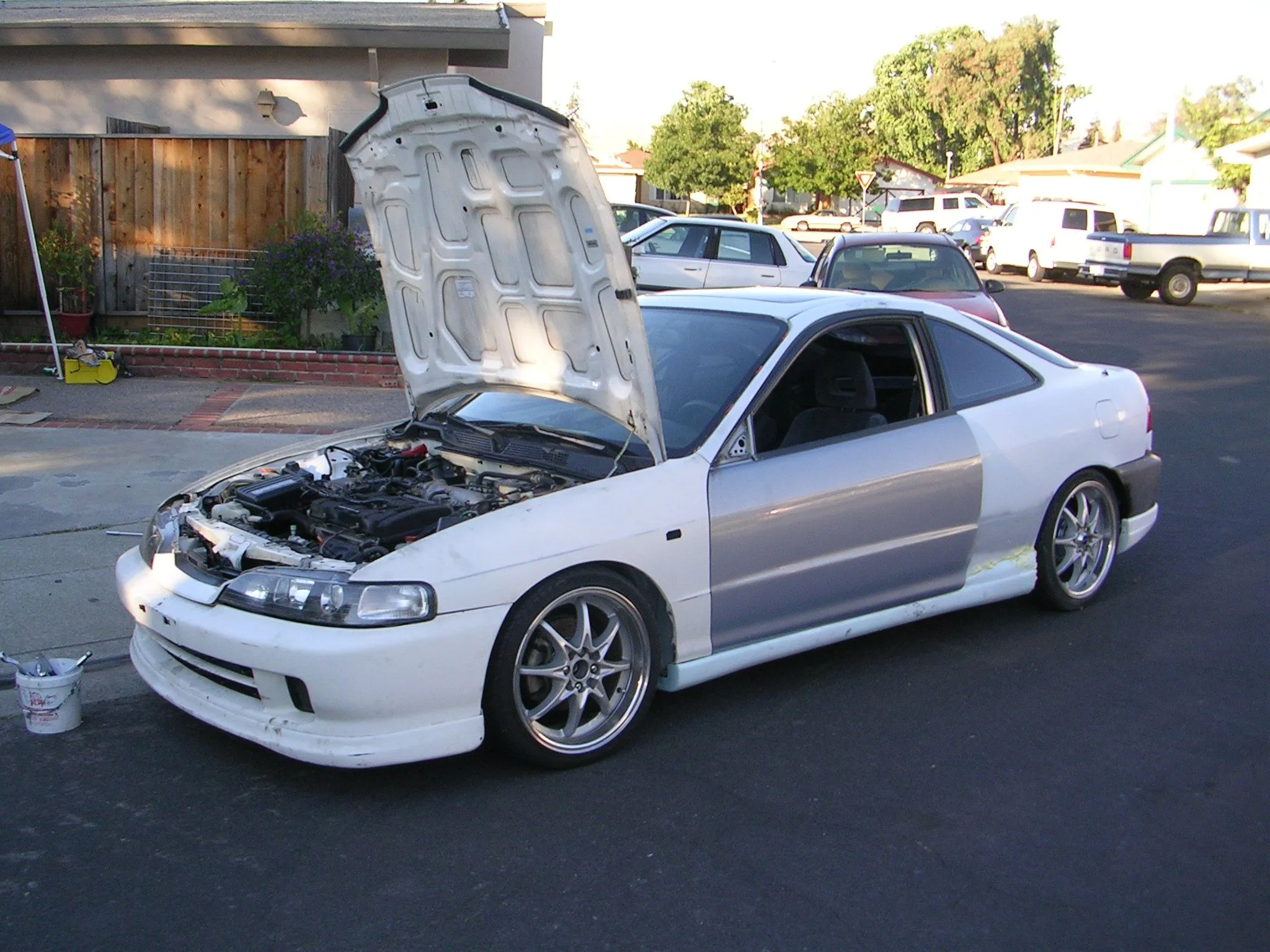

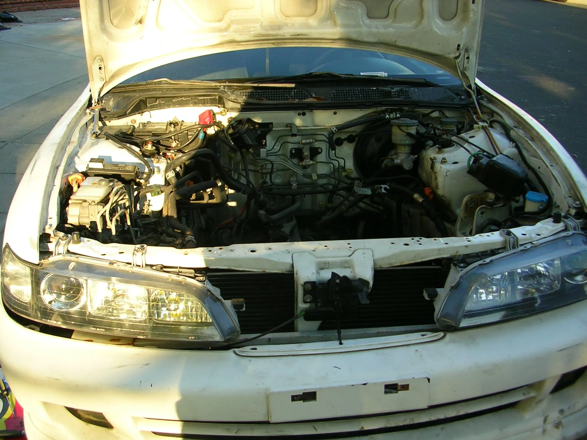

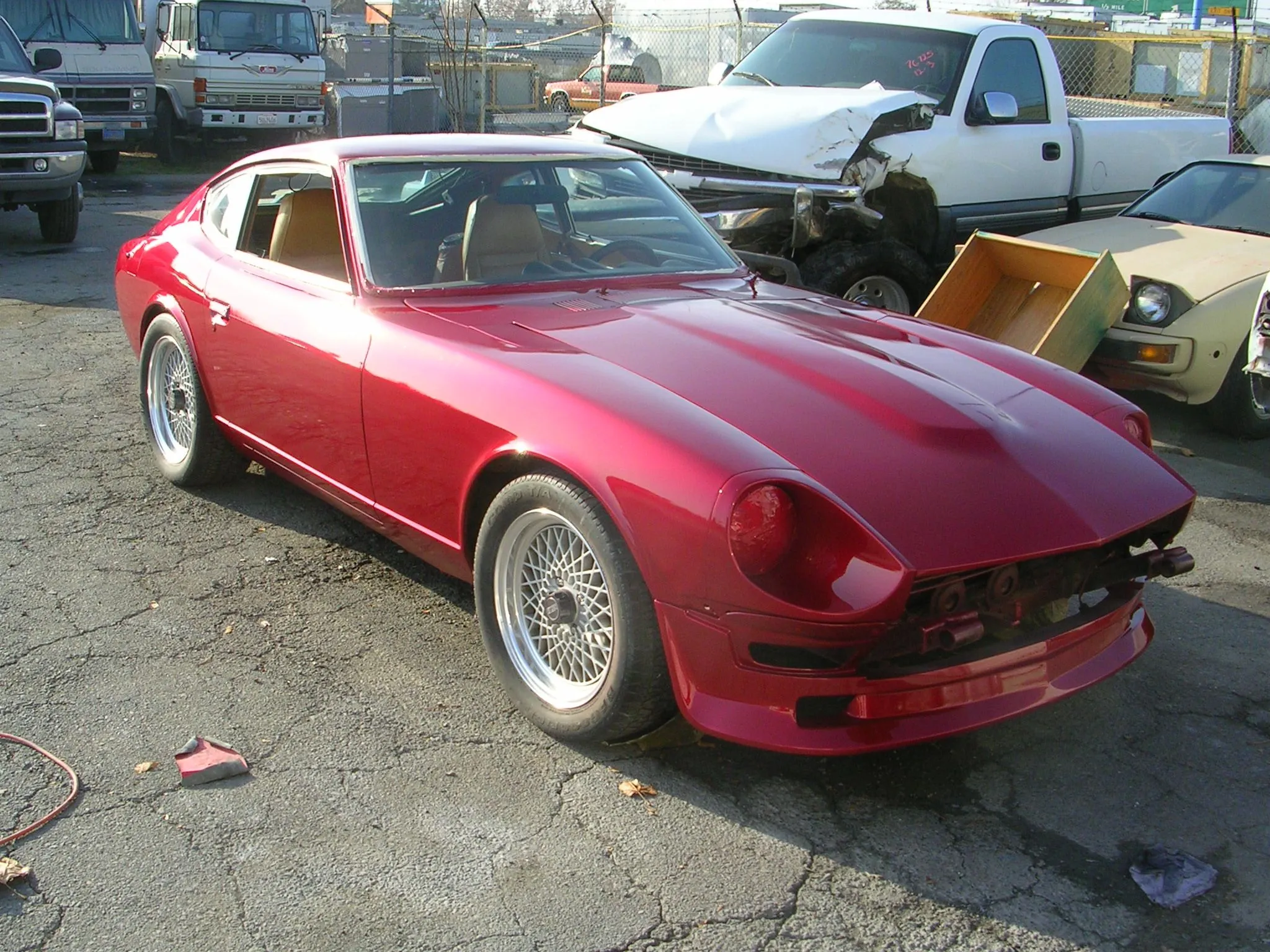

See that Z in the back now it looks like this.. and the integ is Steve's Garage next project..

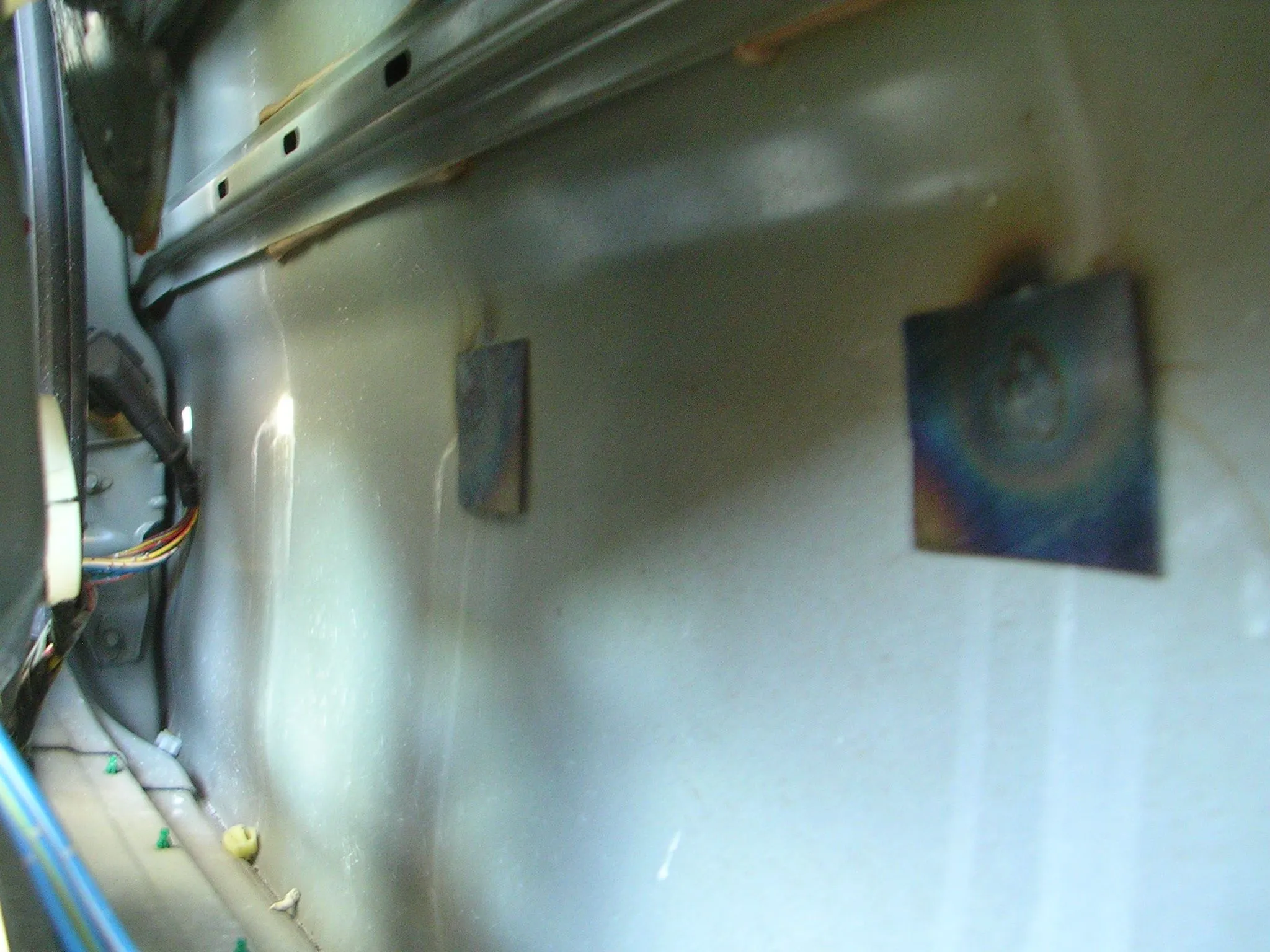

Welded Everything. Door molding holes, spoiler holes, and door handles.. Jdm Front also added for this integ.

dude how long does it ususally take STEVE to weld those plates on the door handles? i wanna shave all my handles and rear .

It doesnt take that long i would say about and 1-2 hrs to TACK the sheet metal on the all 4 doors. Just take your time and be sure your always cooling the TACKS down because you wouldnt want the door to get hot a warp..A wet rag will do the job.. But now shaping the door with a light over coat easy sand bondo can tke some time b/c our door handles are at the body line, so there for you have to make a body line...
