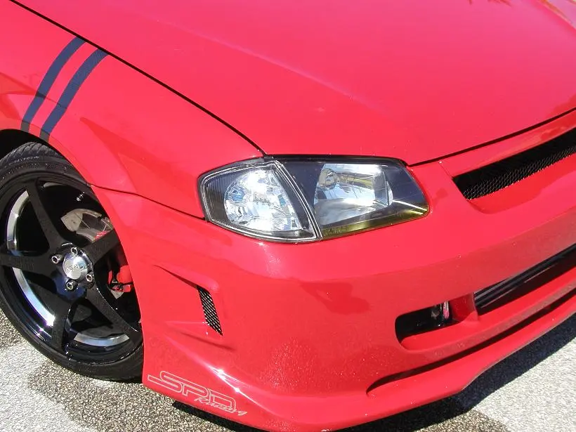

pics of my boosted 1.6L protege
dude... wtf ... when did you do that??? lol how did the intercooler fit behind our bumper?? any cutting?
there was a lil bit of trimming involved ... let me find the best pics showing that

heres one ... best i can do right now

and by the way i have no bumper reinforcements and the bumper was chrimmed to fit the fmic ... 22 x 6.5 x 2.5
SedanMan said:
It sounds like you are talking about the intercooler. It's not a grill.
no, he is talkin about the upper part of the bumper, on a stock bumper you can remove the upper half .. the section with the symbol in it.. on a erebuni front end it is all one piece..
