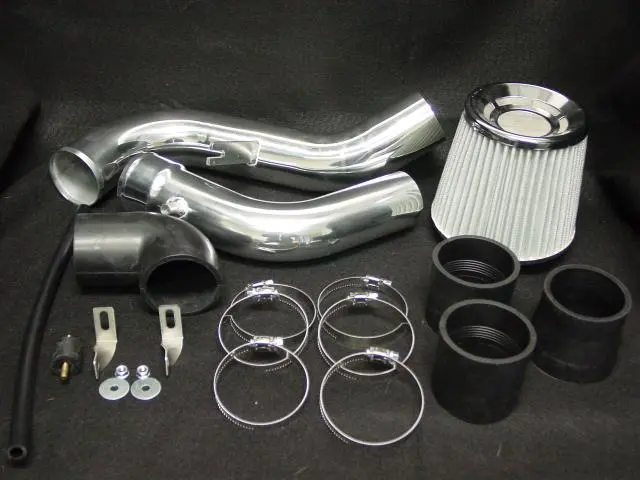

Could everyone with cold air intakes please post pics of their setups? I need to install this ebay cold air and I have no idea how to even get started on it.

btw, this is what im working with..
I know ive seen pictures of this one on here before.. but I cant find them.

(Starting at the TB) 90 degree rubber elbow, pipe with plug for vacuum hose, rubber coupler, MAF, coupler, pipe with mounting "tounge", coupler, filter. :)
Tip: Put it together first(everything but the filter), then fit it into the car.
Tip #2: Don't take off your bumper to install it. Just unscrew the retainers that hold the plastic liner onto your driver's side wheel well. You can fit the filter in that way if you turn the wheels all the way to the left.
It's a cp racing one that I bought from EssentialSpeed. :)

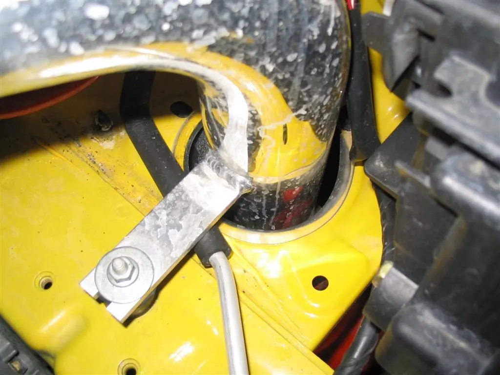

I installed a rubber hose around the panel opening where the piping goes into fenderwell. In hopes it doesn't rub against the metal.

DeanSweet said:
anybody else have the annoyance of the thing whistling while running at parking lots speeds? Mine is really loud?
hmm, i've driven at slow speeds with the window down and haven't heard the whisting noise.
i did the same with the the hose around the fender hole.
