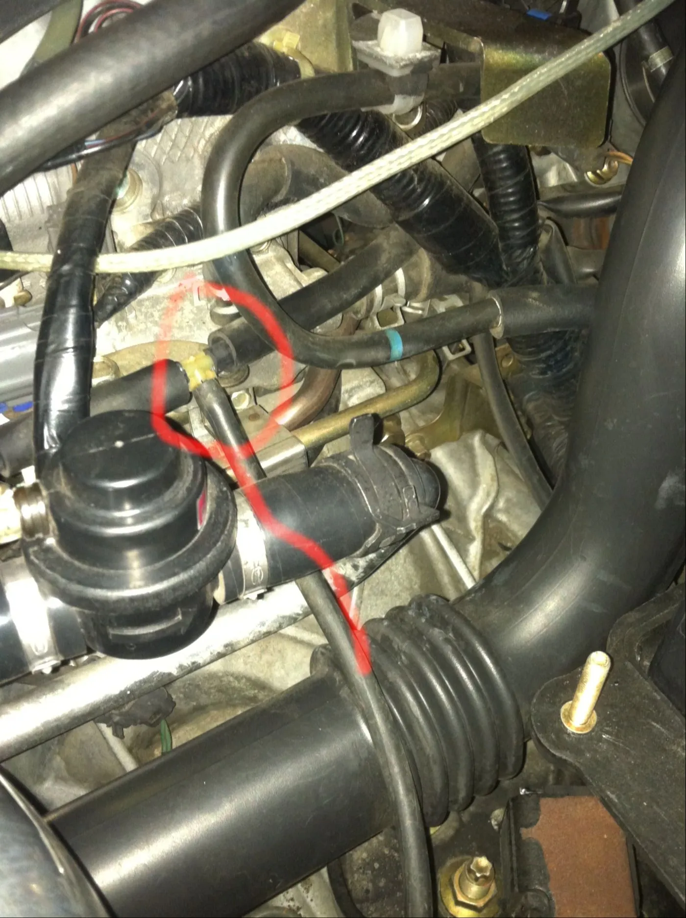

I've had several vacuum leaks (Not surprising) so far including intake gasket - Fixed )--intercooler pipes (which are stock) and I am almost 100% certain my WGA is bad since I can blow through the line and hear it hiss from the turbo/wga area, so my question is in my picture is this the line i should blow into?
Thanks if anyone can help point me in the right direction!(bowdown)

Nice car. Looks just like mine. That is the correct line. Double check all your lines while you're at it. I bought my car three weeks ago and ended up having to replace those. They were stiff and brittle yours look better I'll give you that so you might be Ok. His many miles on it?
Yes that is the line, and since your wastegate is blown with it still being hooked into the system that's a continuous vac leak... I'm currently in same spot you are with the wastegate... I unhooked that line from system (if you do watch your boost gauge if you've got one) and no vac leak codes yet... Just stay outta boost until you get a new wastegate... Car looks awesome btw...

Thanks for all the feedback i appreciate it! Is it a good idea/safer to plug the WGA hose instead of letting it leak? I have a boost gauge and I do idle at like -24 vac with AC off and with it on my vac sits at -19-20. My car runs great until it warms up then it slowly starts losing power. i know it could be cause are stock tuning too from what I have read. Almost forgot to mention after boost my rpms will nearly stall the car so thats why I first had the idea of my bad WGA.

Looks like you still have stock manifold, check and see if the studs are backing out...Also check your MAF, might not be a bad idea to pick up some MAF cleaner ... I've got my wastegate plugged until I can put the new one on... Like I said before if you do plug the wastegate watch the boost gauge bc it will easily climb to 15psi or higher (this is very bad for the motor)...

If the WGA diaphragm is leaking it will cause a vac leak which can make the car stall when you press the clutch. You lose power due to the heatsoak in the stock IC as well as the rich factory tune. SSAFC, FMIC and catless exhaust will do wonders but replace that WG with an ATP T25 wga from ATPturbo.com ASAP you don't want to plug the line and risk blowing it up.
hornsfan10609 Yeah, it's absolutely leaking. I did another test and sure enough I could hear the air blowing out. :( debating if I should change the WGA myself or have some help, but will see! Bummer I was about to buy my IC pipes from Corksport here in a week but it seems the WGA is a little more important . ATP WGA for sure and okay will not plug the line. as far as a catless exhaust wouldn't be a great idea since my state is really strict on Emissions and such even though i know theres ways to get around it.
ps: what should my Vac be reading?
I'll report back in time about my progress :) Cheers!
Vac will be 22-24hg at idle, and dropping some with the AC on is normal. A wastegate is something you can replace yourself it is not that difficult to do.

replace your wastegate first THEN look into the o2 sensor. some vehicles in general will throw more than one code due to the first code being thrown

Thought I'd take a photo of the new atp wastegate 6psi. In hand it feels sturdy. Can't wait to put it in!
*Update* Installed the new wastegate today,and wow I cannot believe how much power I gained from it!
