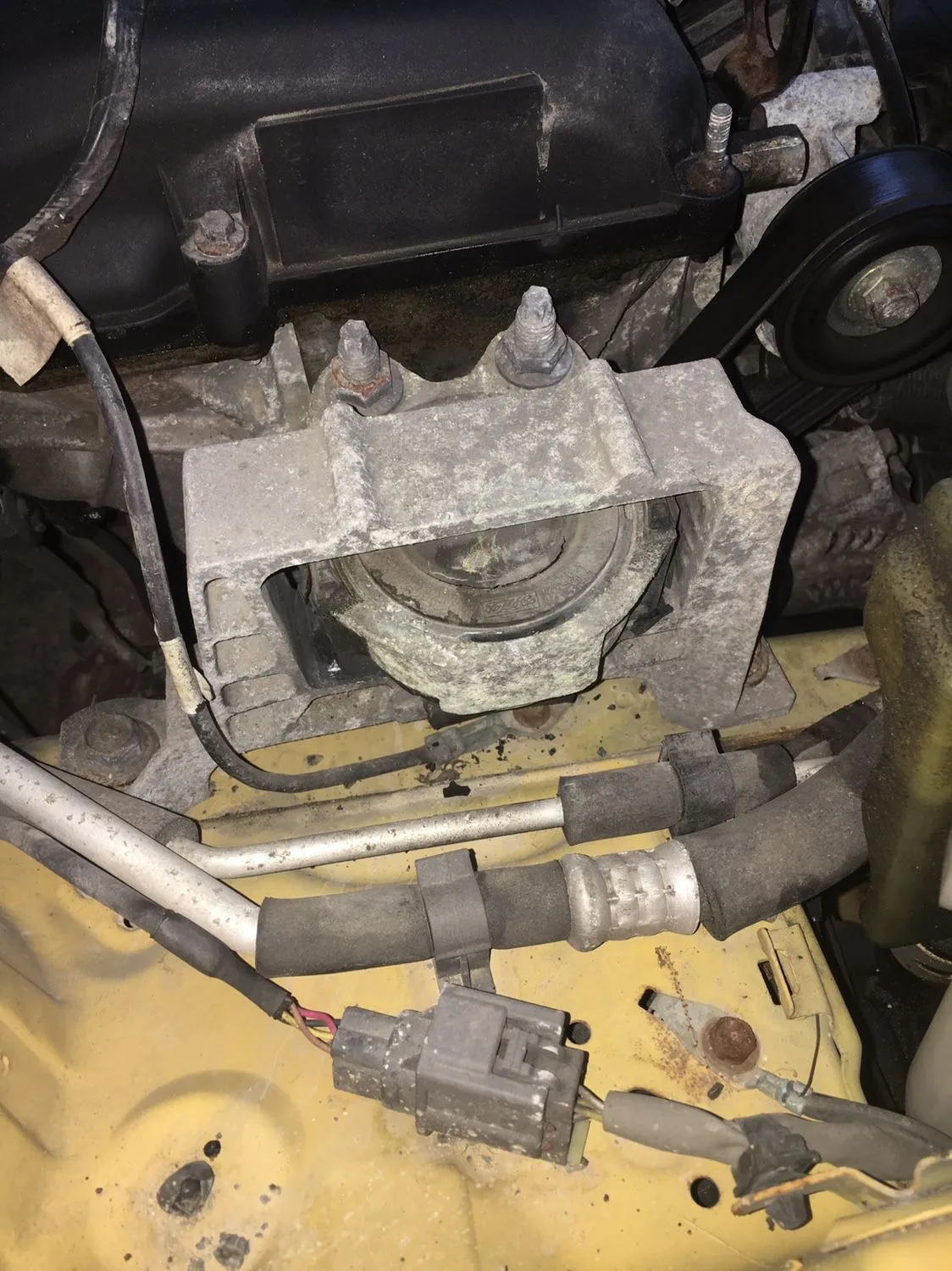

Im hoping this PMM is the cause of the clunking in my 2004 2.3. It says FoMoCo so it could very well be the original with 194k miles on it [emoji31] Whenever I cold start the car or hit bumps or go above 60 mph I have a clunking noise from the passenger engine area. Ill replace this mount since it looks like its past its good days and hopefully thatll be the end of it. I plan to replace the others at some point once I can check them out. IMG_2376.webp
I just did all 3 this weekend.Passenger side was trashed, the other 2 not so bad but they were old so they got swapped too.
