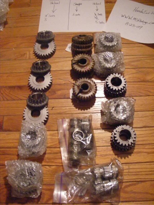

***I have several sets of brand new 3rd, and 4th gears from PAR, both helical and straight cut.

In the picture below is: 5 sets of *new helical cut 3rd gear. 3 sets of *new straight cut 4th gear. 5 sets of new helical cut 4th gear. Extra needle rollers.

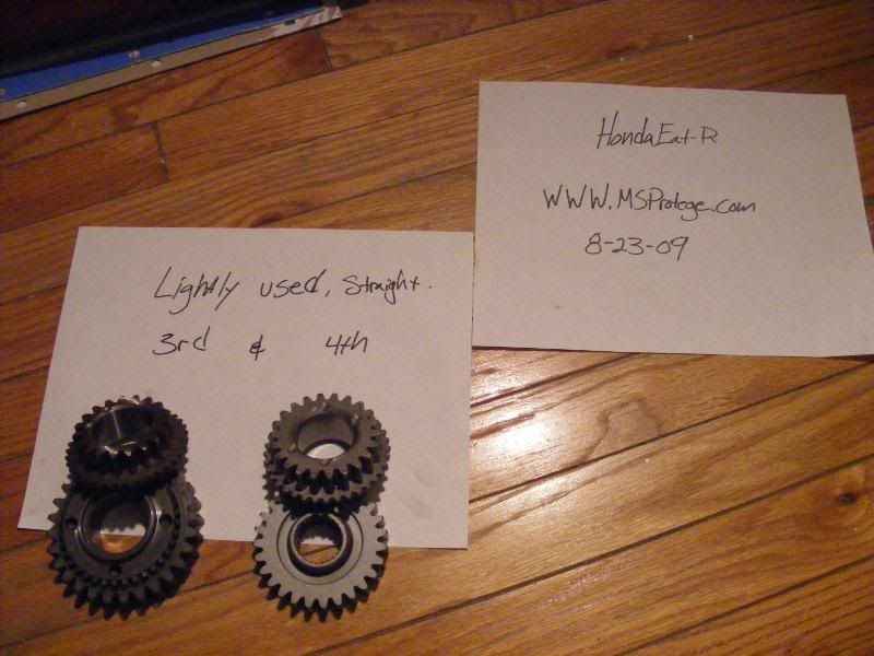

In the picture below is: A lightly used 3rd gear straight cut, a lightly used 4th gear straight cut.

You recommend not using these if your turbo, I plan on a 300hp turbo motor in the furture. Could I run your 3rd and 4th gears with a GTX 5th gear 0.795, or would I be looking for problems? The GTX 3rd gear is 1.233, your 3rd gear is 1.540 does it mean that the higher the gear the shorter it is I ask bcuz I dont know anything about transmissions. pm how much you want for the lightly used 3rd and 4th gears, if not I'll give ya $100 for both (yupnope)you tell me.
Here's the thing, I chipped a tooth running turbo on these. I can't say whether it was the gears fault, tranny was mis-aligned, clutch too rough, etc.. The gear that broke on me was used and the oldest gear in the box for what it's worth, and a original from the tri-point set. I have several new available as you can see.
As far as ratios go, yes the higher the number the shorter the gear. Better acceleration, less top end. These gear sets are perfect for NA cars, but worked OK for me (turbo) and people always loved the ratio. They just don't allow as full of a spool as the stock set due to how fast the RPM's change.
If you ran a .800 GTX 5th, once you shifted from 4th to 5th it'd be a serious over drive gear, but very doable and better than a stock Protege 5th for this application. On the street you could drive 1-4th w/ no issues, and obviously 5th on the highway.
