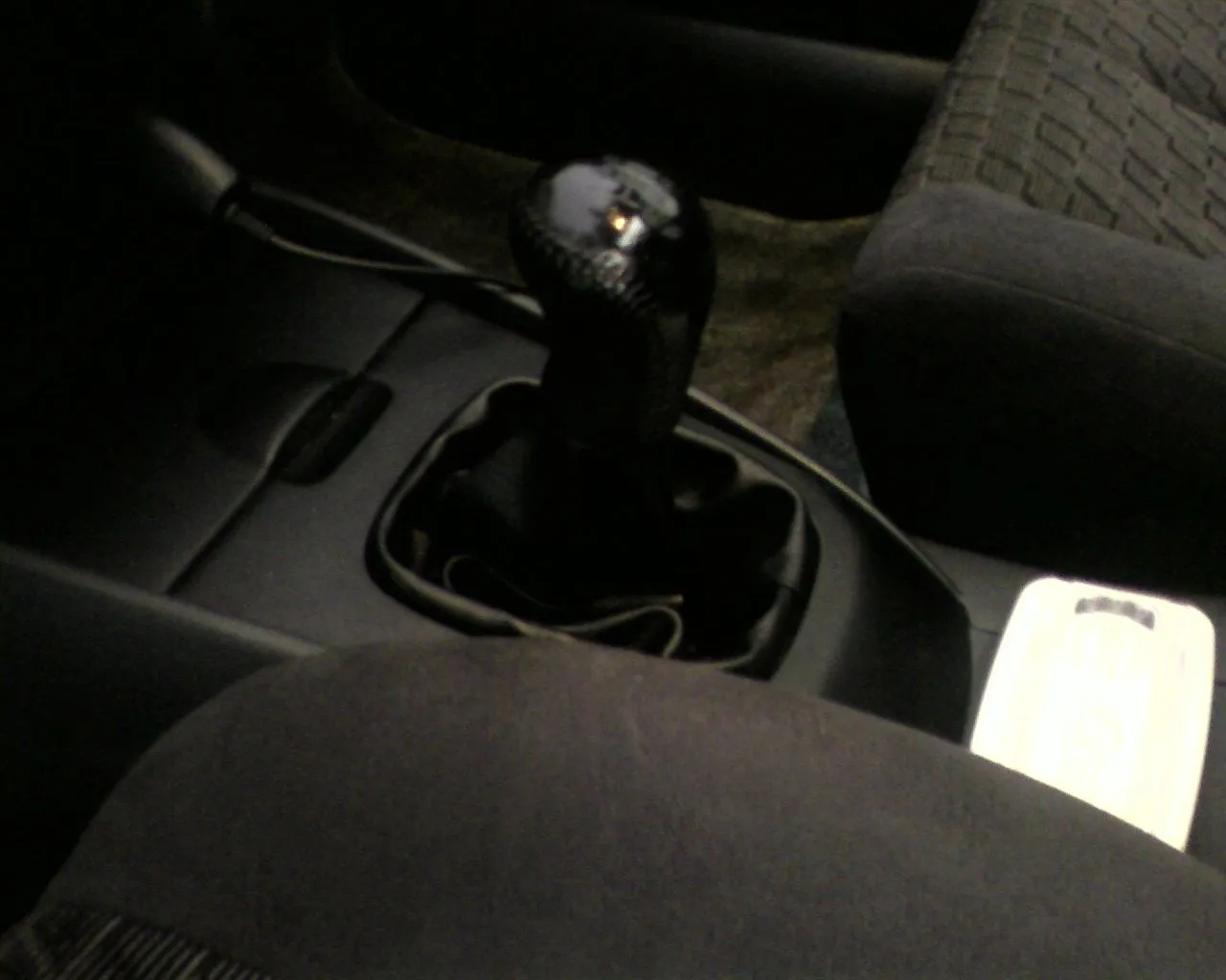

did this a while back and it does look alot better in all black. went a step further and painted around the shifter(from an 02, i like the lid) in black too. looks awesome to me. nicely done man!
