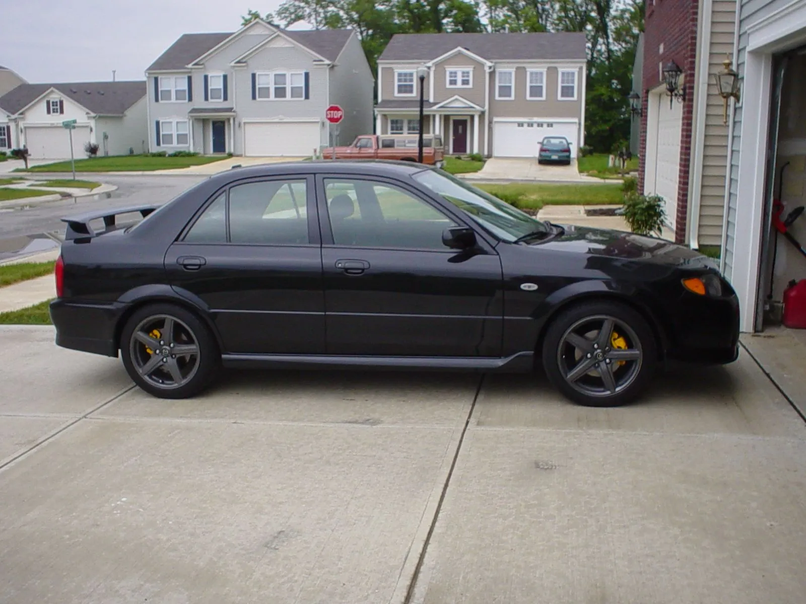

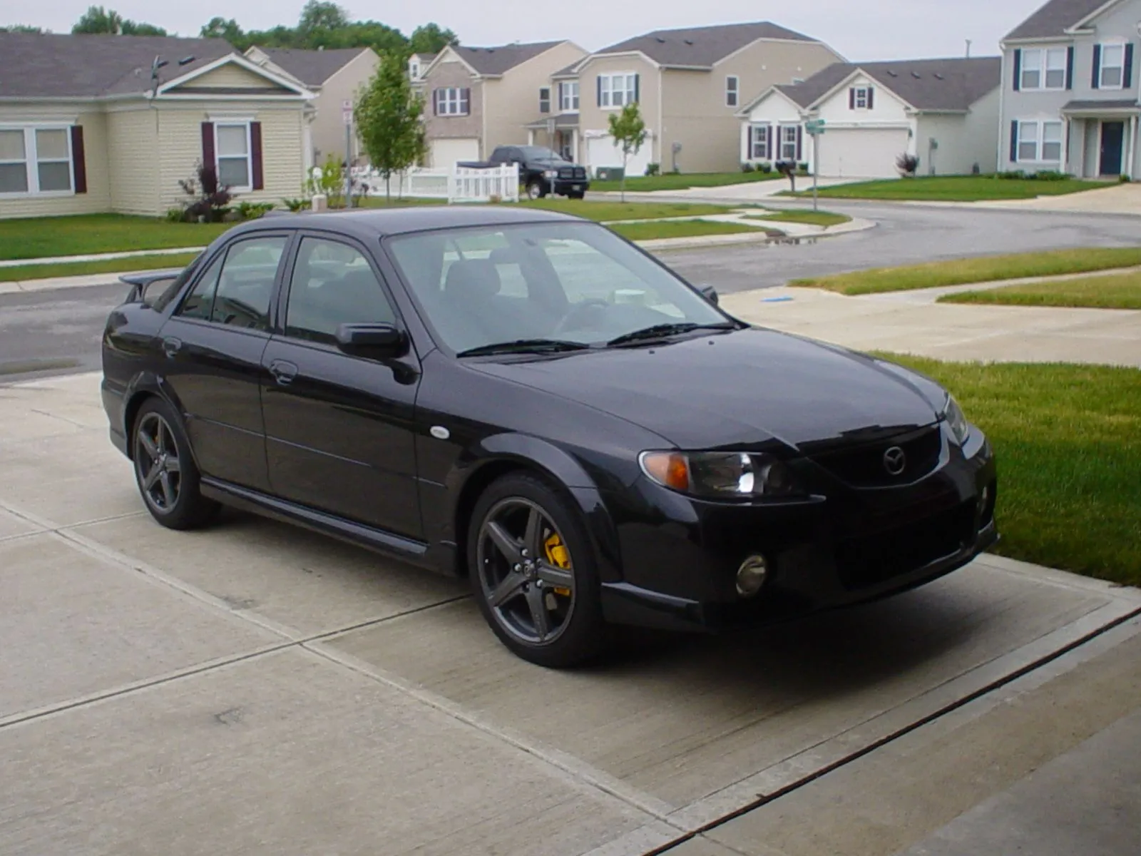

I painted my wheels gunmetal color, just curious to how you guys think it looks......I'm pretty happy with how it turned out......It will look better once the rain stops and I can wax her up and shine the tires real good

that looks great i love darker wheels.
i think you should leave the tires dull. i think darker wheels with dull tires look awesome. even stealthier.
looks great thats the same color Im looking for. What paint did you use? How longs does paint on the wheels last?
I used the dupicolor wheel paint, graphite gray color.....
I did 3 coats of paint, and 3 coats of clear.....
I'm not sure how long it will last, I've never painted any wheels before
it should last like close to a year prob longer (i traded the car before they ever started chipping) if you keep the wheels clean, i've used this paint on a number of rims works great as long as you keep it pretty clean especially through winter with the salt and all...wheels look great!
peace
dante
Looks really good! I also think the caliper color looks out of place...but if you like it, and are going for a yellow theme, then by all means keep it. I just love the way red calipers look on black cars.
yeah, the yellow looks better on silver wheels. I didn't like they way it looked at first, but It grew on me, I would like to do some yellow in the interior, maybe some dash pieces, and some seat covers with yellow inserts. I'm looking at some wet okole cover they look cool and are not terribly expensive compared to leather....
