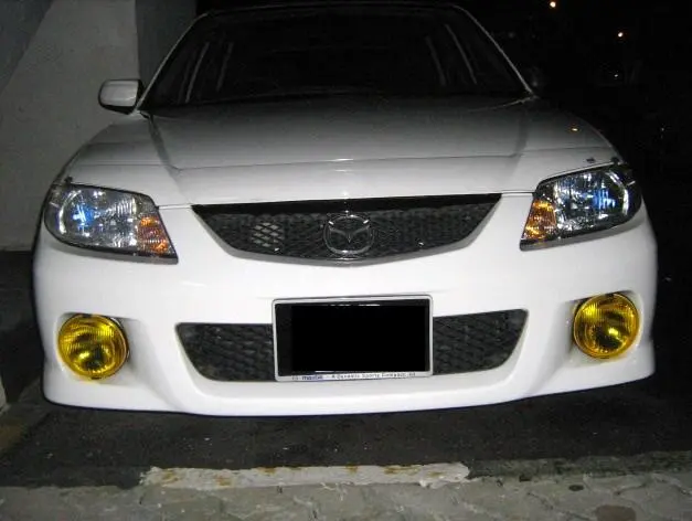

Guys.. how big is p5 fog lite? 5 or 6 inch?
Found decent price p5/sports20 bumper but without fog light, looking for universal fog lite.
Thank you.

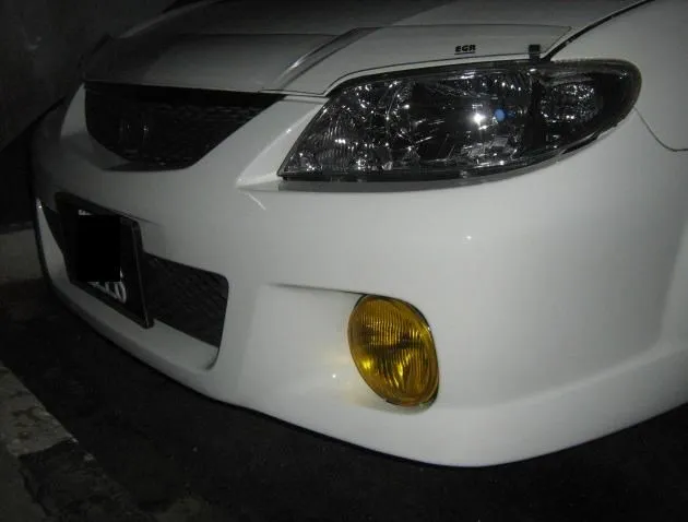

picture updates. Sports20/P5 bumper with 6' fog lights. Failed to find 5 1/4 or 5.5' fog light in my area it either 5' or 6' so i go for 6'.

I just don't feel the big huge yellow lights
if you want yellow lights, why not just use yellow bulbs with clear lights?
Very nice.... Did you take step by step pics??? Doesnt look that hard.... I will be getting my new bumper in about 1 week.... Ill be doing the exact same thing with yellow lights........
Mad props.........
thank you for our comment, i think clear lights gonna make my car look dull. heheheh
white cars "look dull"
yellow fog lights already ruined the clean look of that car.... it doesn't match! it only does the car justice by having clear fog lights with yellow bulbs!
