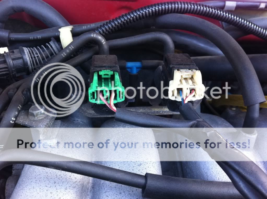

I only had a multi meter at the time. So i checked both solenoids for fun... OHMs and Continuity. it was weird because the green one beeped when test for cont. but the white one didn't beep...
Green 41.1 ohms
White 17.8 ohms
Im going to do the vac test on the solenoids on monday.
The green one is for VICS. At this point the easiest test would be to swap them and see if you get a VTCS-related DTC (P1569, P1570).
