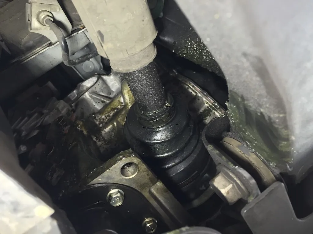

While installing the fumoto valve today, I noticed that both left and right inner CV boots seem to be leaking. I cleaned them up and checked for cracks and/or tears. I found no damage to the boots but noticed they seem to be leaking from the small clamp area(scratch). Any thoughts? Could the factory have overfilled them? Would this be covered under the powertrain warranty? My 5 has ~46000mi.

So far local dealership says this is not covered under the powertrain. Quoted me $875 to repair.(mad) Anyone else had experienced this? How much was it to repair?

Another thing to consider is that the car is lowered and I do not know if that would affect the coverage on the boots. Dealership wants $70 just to do the inspection to determine if they may cover it even though they have already verbally denied it.

This is common and a wear/tear item but that is premature for them to fail, especially for both at the same time. If they refuse warranty you can purchase both axles new for about $100 each and replace them yourself.
I had a related issue in my 2007; I was finding grease splattered on my rims and the mechanic said it was coming from the CV joint just slinging out of the boot (during hard cornering) even though the boot was in good shape. They said there was still enough in the boot not to worry about it and apparently the boot was designed to not be completely enclosed.

Lowering your car puts the CV joints in an angle that they were not designed for continuously running at. I would guess that Mazda may deny any claims due to this modification. If it is not hard, you may want to put your stock springs back in before going back to the dealer, unless you are using coil-overs - probably too much work. Good luck.
Kinda figured that was going to be the case. Just going to re-strap the boots when I have some time. For the time being, I used some big zipties over the existing straps and it seems to have put enough pressure to stop the seeping. I also found some polyurea based grease designed for inboard tripod joints. I plan to add a little to the boots when I replace the straps.
