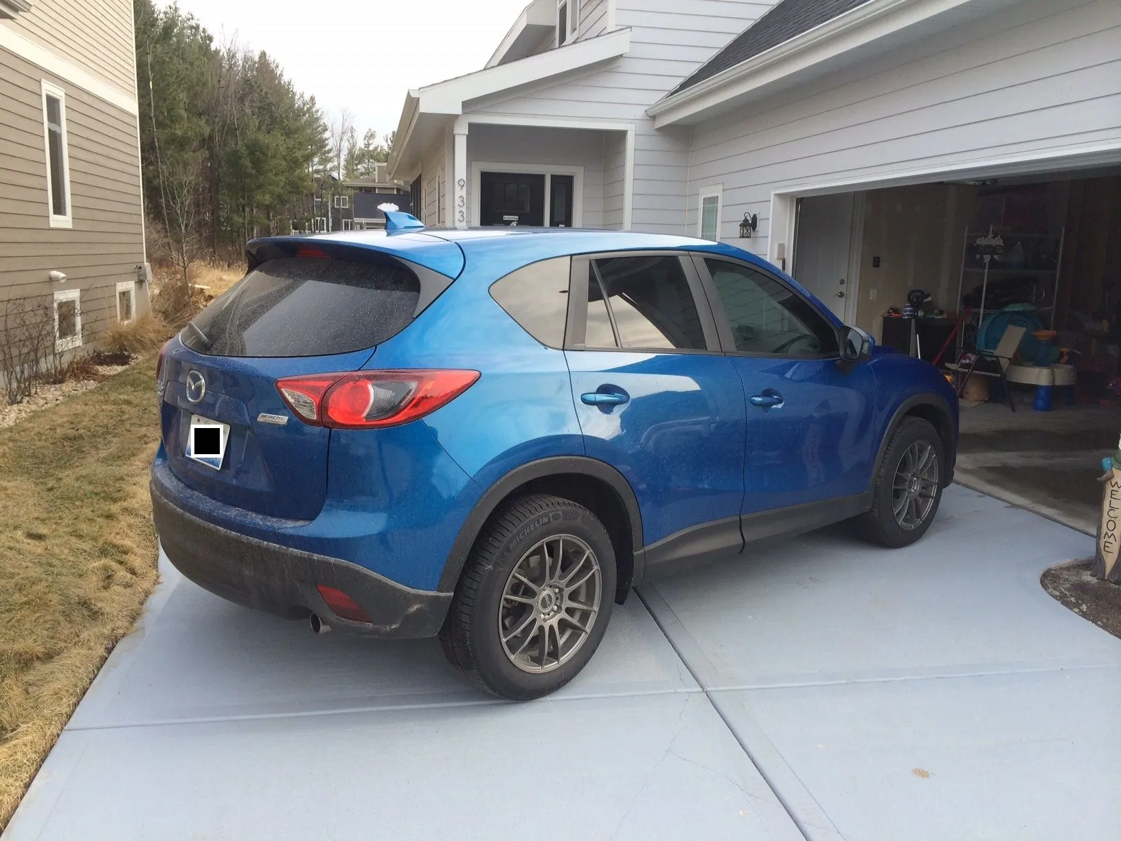

I have those on our CX5, its sky blue but maybe this will help. Also, I just ordered some black gorilla spline drive lugs since the lug holes are very tight on these wheels, might want to get those in advance if you go with these. This is our winter setup with some Michelin ice-x 3 tires, so far so good! Hope this helps, the pictures are kind of crappy only ones I have available right now. Just installed H&R springs and doing some other things so I will start a build thread once some other things are done!
