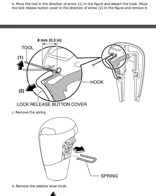

I believe the spring provides the tension for the button on the front of the shift knob. I found a diagram when I was trying to see if I could replace my own shift knob with one I had lying around at home. Let me see if I can find it again..
Nope, looks like I was wrong. Here's the diagram I found:
attachment.php
That's a screenshot from a gear knob removal PDF that was uploaded to this forum: https://www.cx3forum.com/forum/interior/7105-automatic-gear-knob-removal.html#

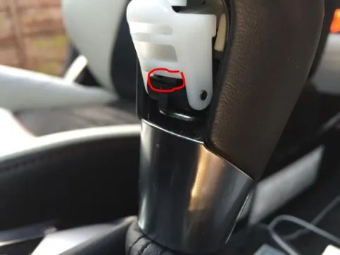

Actually, in that thread, Anchorman (who is also on this board) snapped a few pictures. In one of his pictures, you can just make out the spring that popped out of your knob. I circled it in red.

Thank you very much, sm1ke! Actually, it is a true spring (coiled) and not what Mazda calls a spring in that diagram and what is circled in the photo--that's to what I referred as the U-shaped "staple", since it looks more like that to me. This actual spring popped out before I even tried to get the "staple" out, so right in Step B of what you helpfully provided.

Yep, I saw the photo. So the spring that popped out of your knob isn't the same spring that I circled in red? Hmm. Wonder where it came from then.
Maybe I just can't see the finer details in the embedded and linked photo, and that's where the spring belongs...I just see what appears to be a black bar in the circled area. Probably my computer monitor. The location would make perfect sense.

I appreciate both of your input, as I think we are narrowing down the location this torsion spring came from and what it is used for. Maybe when I was using the small screwdriver to pull back on the button cover to disengage it I also accidentally hooked the spring at the same time.
Okay, so I saved that photo locally and zoomed in--not the highest detail enlarged, but it does appear that's the exact spring in question. Not fully clear on the actual attachment points, but hopefully it will be fairly obvious once I look more closely.
