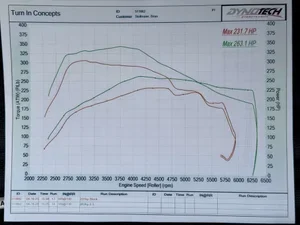

Has anyone upgraded their DRTuned, turbo, to David's Tier 2 tuning? What was the tuning experience like and what is the final product?
David's Tier 2 has been in the making for three years. This tune should release more of potential of the turbos. I'm about ready to pull the trigger on his Tier 2 package. The Tier 1 package is very nice at low RPM. The engine is about to make spool up and make power and the ECU turns off the power. I understand the Tier 2 makes much more power, over a wider RPM range.
Looking at the dyno curves this tune is rocking at 3,500 RPM! David explains the Mazda ECU is not making nice on their chassis dyno. So the curve doesn't accurately show the power.

What is the issue on the dyno?
Newer cars are difficult to dyno. Traction control thinks it lost traction, the trans shifts when it's programed, torque management is a tangled web and so forth. Dyno operators learn how to trick the ecu and tcu on other platforms. Folks chassis dynoing Mazdas are few and far between.
I have standalone ecu and tcu on my race car. These make chassis dyno sessions a breeze. No traction control. My tcu has a dyno mode that turns off torque management and shift rpm. It will wind the engine to the moon. Unfortunately our Mazdas have rudimentary tuning features. Thus this is a big breakthrough for our platform.
David talks in vague terms but reading between the lines he has issues like above and probably others.
I have thought about that before. Ideally you want to dyno in a 1:1 gear but that isn't always possible due to speed or automatic upshifting, etc. So with the Mazda you can use a lower gear if the correct compensation is used in the dyno software. And there is a combination of driving mode, manual shift mode, and certain gears that will bang the rev limiter and not upshift. I know because it happened to me once and really startled me. I'll have to test it again.

Oh and for dyno testing only, you can pull the ABS fuse to disable TCS. Just don't forget to plug it back in when you're done.

My car was the car used for t1 development and a good part of t2 before I sold it. The way the ecu uses torque targets against speed and load have a very difficult time generating the same load target on the dyno vs an actual road. Then add into the fact the AWD on the 3 is constantly trying to equal torque under load it throws a fit and sets codes during and after each run. It can be a very tedious process to get the same consistency on the dyno vs what the logs taken on the roads by multiple people have shown.

Unfortunately a calculated run from a log taken on the street has been the most repeatable consistent numbers between boost and MAF flow. On the dyno it varies terribly, the car just does not like being on one. For example when we dyno'd my car the stock tune would put down anywhere from 170-210hp depending on how 'happy' it was on the run, very frustrating. If we could find a way to put the car in a Dyno mode like some other vehicles I think we could see good repeatable results.
The issue with using virtual dynos is they are very easy to manipulate if those are your intentions. The EVO X community was kind of the start of using virtual dynos because of how notorious that car was originally to dyno.
Daniel, myself and a few others went through a good amount of data logs to get a correction amount on the same stretch of road in the same conditions to put something out we feel is accurate.
