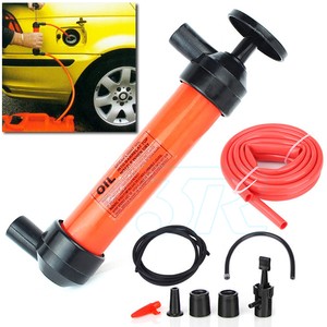

Do you have Fumoto oil drain valve? How many quarts of oil did you put in? Those watery 0W-20 oils sometimes is hard to read from the dipstick. It seems unlikely to overfill the 2.5L with 5 quart of oil even though the spec calls for 4.8 quarts. I'd use this cheap hand pump found at Harbor Freight Tools to suck some overfilled oil out to the Full mark through the dipstick tube:
