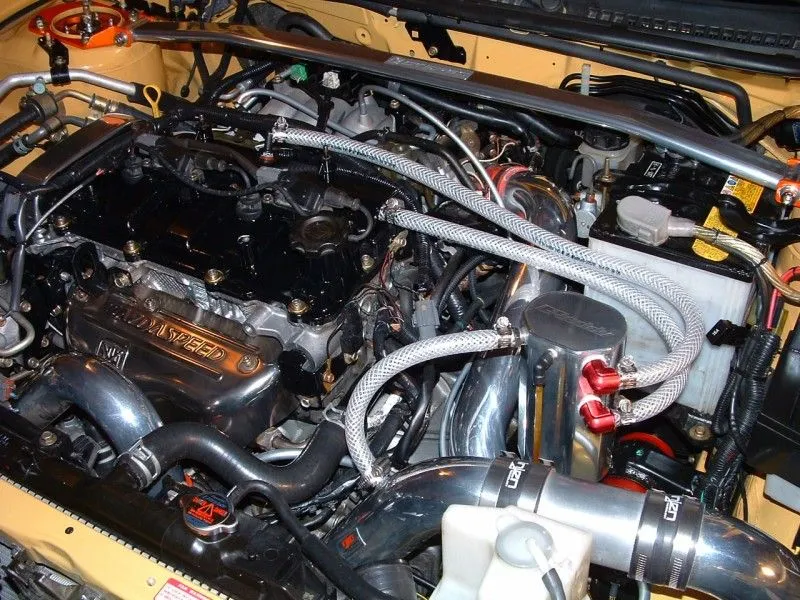

I have read the forums and still confused as F#@&! Everyone has a different opinion on this it seems...can someone please explain to me in baby retard langauge exactly where each hose from my square (older Style) Greddy catch can is supposed to go? PLEASE!! Lets not turn this into a fight like ive seen in other threads about the same issue, if you dont know then just read on...please dont guess. Thanks!
hope this help :)

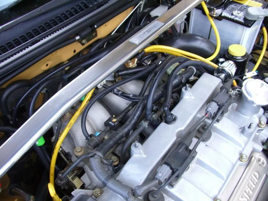

that is Daedalus' set up. here is mine (i have since then re-routed my catch can the RIGHT way) updated pics today...
Ryoga28 said:
Msp#735, I thought the greddy catch can had only two barbs.

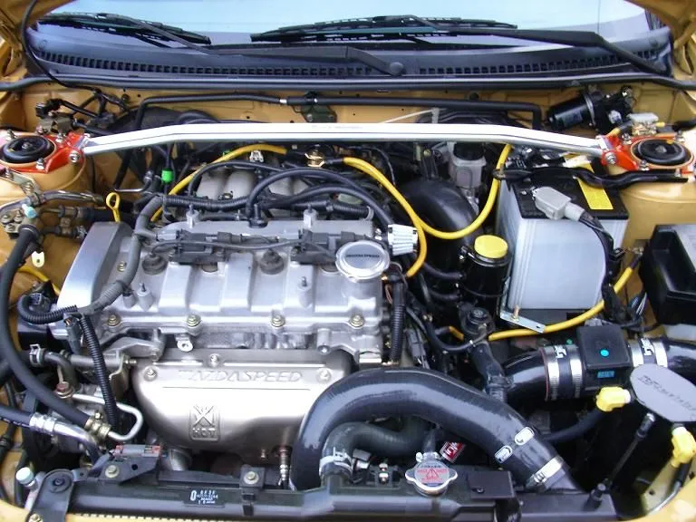

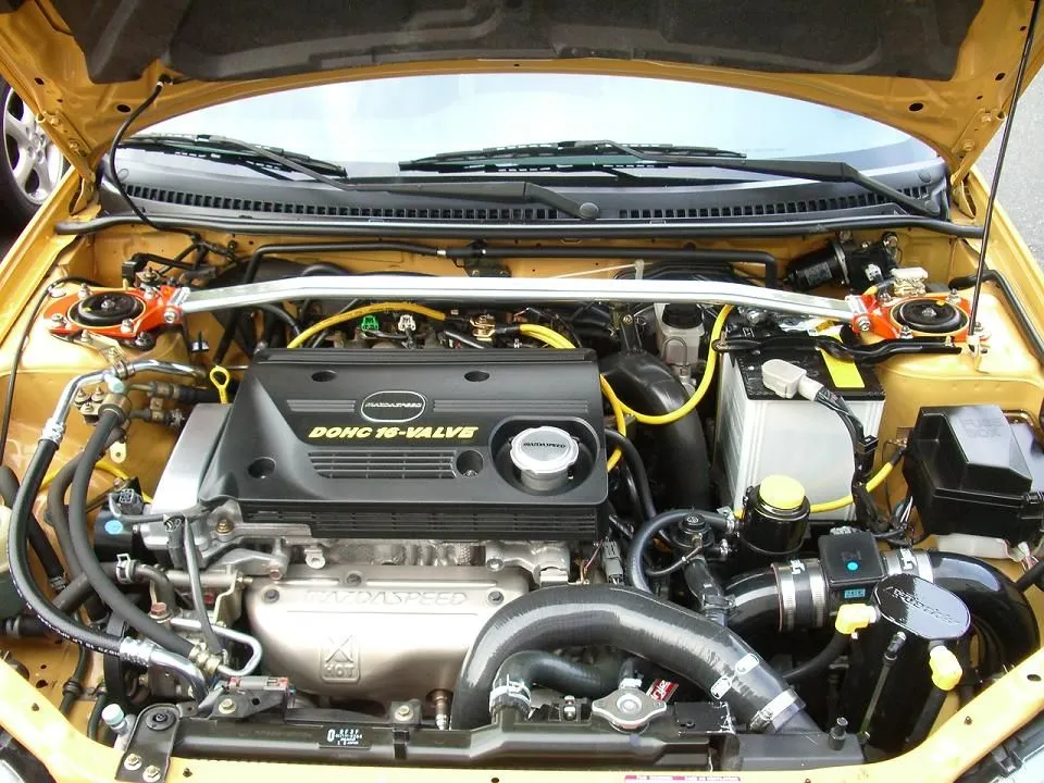

updated catch can/engine bay pics.
Ryoga28 said:
That setup is not the proper one...The catch can should be btw the PCV and it's vac source.

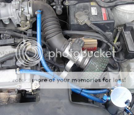

I use stainless braided hoses, but I also have mine hooked up between the PCV and the intake mani. I need to get proper hose seperators instead of the zip ties but they're $30 each. I'll look for cheaper ones.
While this isn't the "prime" way to do it, it ensures that my engine doesn't even burn any blowby even under vacuum. Read up on how the PCV system works in the other thread, buth here's a pic of mine.
Yeah, that is exactly how mine is set up. I wasn't asking how it should be set up, I was just wondering what kind of lines everyone was using. The lines I currently have get sucked closed after they heat up under vacuum. I'm just trying to find a line that won't get sucked closed under heat and vacuum (I'd imagine under boost they're fine). Not sure if I want to go stainless braided though...
