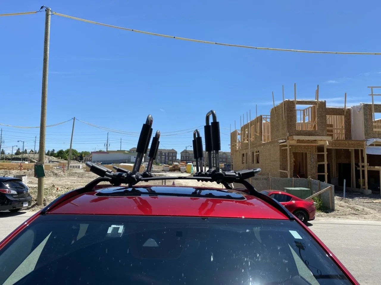

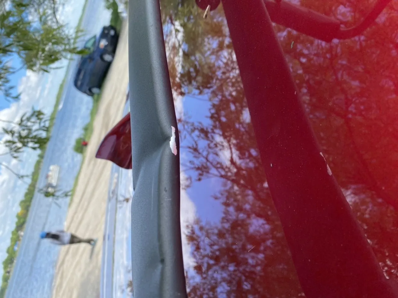

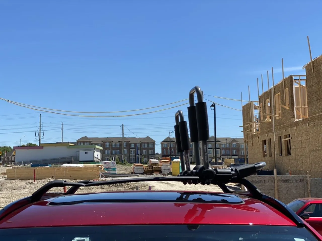

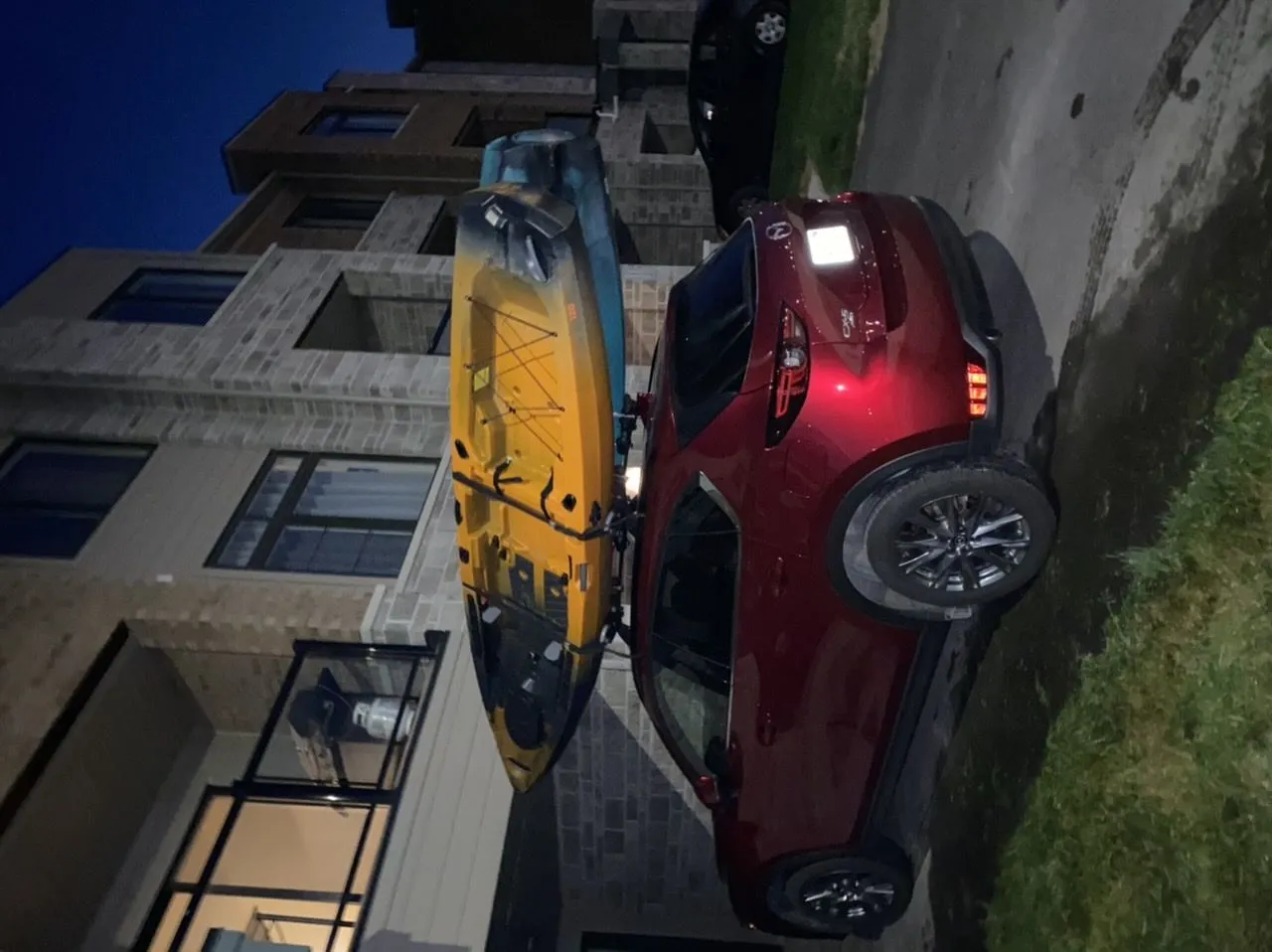

Do not bother with the aftermarket rails and cross bars. Installed them Monday on my 19 signature. Went to the lake today with the kayaks and had the Cross bars fail. They are not quality aluminum that is for sure
@IamMurphy did the rails and cross bars fail or just the cross bars? from the pictures is seems like the rails held OK.. but the cross bars definitely had a bad day.
The podiums are no longer sitting flat to the rails on the passenger side. I emailed the seller, they are telling me the cross bars are only good for 45 kg ( 99 pounds ) meanwhile they don't list it in their ad. It came with official Mazda instructions that showed 74.8 kg ( 165 pounds ) in the box. They asked if i wanted to receive replacement tubes but with the podium no longer sitting level to the rails I will need a full replacement to have confidence in loading anything on ti again and am waiting on a response.
If i hadn't of checked when I did it the kayak carrier would have made contact with the sunroof and the roof of the vehicle. I am lucky it wasn't worse but am extremely frustrated.
So the failure of the cross bar then pulled the roof rails inward.. this makes sense. Technically speaking I don't think the roof rails failed independently .. but they are now out of alignment due to the stress placed on them by the pull force inward by the failed cross bars.
