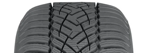

Looks like Nokian is releasing a new tire for the U.S. market at the start of the year. Looks interesting, for those needing a year-'round compound, siping and tread design capable of handling summer, rains and moderate winter conditions.
The tread looks a bit reminiscent of the Hakkapeliitta 10, and somewhat like the Michelin CrossClimate2 but with additional siping.
Nokian's blurb about the tire: Nokian Encompass AW02 all-weather tire. DiscountTire/TireRack is showing the tire. Only a few CX5-compatible sizes so far, at least for DT/TR. Uncertain if it's to be distributed in the U.S. by DiscountTire/TireRack only.
Nokian Encompass AW02 -- 12/32" depth, 65Kmi tread warranty, 3PMSF rating

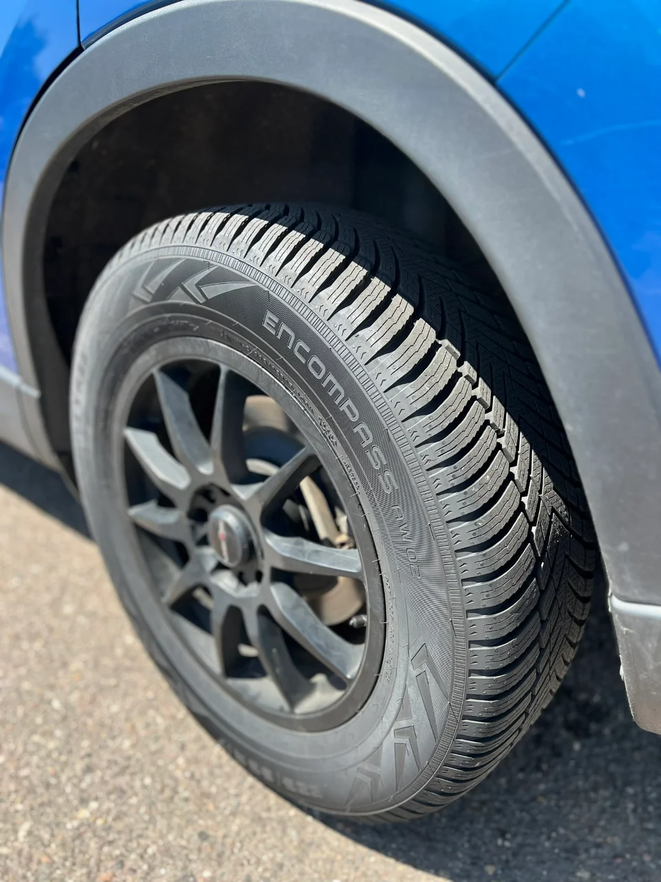

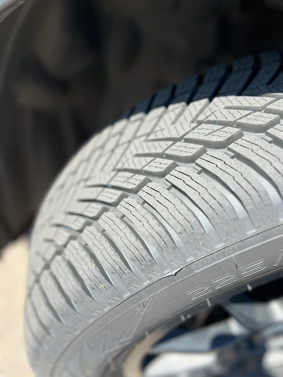

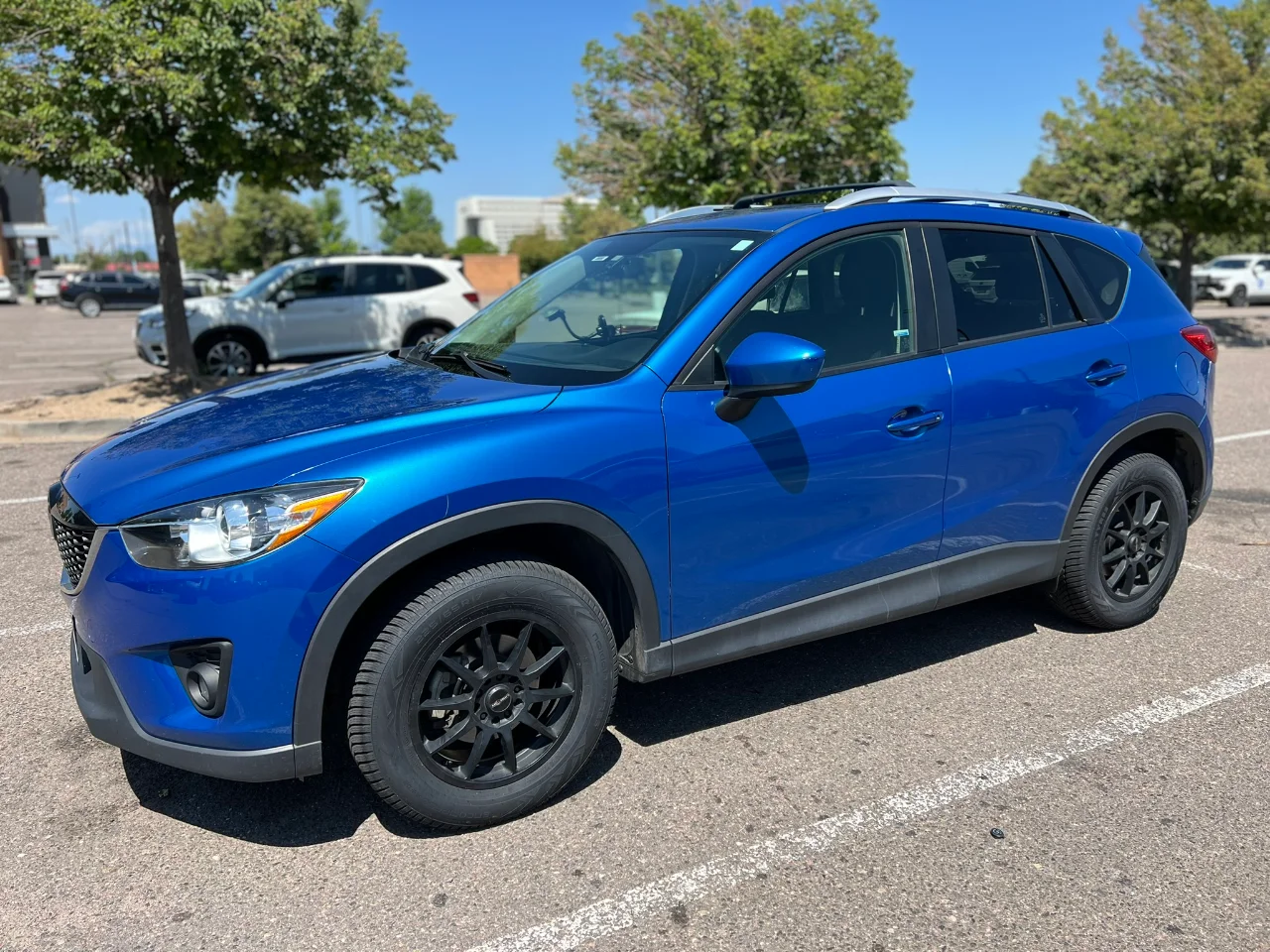

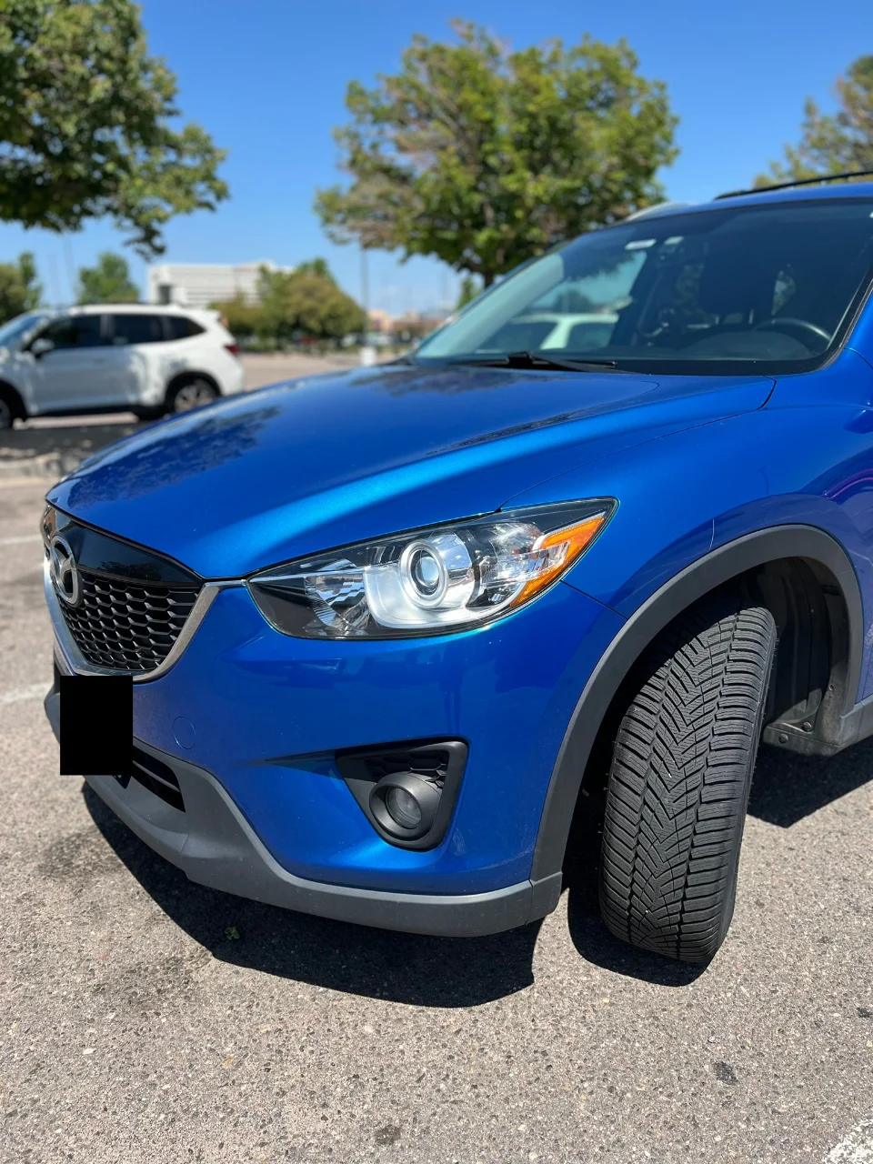

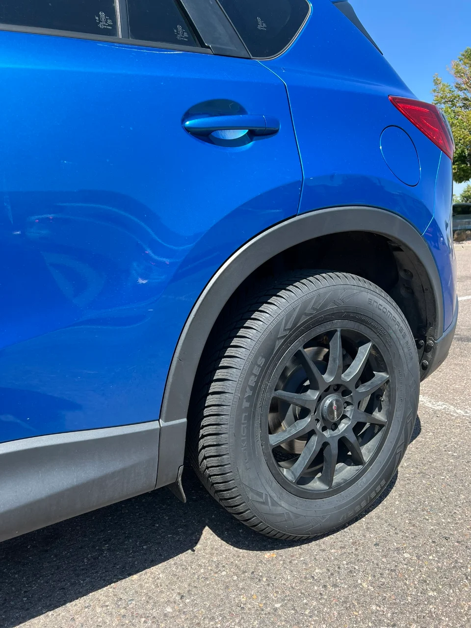

I put a set of Nokian Encompass AW02 on my 2014 CX-5 about three weeks ago.
First, I think they look great. I love the directional style of Nokian Hakkapeliitta tires so I wanted something for non-winter use that had the same look.
Second, the driving experience has been very good. So far I've driven these in wet and dry conditions on both city and highway roads with no complaints. They feel comfortable, grip well, and I have no issues on their feel. I have high expectations that they'll be very good for early snow before I put the winter tires back on.
Before these I had a mixed set of Nokian Hakkapeliitta R2 and R3 winter tires. This year, expecting late snow in Colorado, I ran them until May so I was familiar with driving them in warm conditions. They were more grippy than these Encompass BUT they were also worn down from 12 32nds of tread to 7 32nds and were run at a lower air pressure. I feel strongly that if I compared the Hakkas new to these at the same inflation pressure they'd probably feel exactly the same.
Because we get strong snow in the Rocky mountains, but not actually that much in the city of Denver, I thought about wearing the winter tires down and then buying these and using them year round, but the Hakkas are just too good in the snow so I'll reserve them for real snow conditions. Once the hakkas are worn down, I might just keep these year round.
For those in the USA: I believe these are made at Nokian's Dayton, TN plant which means they should be resistant to tariffs. These are only sold at Discount Tire or Tire Rack, so hopefully you won't have someone trying to charge higher prices "because of.." inflation/tariffs/magic.
For those noticing, this is a 12 year old 2014 CX-5 bought in 2013 with 111,000 miles on it. The wheels are aftermarket and overall the car is still driving really well, looks great, is fun to drive and soo much less expensive by maintaining it than buying a new model instead.
Disclaimer: I don't get any compensation from Discount Tire, Tire Rack or Nokian for this. I just want to share becuase this is a very new tire with few online reports about their quality and more specifically how they feel on CX-5s.
