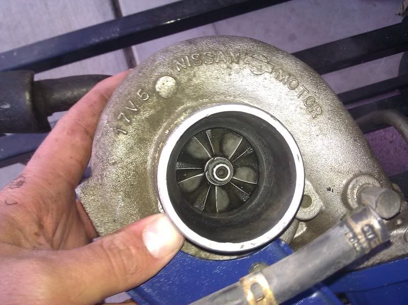

So I went look at the turbo and the serial plate was way to hard to read.all it said on the compressor housing was "17v5" and "nissan" I will upload pictures in a few. Just need help verifying what turbo it is
