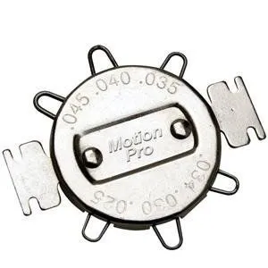

Right. You want the one with the round wire gauges, and the different sized slots that will fit the ground strap to move it back out if you tap it in too close with the wood block.
Something like this attachment. They are cheap. You can spend more, but no need. Make sure you get one that covers a range between about .025 to .035 with .030 being one of them. Just go slow and don't rub against the center tip, just check to see that you are just barely able to touch it with the wire and STOP. If .035 fits loose, you are still to big. If .025 does not want to clear the center electode, you are too tight and need to open it up just a little, etc.
Well. I found one at a local advanced auto parts with the round wire gauge but the lowest that gauge went was .040 so I had to get the coin. I took out my plugs and I used the coin and it was measured at .030. So they did come pre-gapped to stock. I started to tap on the the ground electrode a little but it didn't move and I was afraid of breaking something.. so since it wasn't at .040 I reinstalled it and unplugged the battery. I'm hoping resetting the ECU does something.. If not, I'll have to regap them to .028.
