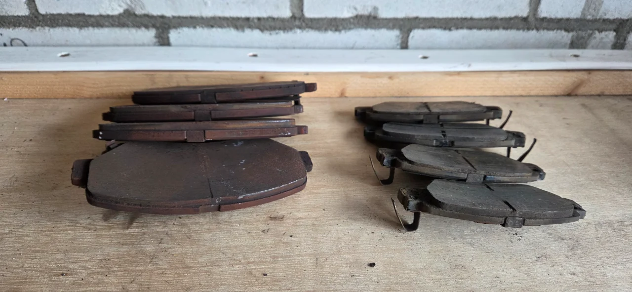

Well.....not a moment to soon.

They look pretty decent. Definitely a good time to install new. You can see a bit of uneven wear between the inner/outer pads. I think the inner is going to wear a little faster no matter how well you maintain the slides.
Good work DIY👍. Did you have any trouble with the "maintenance mode" or lubing everything up?
