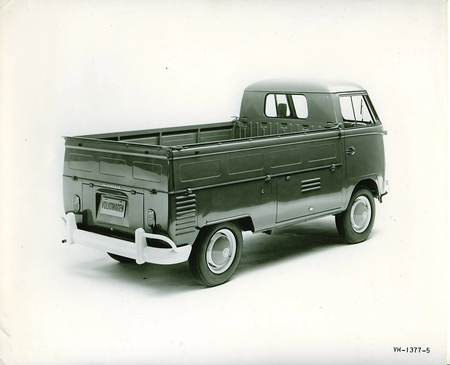

Hey, welcome to the forums! I too am an old bastard at 35 and a fan of old air cooled Vdub's. I once owned a '65 Single Cab for about 6 months. I was living in an old farm house that was converted into apartments and one day I was milling around the barn waiting for the delivery truck to bring my new washer/dryer combo. I happened to look in the barn and saw this truck and had to have it! I talked to the 85 year old landlord, but he was not willing to part with it even though it had not been driven in over 15 years. A year later, after I had moved out and bought my house, I ran into the guy and asked him about the truck. Well, now he was ready to sell, for $600! Long story short, I got it running, but it turned out to be way more rust repair than I could deal with, so I had to let her go for $1,200.
Anyway, welcome and enjoy. You will find the info you are looking for here. All you have to do is ask. (hi)
