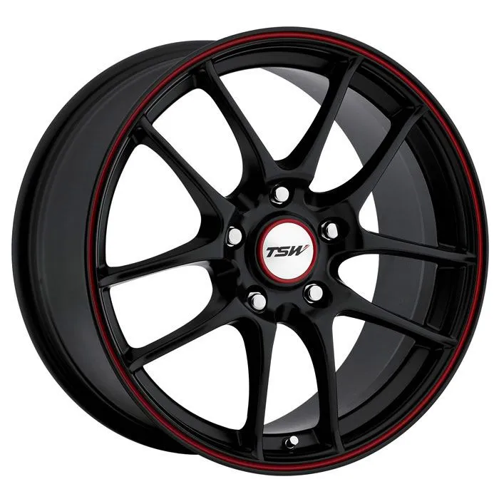

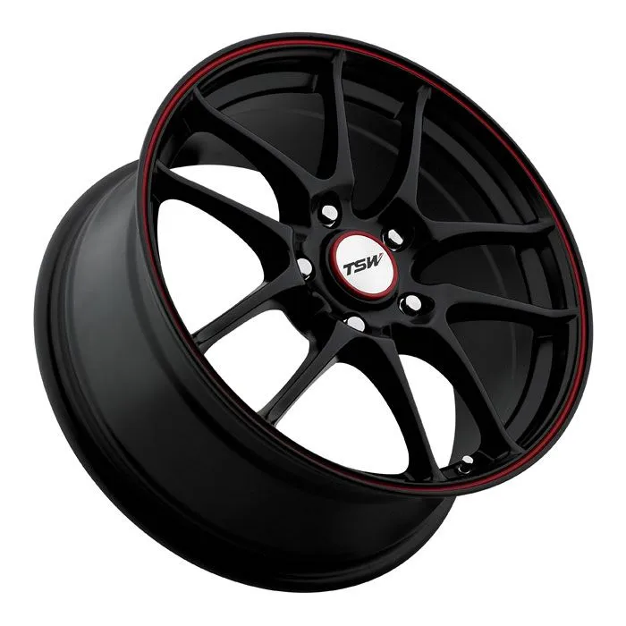

ok , so forget about volk, placing an order for those wheels is hard work , you basically have to beg for them to sell you a set and it takes about 6-7 weeks for the shipment to come to usa.. well i just ordered a set of
Tsw 18x8 +50 5.114.3 ,20 lbs each ..

Rota makes a wheel identical to that called the Circuit 10. It's actually a copy of the Mugen MF-10, a super-expensive JDM wheel for Hondas.
i would say they are similar but not identical......... wow, i checked on those Mugen MF-10 WTF? they are really expensive. i wonder what they are made of......................(stoned)
Mugen is a high-end aftermarket company in JDM-land. It's similar to Nismo and TRD. I too question if their stuff really is THAT good.
