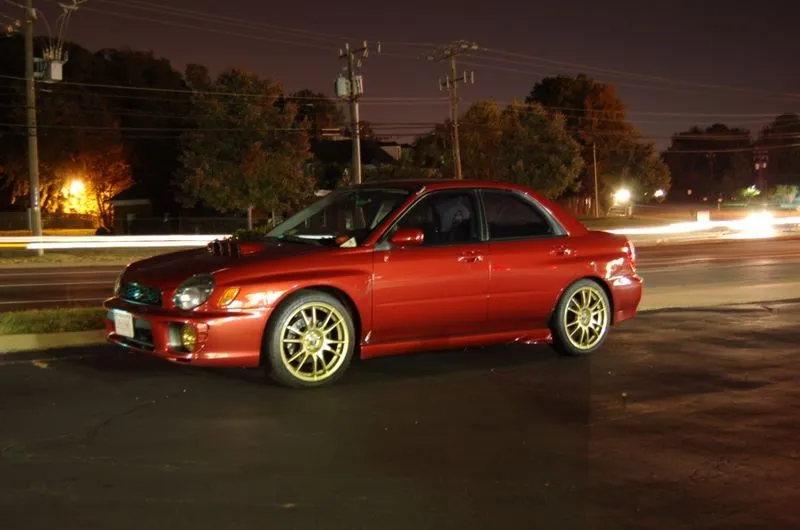

this was taken by someone at a local BP meet.

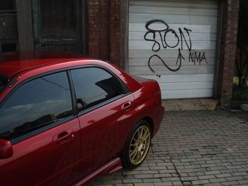

This is my friends 2.5 RS. It was taken last year when we all drove down and participated in the 06 Nopi Nationals in Atlanta, GA. Road down with the Super Street Tour and had a blast!
