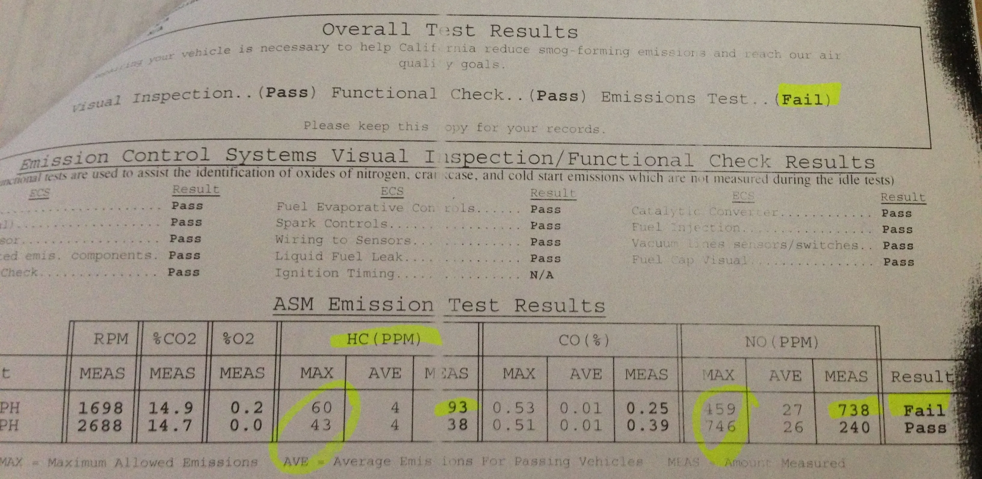

The only other problem which i dont know if its associated is the smog, it failed but not too bad, attatched is a picture of the results.
if anyone car shine some light on this as i am running out of ideas and been searching like crazy almost day and night. I've replaced and fixed almost every problem i have found and i frankly dont see anything else wrong and there are no codes being thrown. I also need advice as to why I'm not passing smog.
