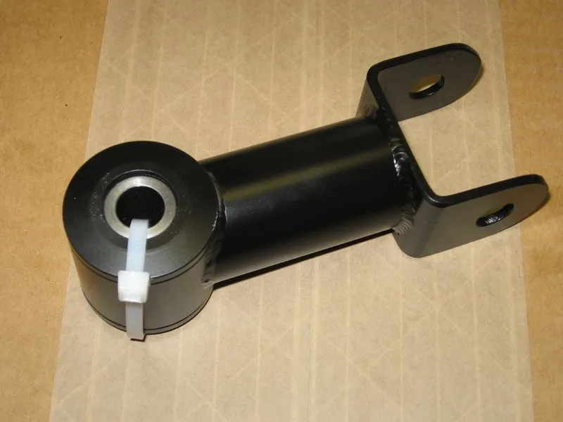

ProtegeGarage is proud to unveil its own competition motor mount for the Mazdaspeed3 and Mazda3. We're lucky enough to have Neil (tru boost) testing this mount for us and have him to thank for the R&D on it as well. This mount uses high quality chromemoly tubing typically reserved for race car chassis. Bushing tearing problems and potential strength issues from a two piece mount have been eliminated with this design. Stay tuned for more details in the coming days.

looks good!
hows it feel installed? any noticable differences?
yeah hows it feel in comparison to the awr 77(?)duro? is this pretty much a track only type of piece?
i'll let neil chime in here on his experience with it when he can. i spoke with the fabricator today and he's sending a revised unit out with further improvements.

as soon as i get donor mounts we'll make some
sorry for the delay fellas.
the mount is "almost solid". the bushings used are a special hardened plastic rather than poly or rubber. the is definately noticable vibration, but its a small price to pay to know it WILL NOT BREAK ! testing of this mount will be complete at the end of this week. we will then be testin a similar version but it WILL use polyurethane. due to the problems with some current mounts, we do not know how well the poly will hold up. if we get it right it should offer similar firmness but a smoother ride, when compared to the solid version.
i have had the solid one on my car for about three weeks now, and it 100% does its job. some of the "softer" fellas out there will not like the ride feel, but most performance minded people will know that a good solid driveline is going to vibrate. honestly its not too bad though. it is only rough when first starting off at low rpm. once you are going you hardly feel it.

the rear mount is often called the "torque mount"
it is the mount that takes all the abuse. when that mount is made sloppy "like stock" the other mounts get flexed and twisted. once the torque mount is secured power it transfered to the wheels and not through mounts.
i'm sure other mounts would help some...... but the lower will yield the best improvement.
the solid mounts shipped and should be in the testing phase by our few helpfull guinea pigs !! i will be recieving a batch of poly mounts on sun 7-1.
i will test it personally for a few days. if it meets my expectations (doesnt tear the bushing) i will ship out the rest of the testers at the end of the week
