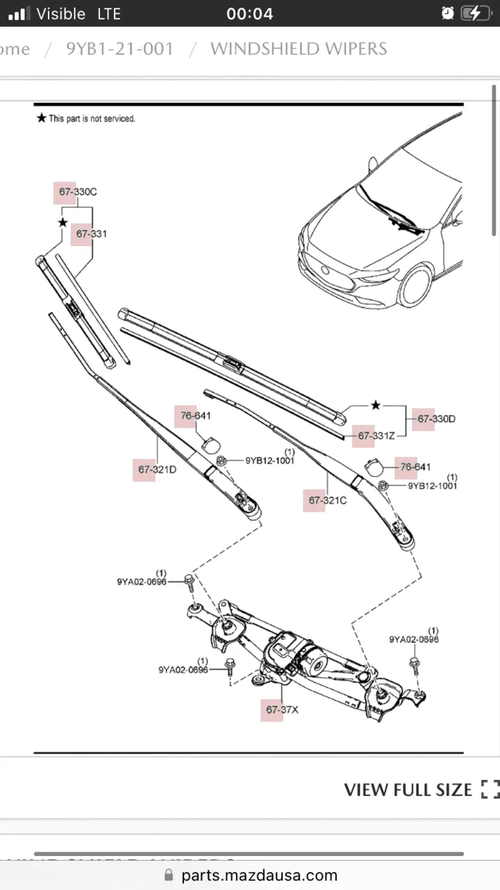

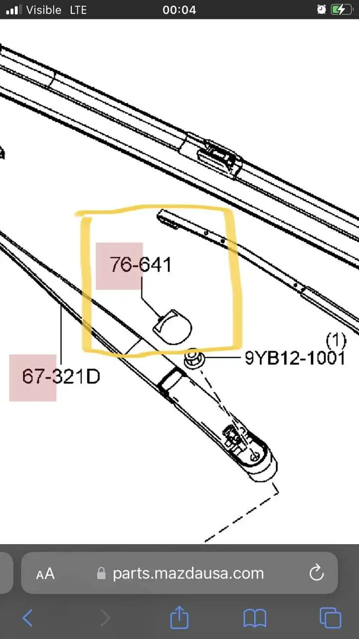

One more thing. Where is everyone buying their mazda parts? I need this cover for the wiper arm nut. Also I’m going to need the key fob logo as they shattered as I tried to pry them from the old fobs. I was wondering if I can get them there too.
Personally, I use mazda-parts.com for parts and fitment lookup, and then I search it on eBay, amazon, Aliexpress and such.
Most of such bibs and bobs I sourced at local pick-n-pulls.
So, the wiper arm cap can be found here (scroll down and expand to confirm fitment) and, for example, can be purchased here or https://www.amazon.com (commissions earned).
