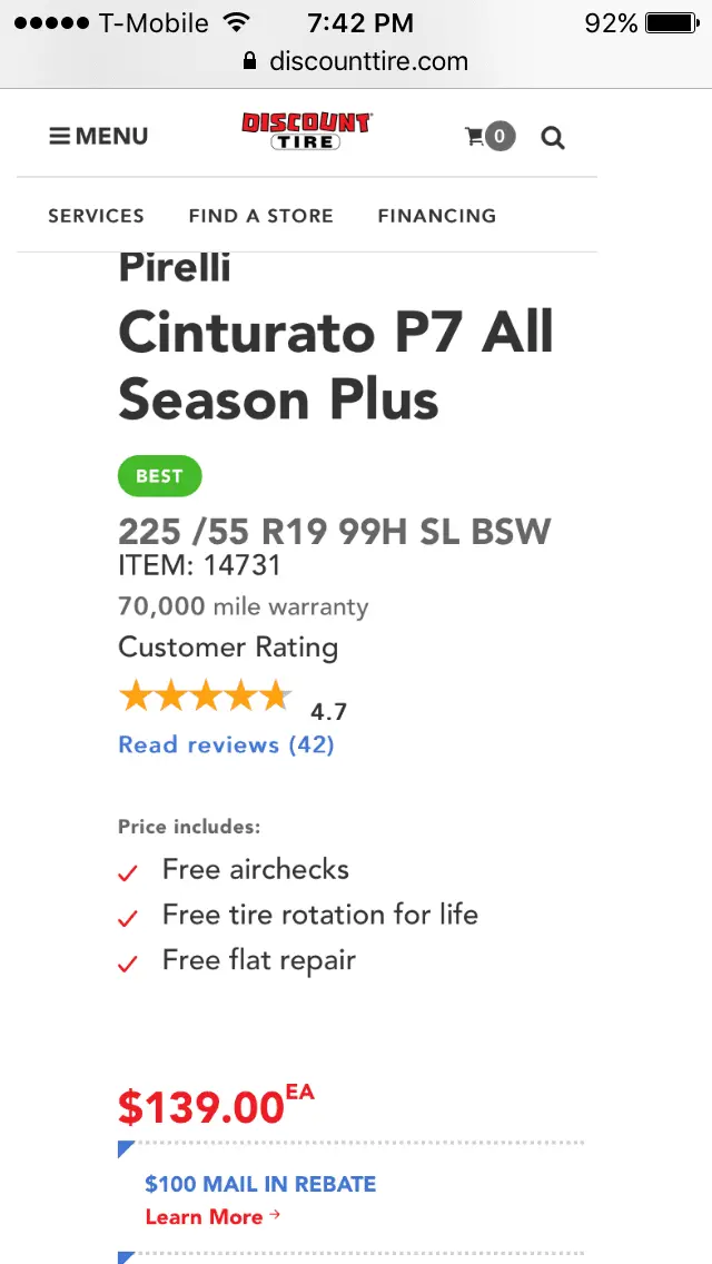

So, the Pirelli P7 is $154/tire. Pirelli is offering $70 rebate if I buy 4 and Discount Tire is offering $100 rebate on top of that. After all that, the Pirellis cost less than GT RT43. Looks like the Pirellis are similarly rated for comfort and performance, but outlasts GT. So,Ive decided to go with the P7. Will get those installed tomorrow.
$154 per tire on Pirelli Cinturato P7 All Season Plus 225/55R19 after all rebates, which is cheaper than General AltiMAX RT43, definitely is a better choice. Please report back your initial impression after you have P7 installed.
Checked DT Direct website the regular price is $139 each on detailed page although on list of 225/55R19 tires it says $154. DT offers Memorial Day Tire and Wheel Deals with $100 Prepaid Mastercard on 4 Best rated tires which includes Pirelli Cinturato P7™ AS+. But currently Pirelli offers $70 Prepaid Mastercard Card only on Pirelli P Zero or Scorpion tires, not Cinturato P7.
Remember the price on local Discount Tire Store is the same as online store Discount Tire Direct. You should ask your local DT matching the online price $139 before $100 rebate with the screen shot as the proof. You're not going to get Pirelli $70 rebate as promised.
No matter, any people need a new set of 225/55R19 tires should take advantage of this special offer by DT (5/25~5/28) getting Pirelli Cinturato P7™ AS+ with such a low price!
attachment.php
This is awesome. Thank you! Will try this tomorrow and report back.
