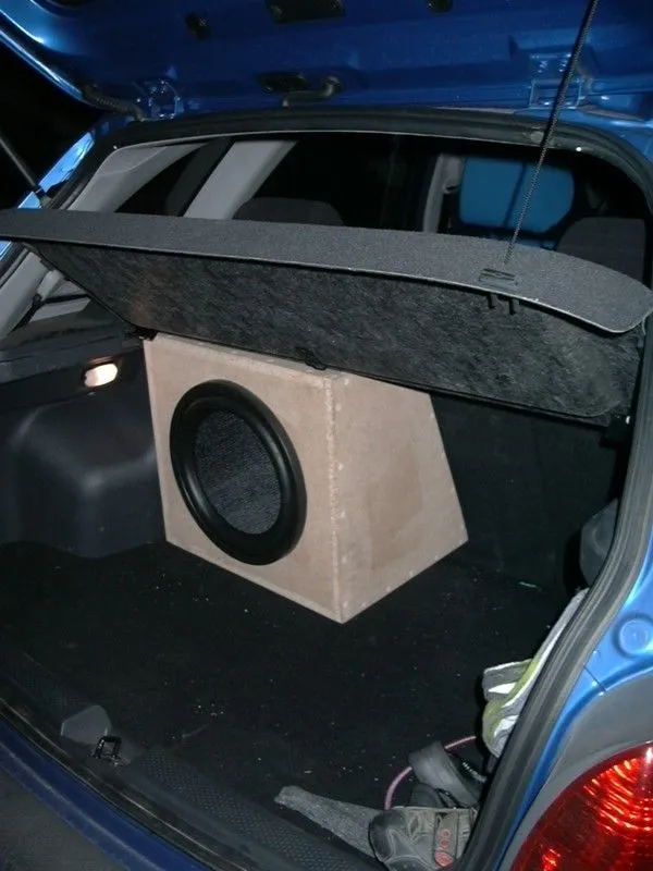

I've got nearly that exact setup. LOVE the sub. sounds very nice, mixes perfectly with my infinitys, and then hits HARD.. the guys at edesigns will actually recommend close to 1.2 (atleast 1.0) As far as SQ, small sealed boxes are all about SQ. Bigger and ported ones get boomier and less accurate. The O series is designed to be their SQ woofer, and I doubt they'd let you down for thump, but ideally they need relatively large boxes (1.6ish?) Either way, keep in mind that their box sizes are for volume MINUS speaker displacement (which is a little over .1cuf if I remember correctly) I'll tack a pic of mine on. My box as per Ben's opinion is of the same volume of ED's reccomended 1.2cuf box (works out to be 1.3something) it tucks in pretty nicely. I made my box to fit in with the slope of my rear seat, and be as space-efficent as possible. Fits nice, just not finished 'cause I'm lazy.
Power-wise, I've got one of the closeout Tsunami 1100's pushing it. I broke the sub in at 4ohm setting which is 350w and then switched it over to 1ohm for 1000+ after a week. First off that week at 350 was impressive. I've had every form of kicker solobaric12 made (and a couple of comps) all with about 3-400w. Let me say that the ed blew my mind. Couldn't wait to switch it over and feel it really hit. I did, and didn't notice as big of a diff as I'd expected, but it's still rocked my standards. (granted I'm a bit timid to crank the gain up all the way as I've got toomuch power on tap so it remains at about 75%) I'd say that evne with 500w flowing to that puppy, it'll please you. I don't think throwing a bunhc more power at it'll give you a bunch more sound, but I could be wrong. Actually for my liking I'm thinking I'da been entirely satisfied with a 10a. the 12 is much more than I'll ever need and I only really crank it to pop my friends' eardrums and generally be obnoxious. After hearing it, and how hugely powerful it is, were I to do it again, I'd go with the 10 simply for the space savings. a box HALF the size would be awesome. Also, 10's are supposed to be musically a bit better matched to a car's environment as far as SQ is concerned as well (less size/quicker to respond)
Now, as for your power draw. It is quite a bit of power. Fortunately the T class amp you're looking at will draw less current than an A. I just mentioned this elsewhere, I've done nothing to beef up my electrical system yet. I've got a digital voltimeter readout mounted under my deck that's hooked up to my powerblock, and I've found that my normal engine-on voltage (regardless of lights, etc) is around 15.7 and resting voltage (just battery no engine running) is 13.5. The LOWEST I've gottne it to drop is down to 13.0v listening to extended rolling bass. From as far as I'm aware this is not yet posing a threat to anything. I am however planning on getting some form of cap setup (likely 2faradish) mostly just to try and keep things a bit more stable. I do get a fair amount of headlight dimming, which some ppl say will be aided by bigger grounding and alternater wires. Some say it doesn't do squat. Either way, it's not a bad idea and I'll do it eventually anyway. Grounding kits are all the rage for hop-up performance gain kinda stuff.

Umm, well look at the power rating for the box they recommend, and it's 1000. I'm really not too sure, perhaps if you run in a smaller box you can push more, but I'm just content to leave my amp dialed back a bit. It's not like you HAVE to run full power. I've been getting by fine. Granted it is a bit tricky trying to get tme most out of it and not over-juice the speaker (hard to know when it's gonna blow) Give ED a call, and talk to them. They're SUPER knowledgeable guys. Also check out the ED thread on whatever audio forum it is. (they've got a link to it on their website) Lots of knowledgeable ppl in there.
That setup sounds pretty good. I've honestly got no REAL idea if the 10 will be as good, but one can only assume... Like I said, mine's byfar WAY toomuch. I leave my sub-out setting on my deck pretty low most of the time. One good thing... I noticed you're running a factory deck, hence no sub-out control on the deck. That 1100 comes with a remote gain, so you've got a good use for it. Hook it up, You'll very likely use it alot. with thatmuch power on tap, you can't stomach it very well most of the time if you're driving any kind of distance, but then of course you've got to abuse it every now and then.
you can go with a really long but narrow box like mine and yo will still have lots of trunk space
