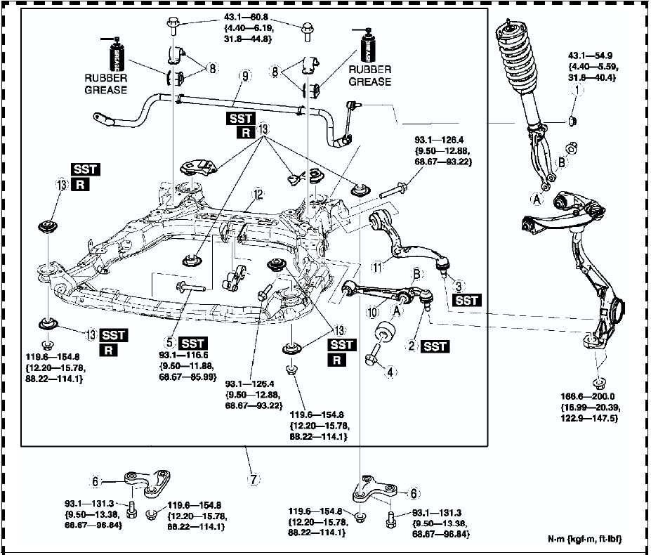

Loosening the front sub-frame mounts and dropping the rear mounts will probably give you enough room to lower the rear of the subframe and undo the sway bar brackets and slide the bar out the end.​
Mazda 6 Service Manual: Front crossmember removal/installation​
Mazda 6 Service Manual / Suspension / Front suspension / Front crossmember removal/installation
1. Remove the under cover.
2. Remove the splash shield.
3. Remove the front auto leveling sensor. (See FRONT AUTO LEVELING SENSOR REMOVAL/INSTALLATION.)
4. Remove the transverse member. (See TRANSVERSE MEMBER REMOVAL/INSTALLATION.)
5. Remove the steering gear and linkage, and pipe assembly installation bolts from the front crossmember, then suspend the steering gear and linkage with a cable.
Tightening torque
Steering gear and linkage: 74.4-104.8 N·m {7.857-10.68 kgf·m, 54.88-77.29 ft·lbf}
Pipe assembly: 7.8-10.8 N·m {79.6-110.0 kgf·cm, 69.1-95.5 in·lbf}
6. Remove in the order indicated in the table.
7. Install in the reverse order of removal.
8. Adjust the headlight zeroset. (See HEADLIGHT ZEROSET.)
9. Inspect the front wheel alignment. (See FRONT WHEEL ALIGNMENT.)

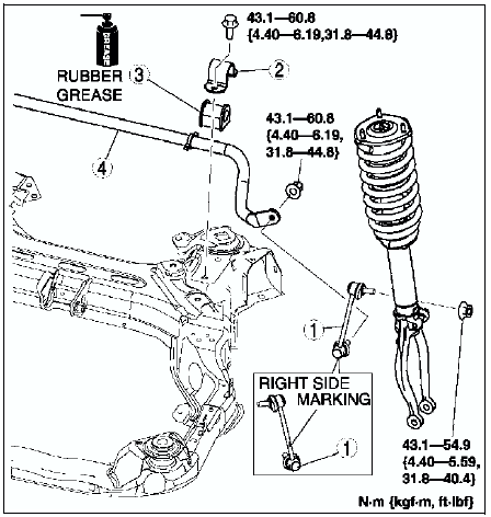

Mazda 6 Service Manual: Front stabilizer removal/installation​
Mazda 6 Service Manual / Suspension / Front suspension / Front stabilizer removal/installation
1. Remove the front crossmember component. (See FRONT CROSSMEMBER REMOVAL/INSTALLATION.)
2. Remove in the order indicated in the table.
3. Install in the reverse order of removal.
4. Adjust the headlight zeroset. (See HEADLIGHT ZEROSET.)
5. Inspect the front wheel alignment. (See FRONT WHEEL ALIGNMENT.)

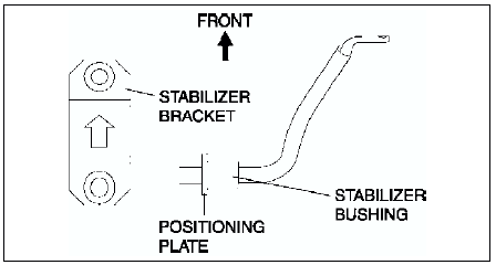

Stabilizer Bracket Installation Note
1. Apply rubber grease to the inside surface of the stabilizer bushing.
2. Align the bushing with the inside of positioning plate on the stabilizer bar.
3. Install the stabilizer bracket.
