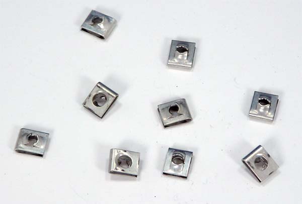

i grabbed some from the junkyard.
although i lost one so i used one of those speaker clips that come with car speakers. i bent it back into an L shape, screwed it in, and it holds it in pretty firmly
they look like this
Wow.. awesome guys! Thanks for all the replies! I am going to give some of these a try and see which one sticks.
