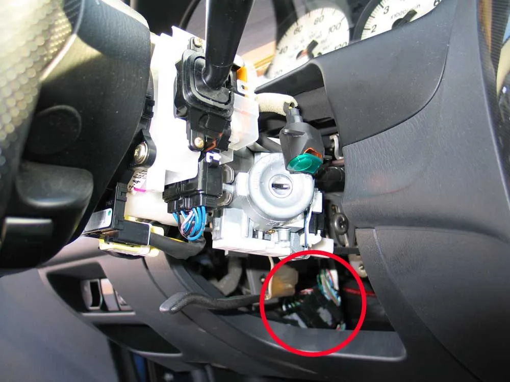

hey i'm almost doen putting in my alarm in my msp, but i can't find the door trigger wire or the parking lights wire in the driver's kick panel... any help?

I just did my remote starter, so I know that the parking light wire is light green with black stripe.
It should be on the left side when you pull down the kick panel under the steering column. You can see the bunch of wires goind into a harness.
I didn't do the door trigger, so I don't know. Well, at least i've solved 50% of your problem :)
BTW, I have a P5, but they should be the same.
Unscrew the trigger switch on the drivers side door with one phillips screw and VOILA ! youll see your trigger wire !
I'm not sure if its blue or blue w/ black stripe.
hope this helps
Oh, I suddenly remembered that the door trigger wire = dome light wire.
Yes, it's blue w/ black stripe.
I came across it, but I forgot where it was (again, i didn't use the dome light feature on my remote started), sorry. But I do remember it's under the dash. :)
