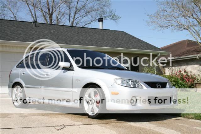

I'm on Tanabe DF210 springs w/ 17x7.5 +48; 215/40's and mine rubbed until I rolled the rear fenders.... Now no rub at all. I would say this is perfect because you get the most width, and sticks the furthest out you can go... without running lots of negative camber.
