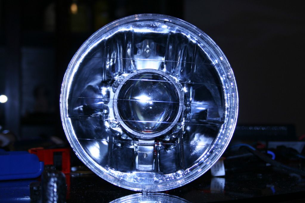

Once you think you've got it, slip the projector back in and place the plastic lens on. Should have a little clearance between the projectors lens and the housing lens

Now that the projectors are cured into the reflectors, time to apply the outer lens back on. Place the lens on pressing fairly firmly to get it seated then pop the assembly black in the oven at 200 for 10 minutes
Once hot press the lens on further verifying a complete seal.
Now, TADA you're done
