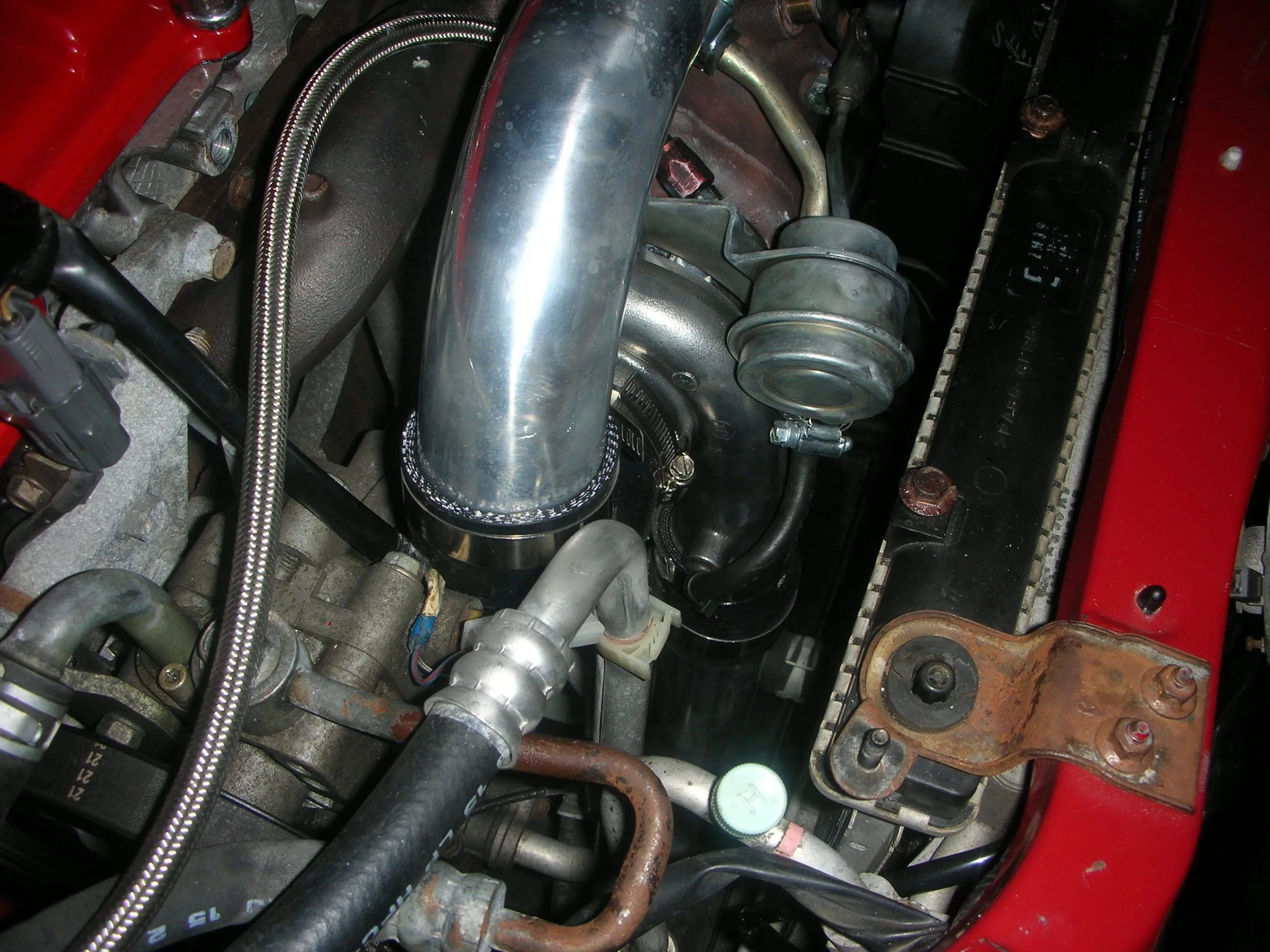

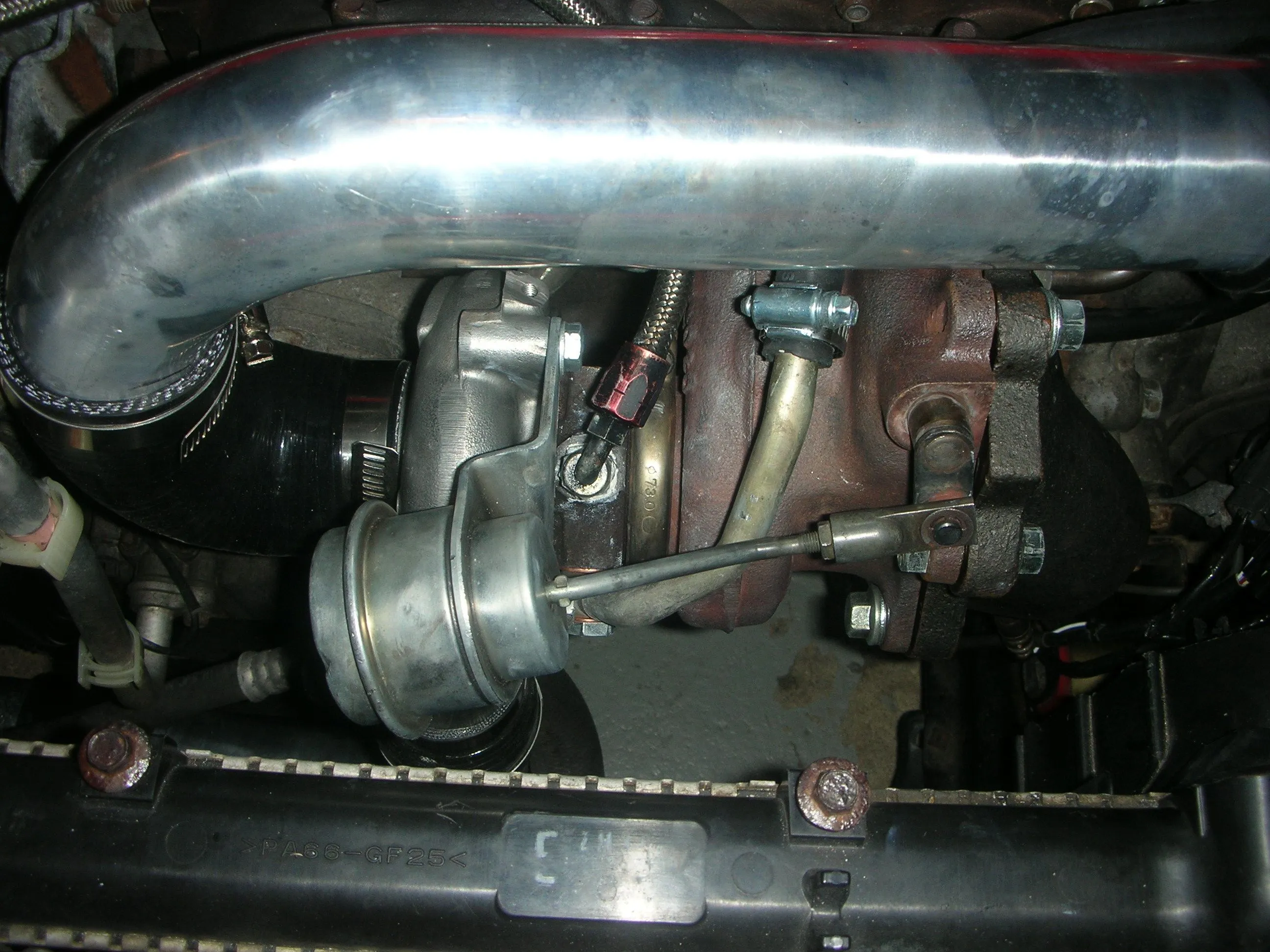

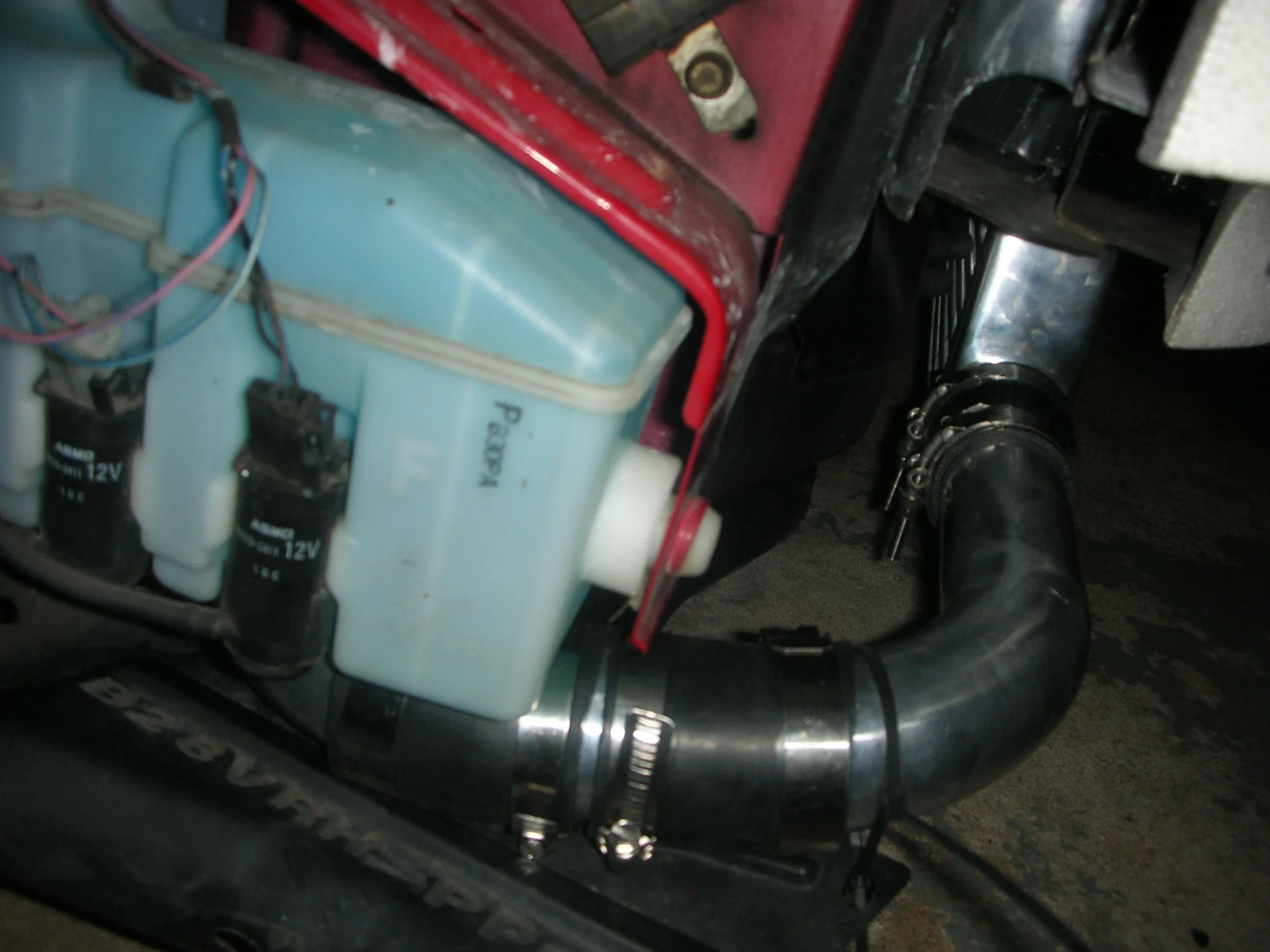

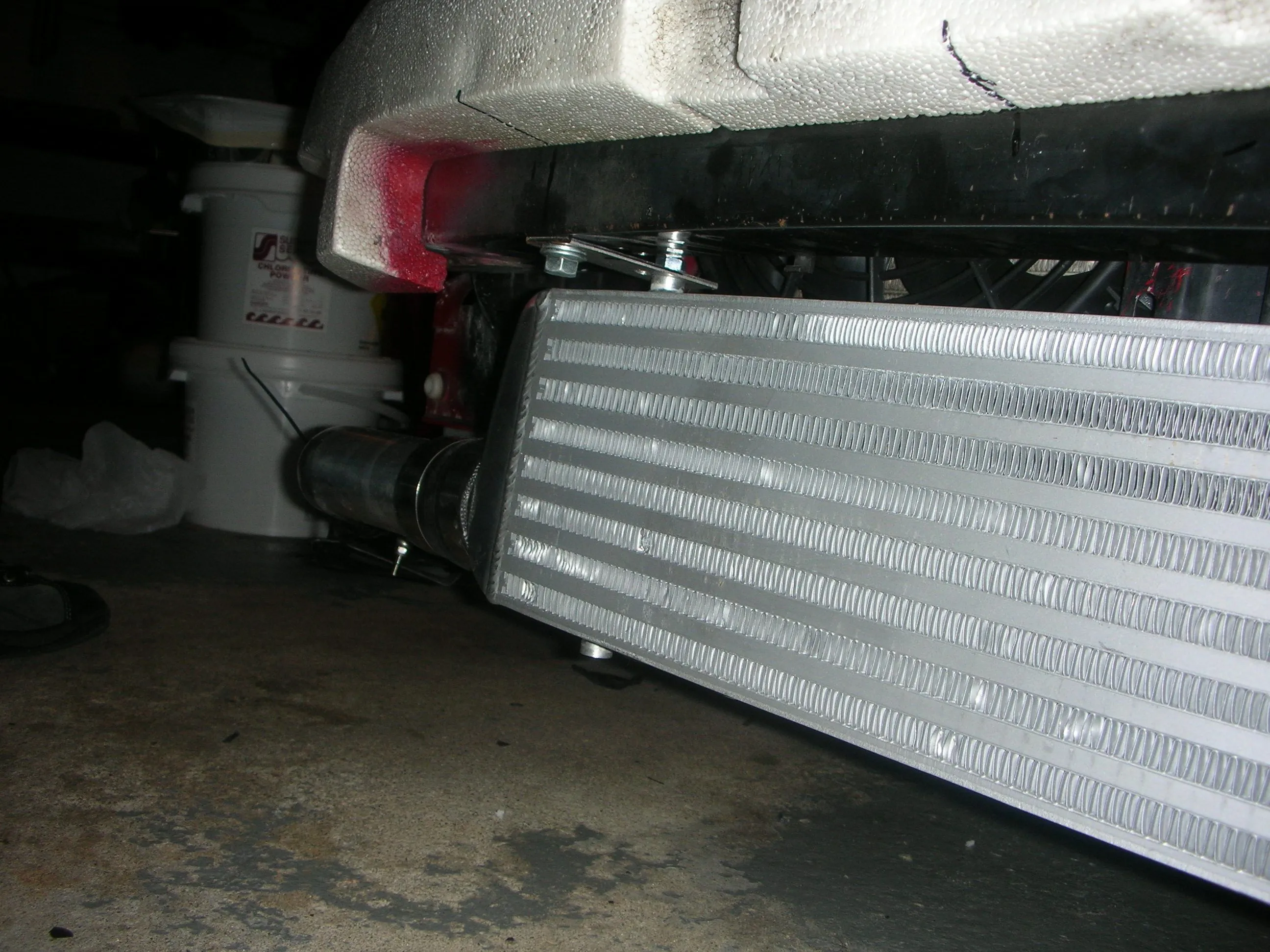

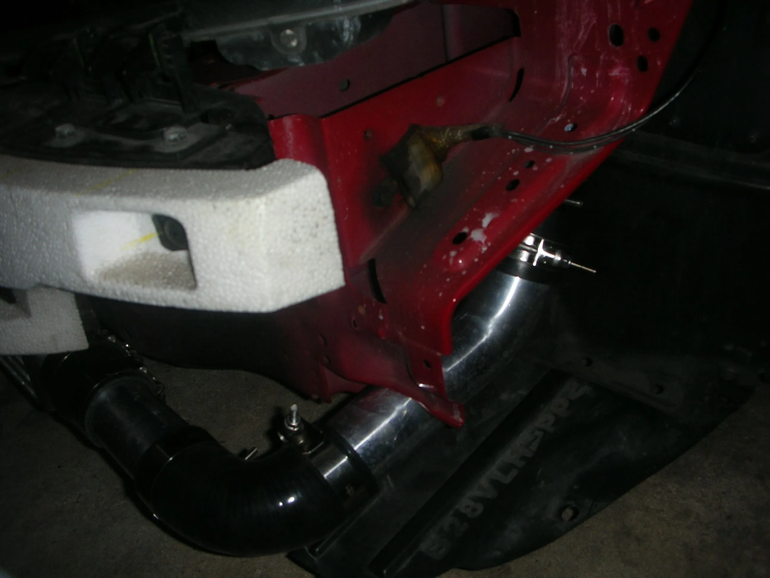

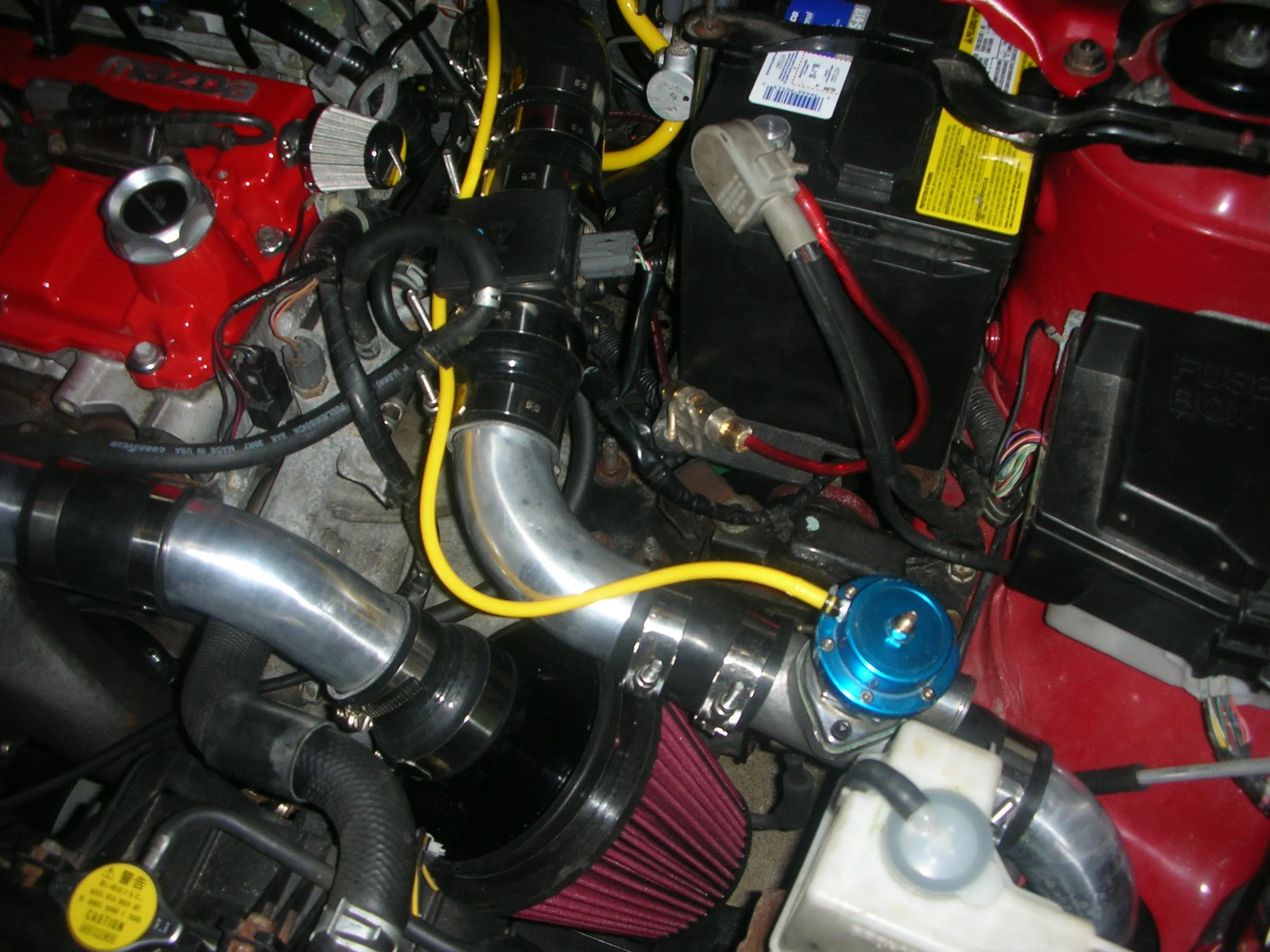

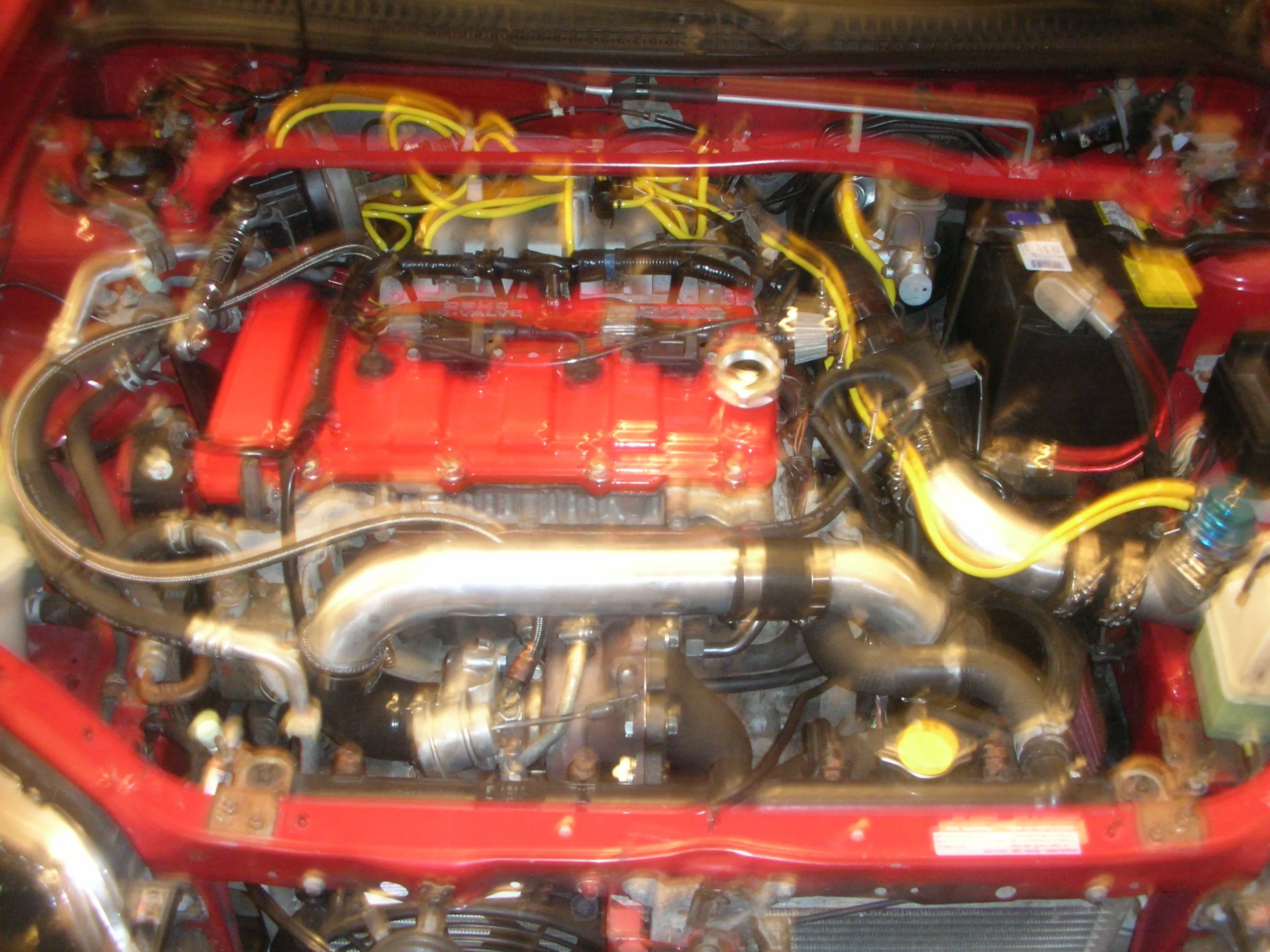

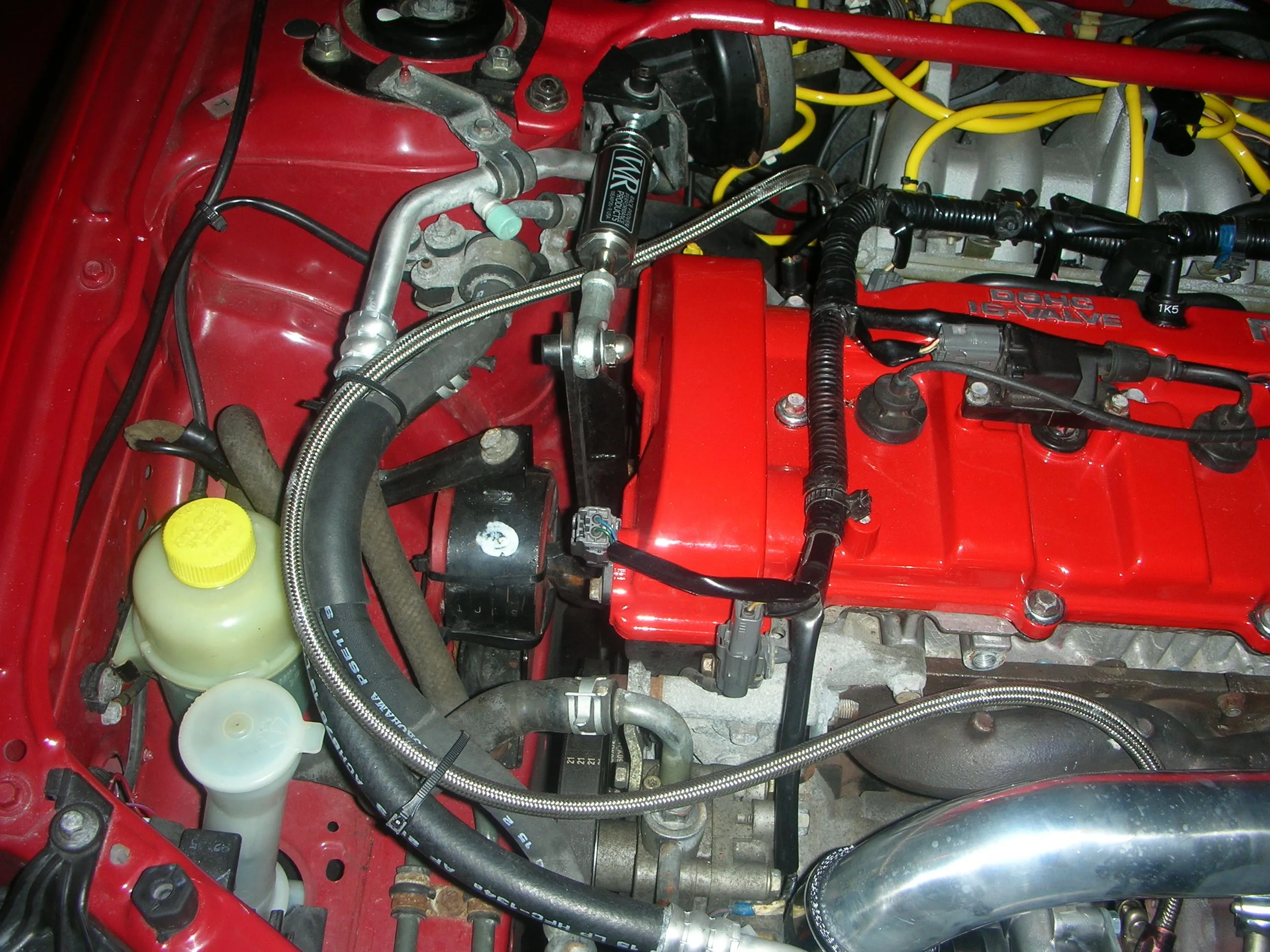

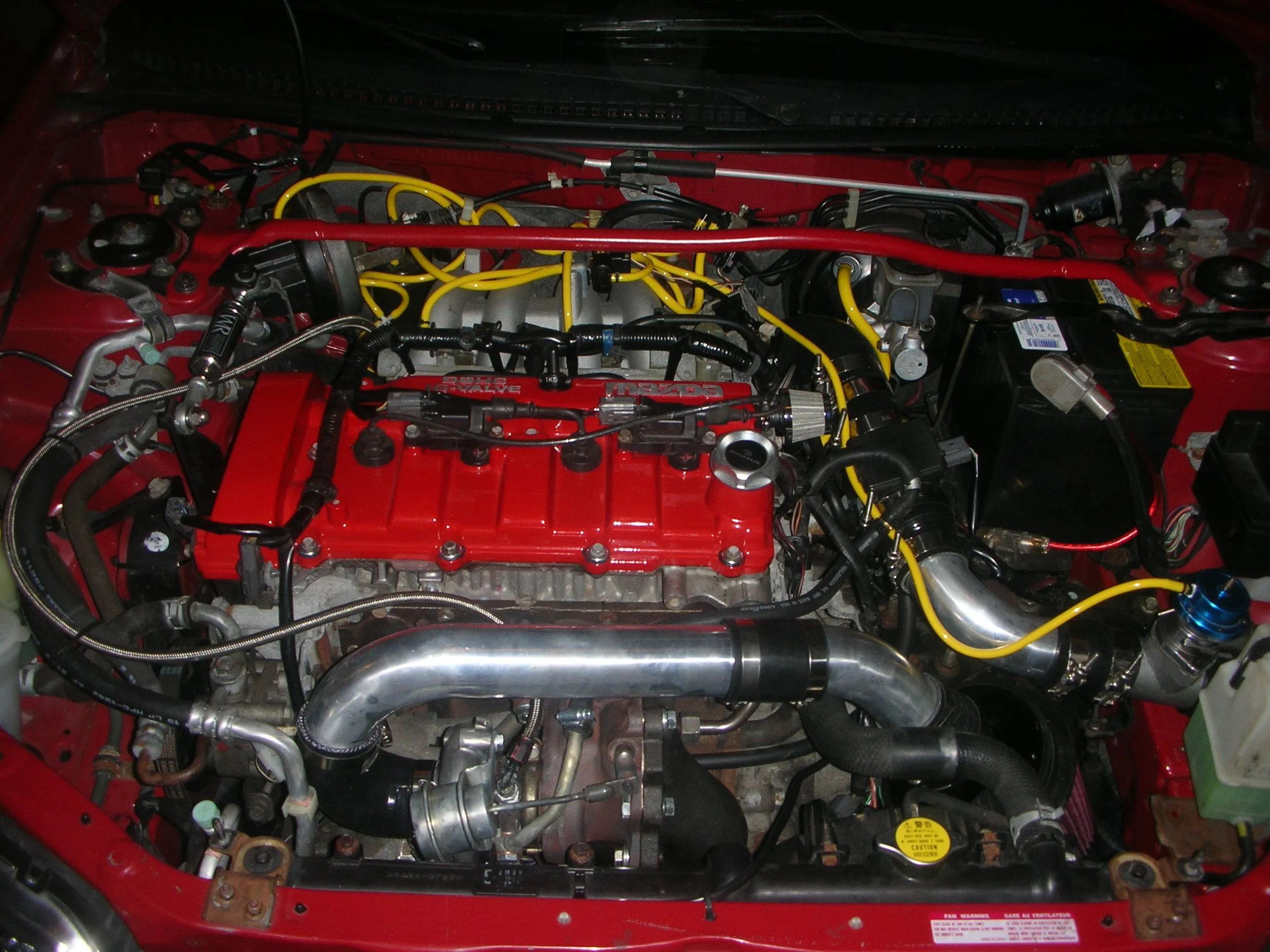

well, my custom turbo kit is complete. it was a b**** finding all the little parts. it took about 4 weeks to get everything together but everything finally worked out. here is the list of things i have purchased
hiboost manifold
hiboost s pipe
hiboost j pipe
wrx turbo (td04, water and oil cooled, wastegate is set to 7 psi, but hitting around 5-6 because of intercooler piping)
custom front mount intercooler set up
type s bov
msp ecu
splitsecond afc
custom oil lines
custom coolant lines
i have many other mods as well, but these are things that bought turbo related. i have the superstock map on there now, but it is running 10.0 afr's, so i have to retune. here are pics and videos.

yea thanks, i was running the superstock map on the msp ecu and my airfuel ratios were 10.0 threw out the hole rpm range. so im gonna have to take out a good amount of fuel. ill probably end up putting 9.3 in the cell ranges.

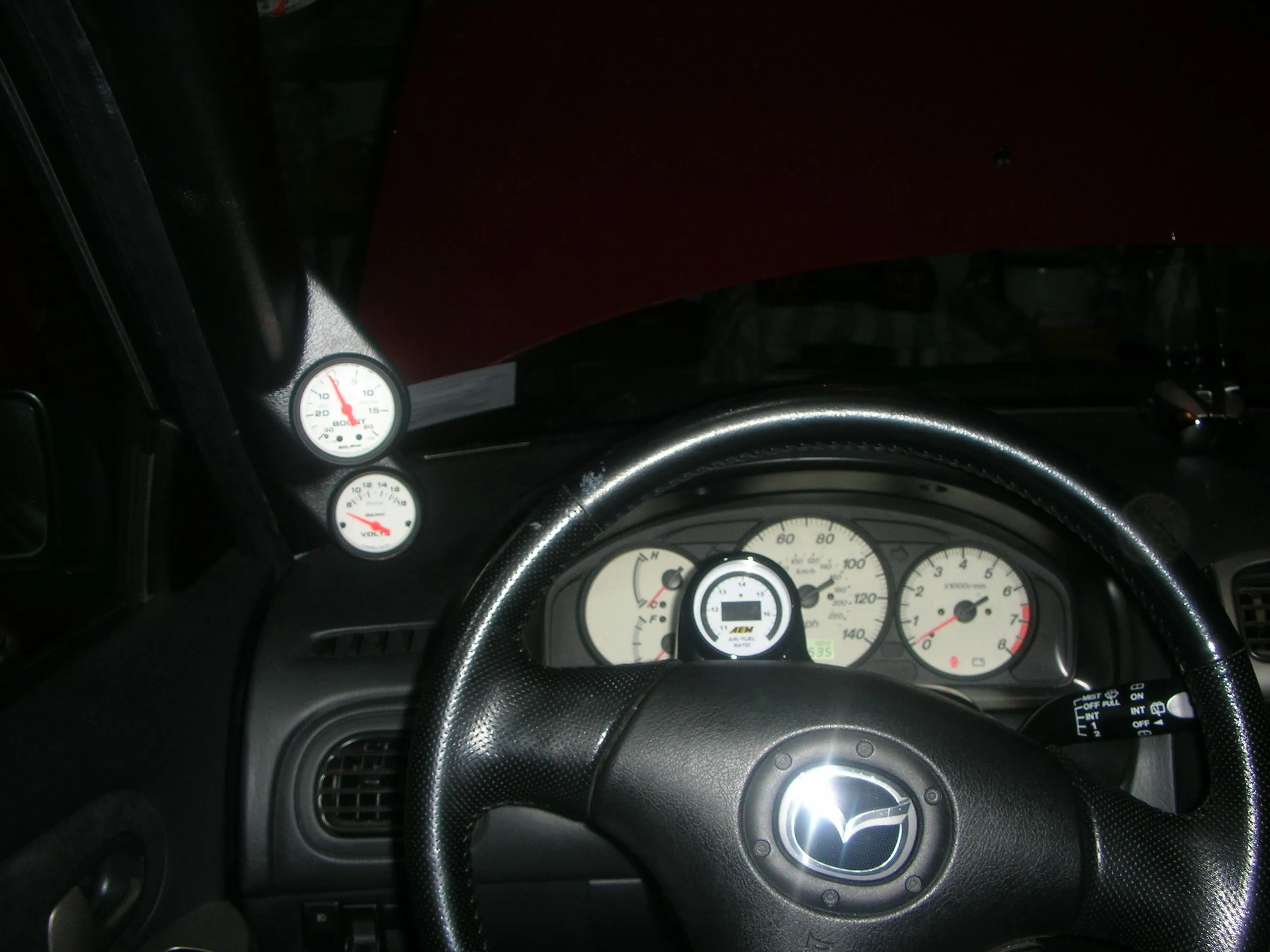

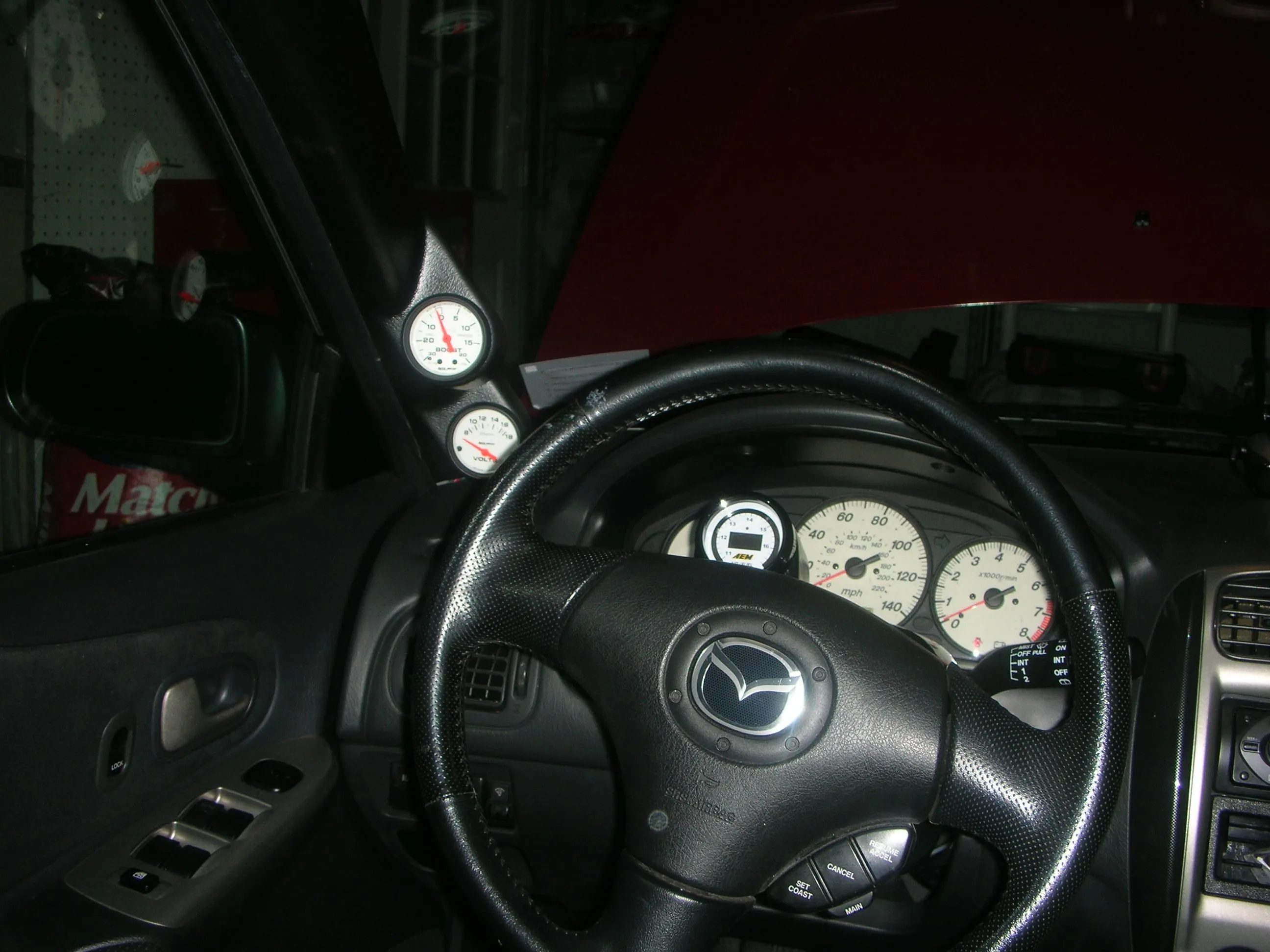

AEM wideband
Forcefed's steering column gauge pod
Autometer boost gauge Phantom Series
Autometer volt gauge Phantom Series
Full Dual gauge pod

the turbo set up was rather complicated since no one is running this turbo with the hiboost kit, so i had clock the turbo for my set up, but other than that, the build was pretty strait foward. the turbo came off a wrx and the internal wastegate as well. even though the wrx does about 14 psi stock, the wastegate is set to 7 psi, and their ecu has a built in boost controller.
